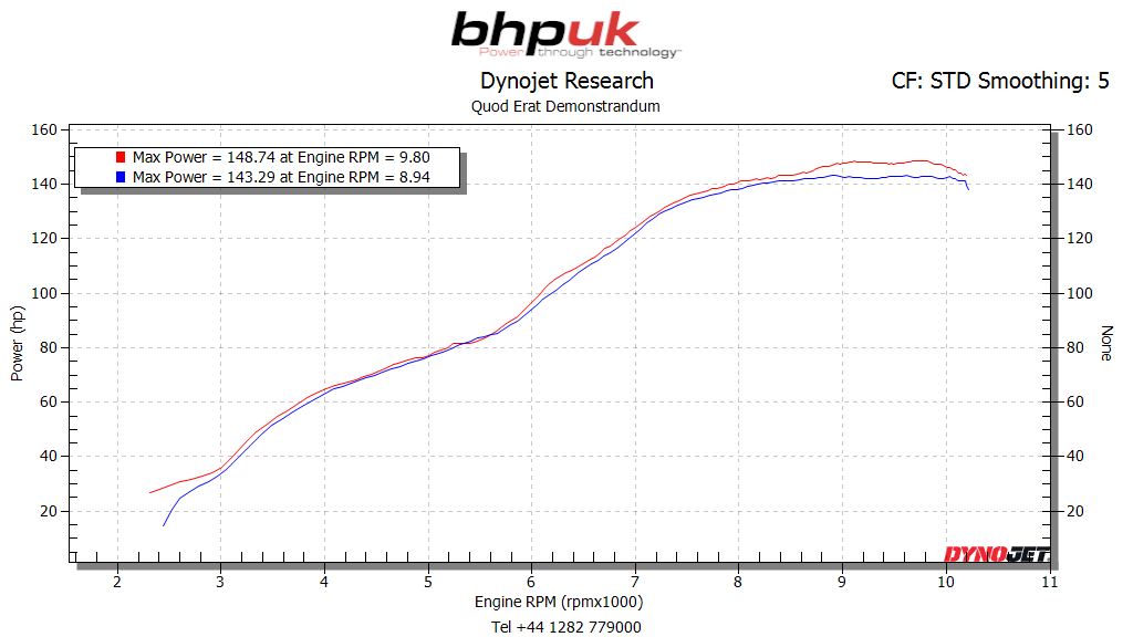

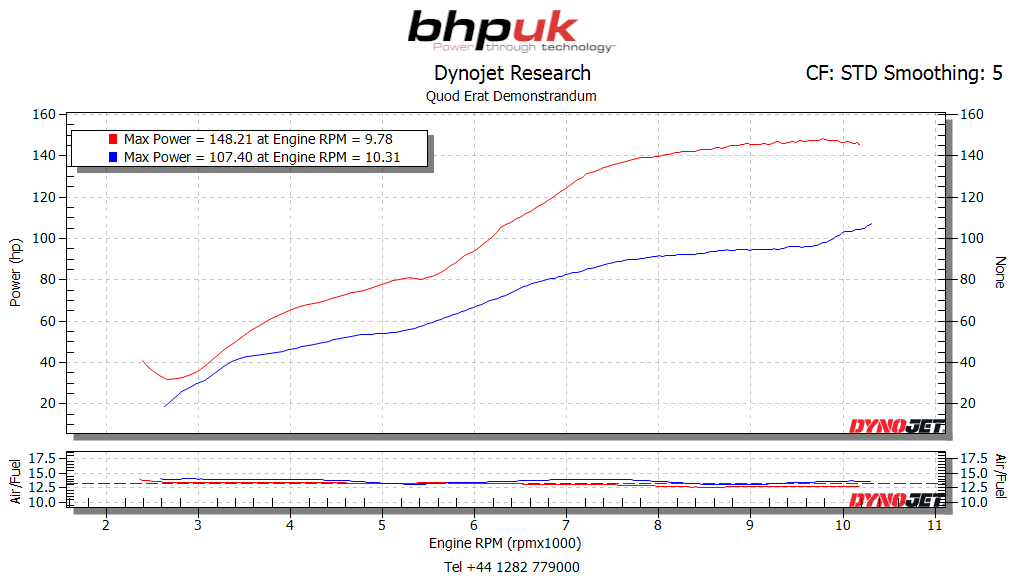

  6. I bought mine as a stock five your old bike with 5K on the clock, so fully run in and loosened up. I felt after having the Termi fitted that it had lost urgency in the midrange and gained a bit of power up top, which wasn't where I really wanted it, and then only at large throttle openings. I spoke to BHP-UK and they confirmed that the up-map had to be Euro 5 compliant and that meant leaning it out in the rev range and at throttle openings where the bike will be ridden most of the time, in order to reduce emissions over the lifetime of the bike. By correcting that it felt very noticeably more responsive and aggressive. It's also smoother and now pulls higher gears from lower revs. It will pull 6th from below 4000 rpm. I don't ride like that but tried it just to see how low it would go. Big difference from stock.
    The gains in raw figures aren't huge - though bear in mind that my remap was with the Termi already fitted, so represents gains over the Termi with approved map to Termi with custom map. Not stock pipe to remapped Termi.
    The benefit is in rideability, eagerness to rev and instantaneous response to small increases in throttle opening.

  9. Just had a Quick Look at BHP YouTube and can see a multi 1260 DVT remapping with a slip on Termi but not the decat full system Termi. Apparently There are some useful gains with the slip on in terms of riding smoothness and power delivery but the data shown compares the BHP tune to the standard Termi slip on pike peak performance not the 1260 pike peak with the full Termi system with Ducati upmap installed. I would be interested to see any data you have. Cheers
  10. As you'll see from the graphs, my Diavel is making 3 bhp more than the Pikes Peak Multi in the vid above, so in line with Ducati's claimed 165 bhp at the crank with the Termi system and up 5 bhp on the Termi with supplied up-map. But again, the headline figures aren't the real story. It's rideability, urgency and responsiveness.
  11. I really appreciate you posting this info, very helpful indeed! I am out of warranty so will investigate this further. Cheers
  12. Forgive my ignorance but can you tell me which map relates to which configuration, is the first map the full Termi with the Ducati upmap and the second plot with the air ratio plot the full Termi with custom map? If so what is the difference between the blue and red lines on each plot?
  13. TBH I'm not sure what the second one means. In the first the blue line is the Termi with the upload map and the red the custom map. I forgot to get him to talk me through it at the time as ot was getting late in the day and I had a longish drive home. I didn't look at the graphs till next day when I opened my emails. All I know it's a big win from the seat of the pants dyno.
