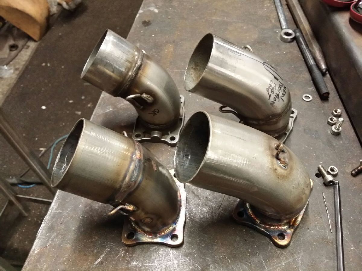

  12. Chad @rcv4 made me lovely copies of a pair of 57mm manifolds
  13. I think I just need the main front pipe, but I'll be seeing Chad this year to finalise my frame, would need a pattern one to copy though...
