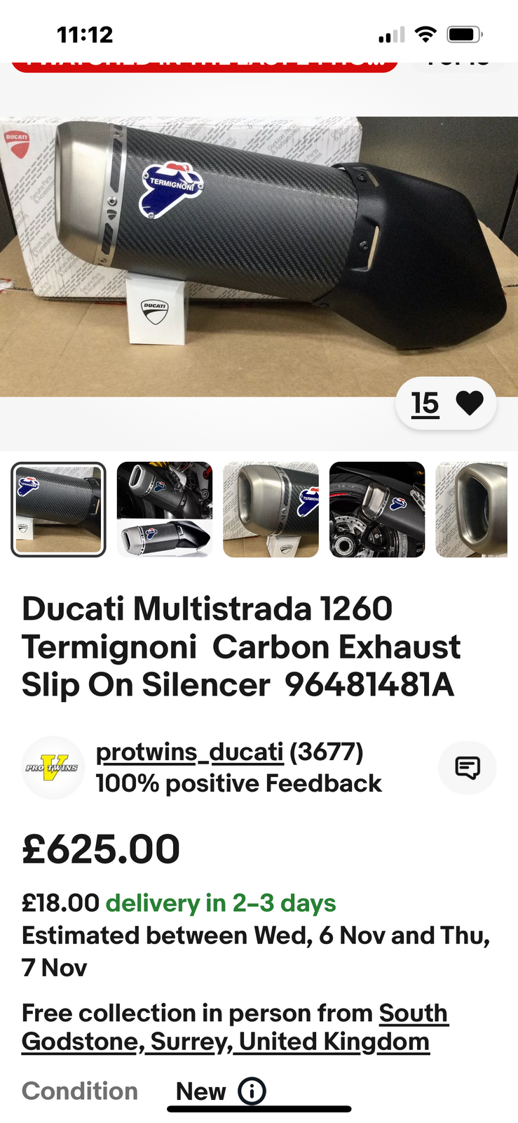

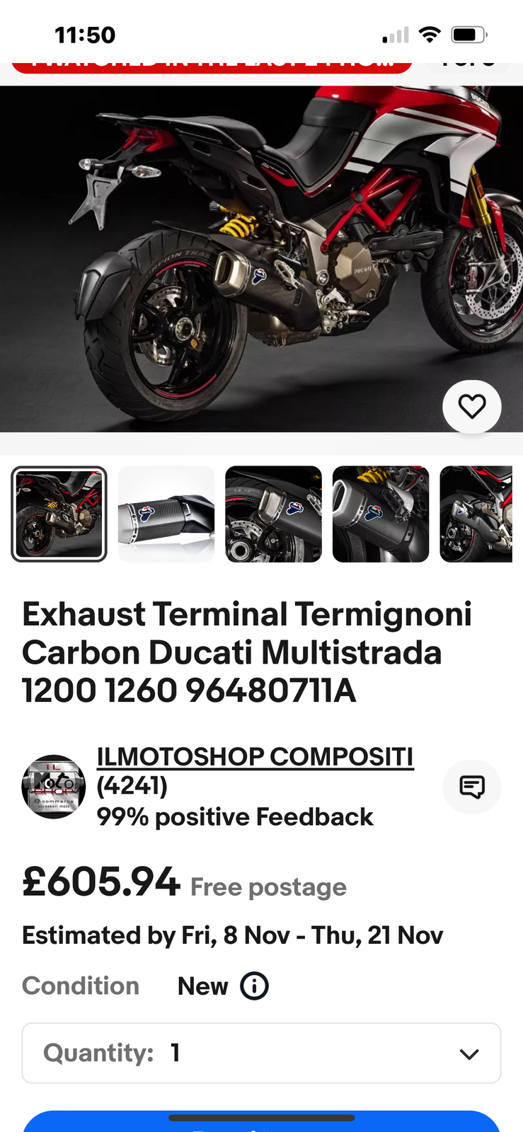

  1. Looking at getting a slip on for my 1260, ideally I’d go for an Akrapovic if money was no object, but unfortunately it’s not, so I’m going for a Termi, but I’m confused, different part numbers, but both look identical to me, same lengths etc
    Anyone have the answer ?
  2. The part number of the first one comes up as 1200 only, the part number for the second one is 1260 only. Andy

  4. The difference is possibly because of the heel plate fitted to the silncer itself.
    A Termi end can from a 2010+ Multi will also fit your cat box but the heel plate requires modding or you can buy a later DVT heel plate.
    I know this from taking off my 2010 Termi and modding the heel plate to fit my 1200 DVT '17 plate.

  6. Be aware that the vast majority, if not all, of the silencing is in the CAT which is retained. As the result don't expect a significantly more fruity exhaust note. OP changed post #1 so no longer relevant.
    Both of the Termi end cans shown should fit. First one is for the 1200, the other for the 1260, however, the fit is the same.
