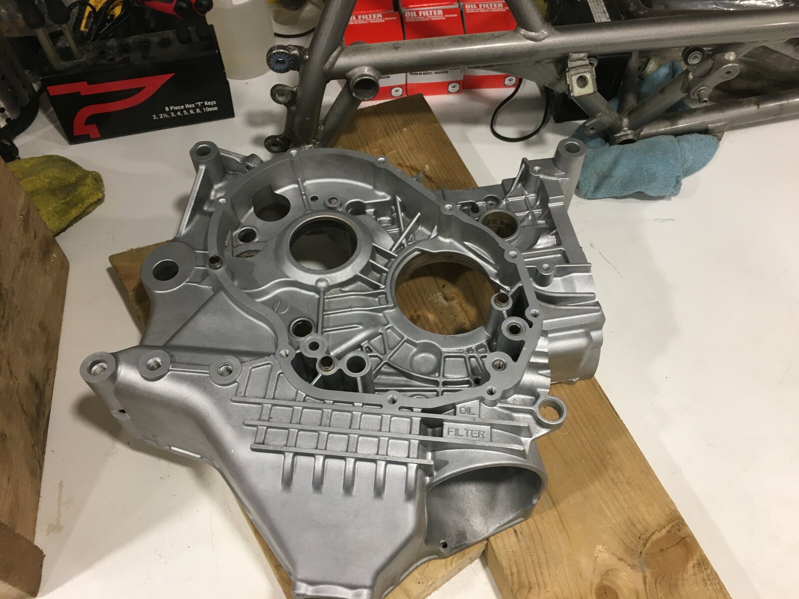

  1. I'm in the process of rebuilding a Testastretta 998/999 engine. I have all of the engine cases, heads, cylinders, etc. vapour blasted as they were all in a right state. However, the vapour blasting process has taken, what I assumed is/was, anodising off the spark plug tubes in the heads and off the static and tensioner wheels spindles.
    I know that this won't affect the running of the engine but it's triggering my OCD and I wonder if it's OK to remove them and have them recoated? The belt wheel spindles have flat edges for a spanner and I assume they are tightened in with thread lock. So presumably some heat and a bit of force will take care of them.

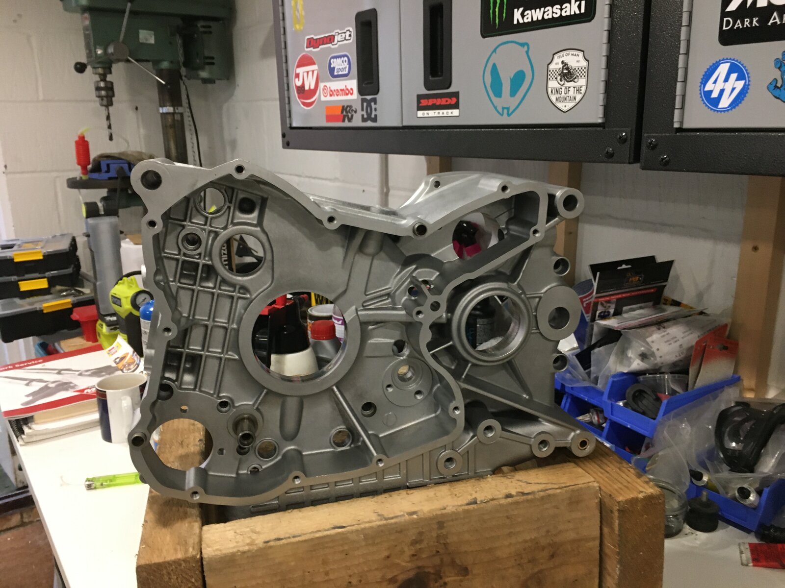

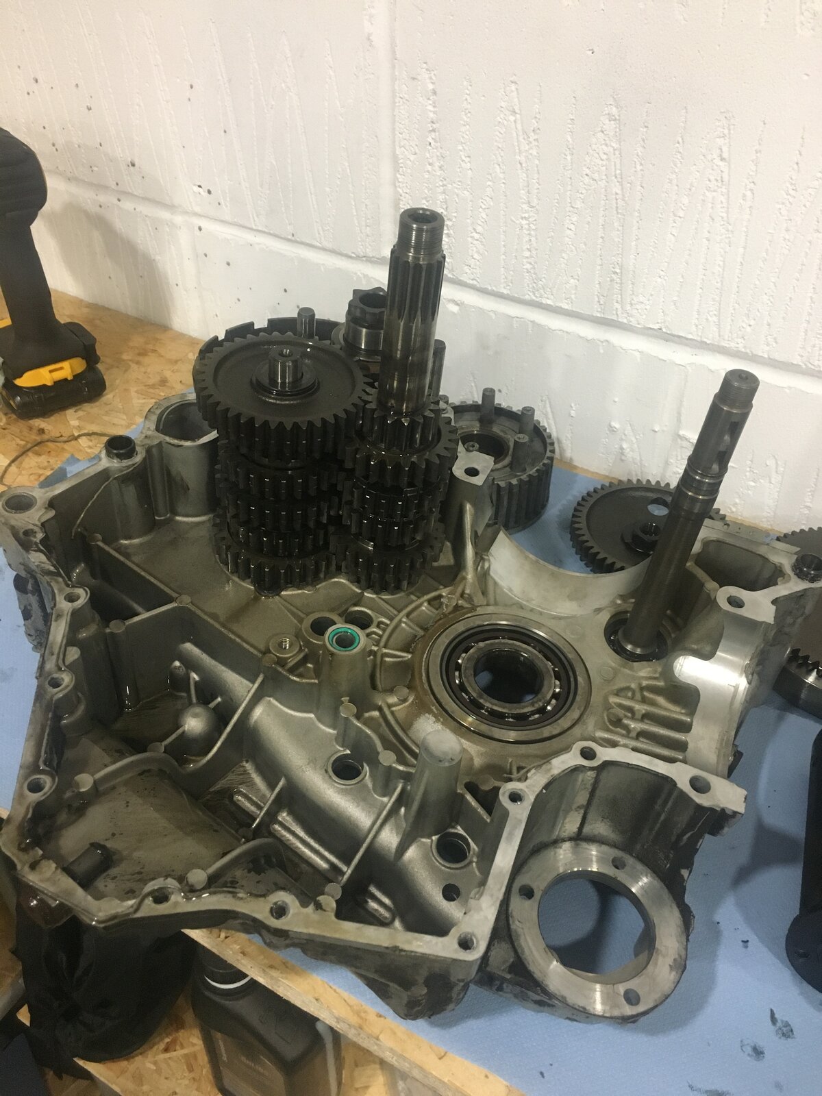

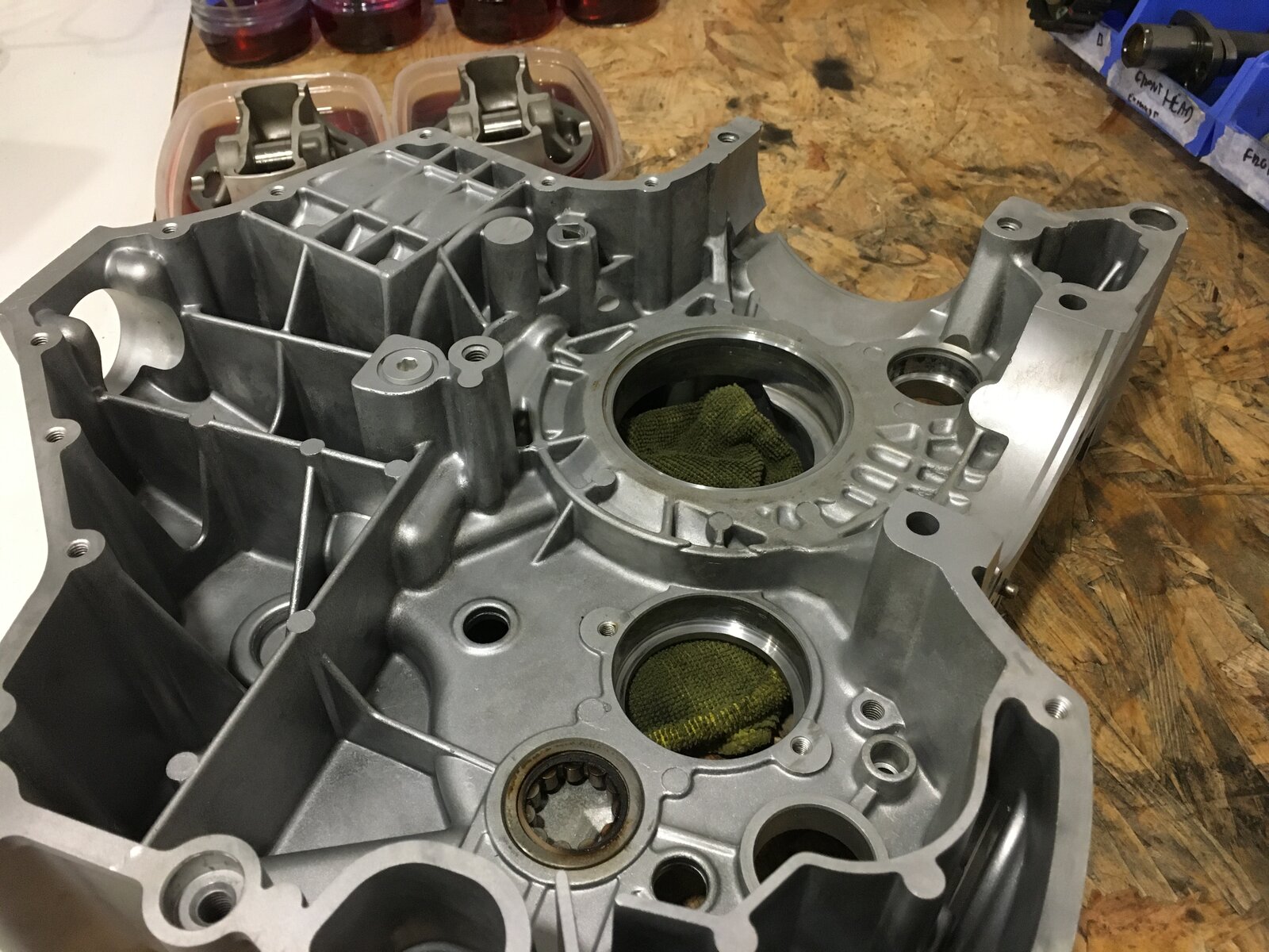

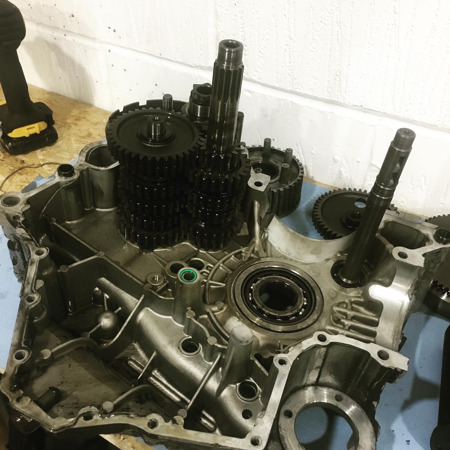

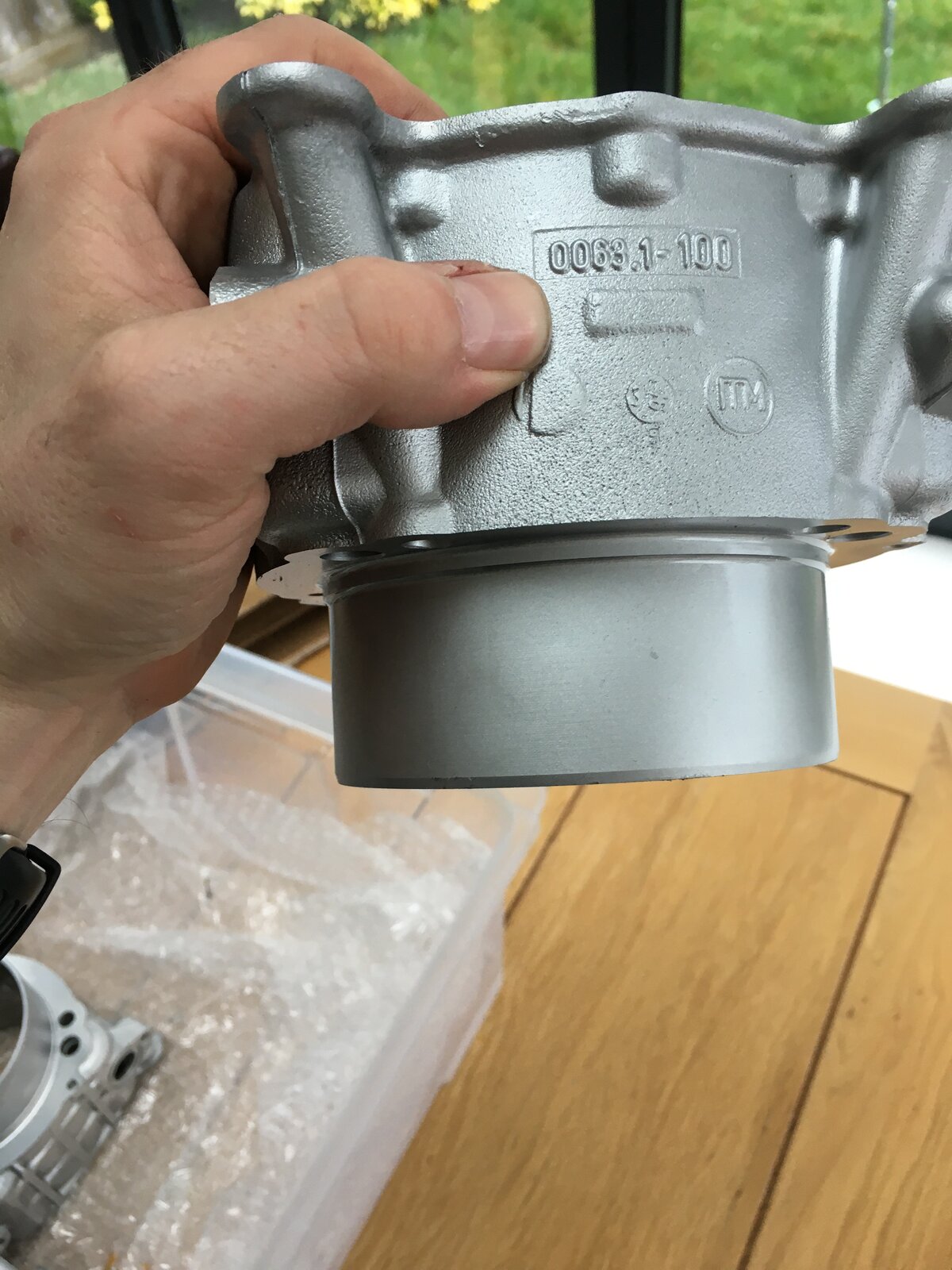

  4. Pics we like pics!

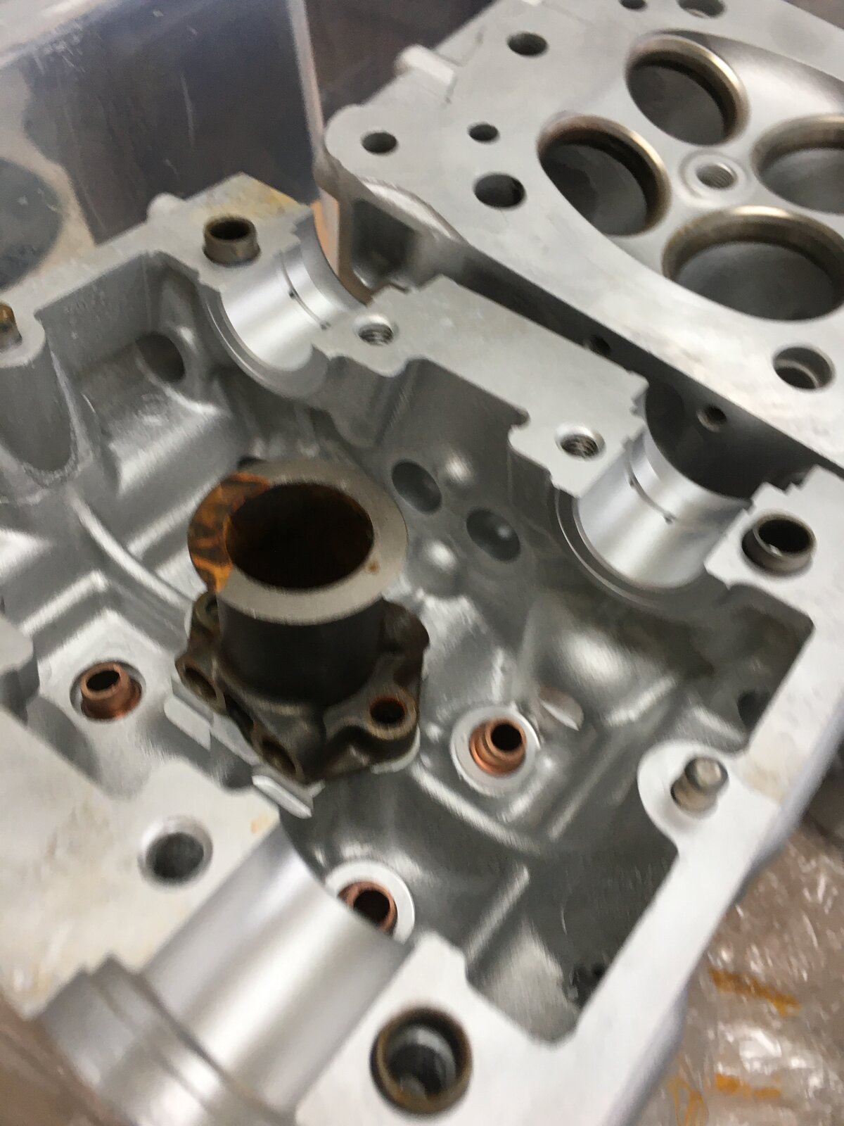

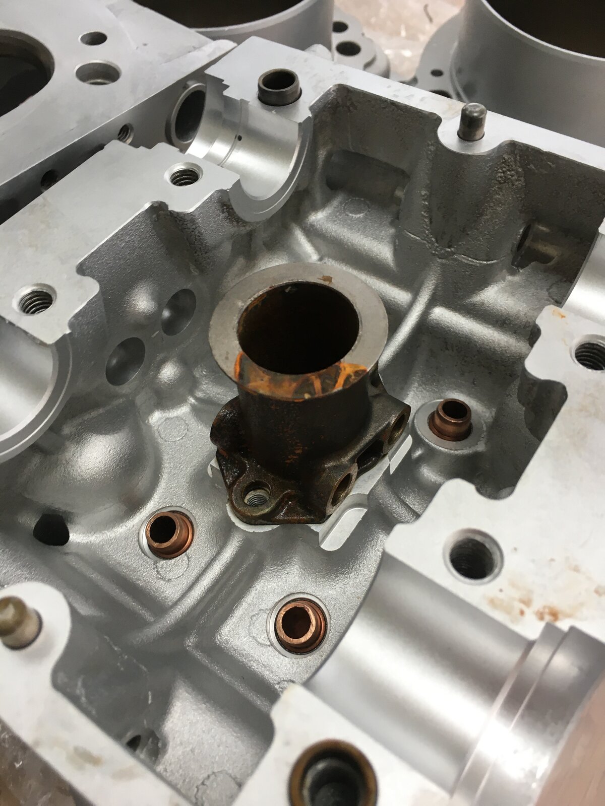

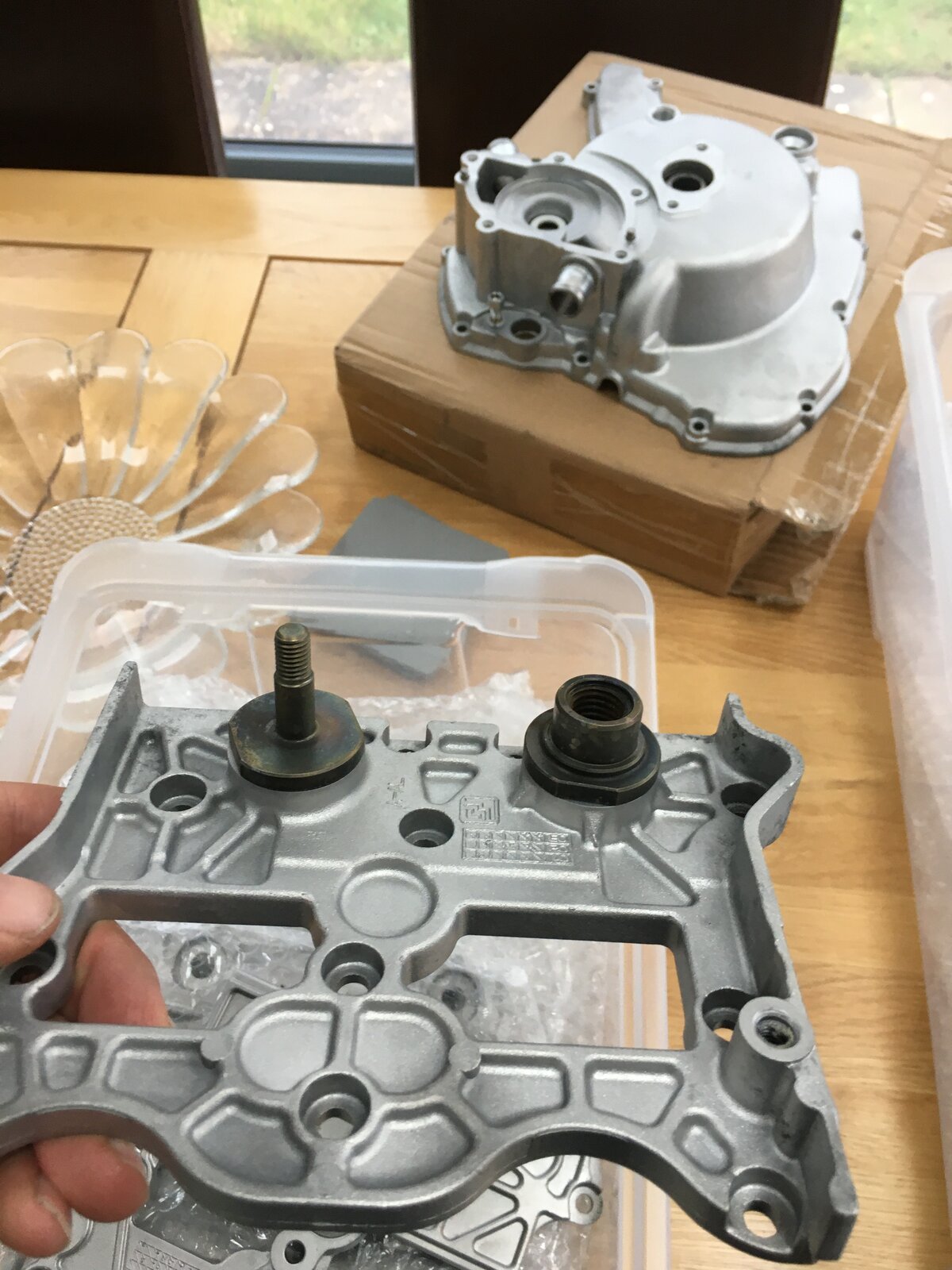

  5. These are the offending items, they cleaned up OK after a Scottish Brite but I'd like them to be like new ideally.

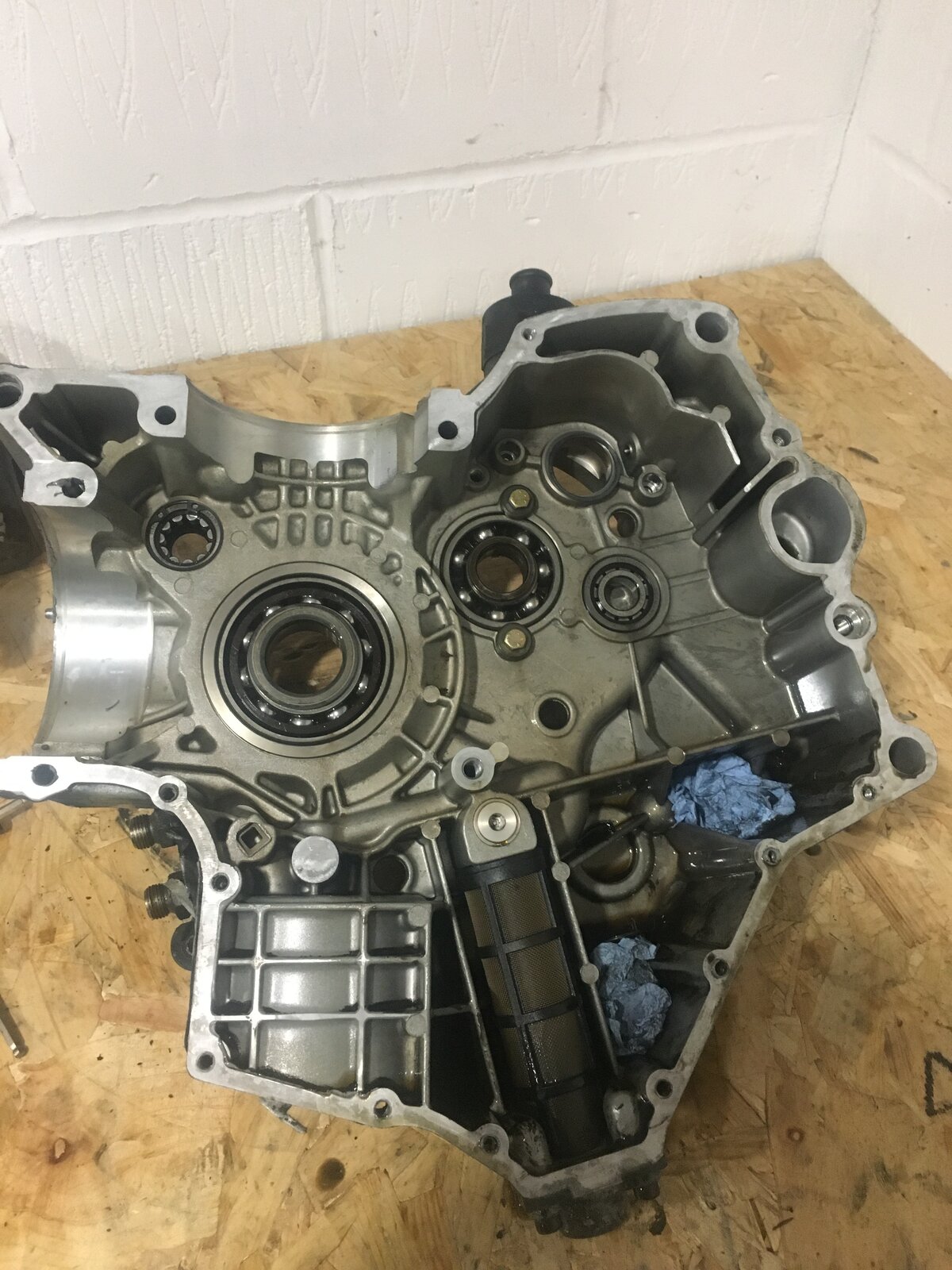

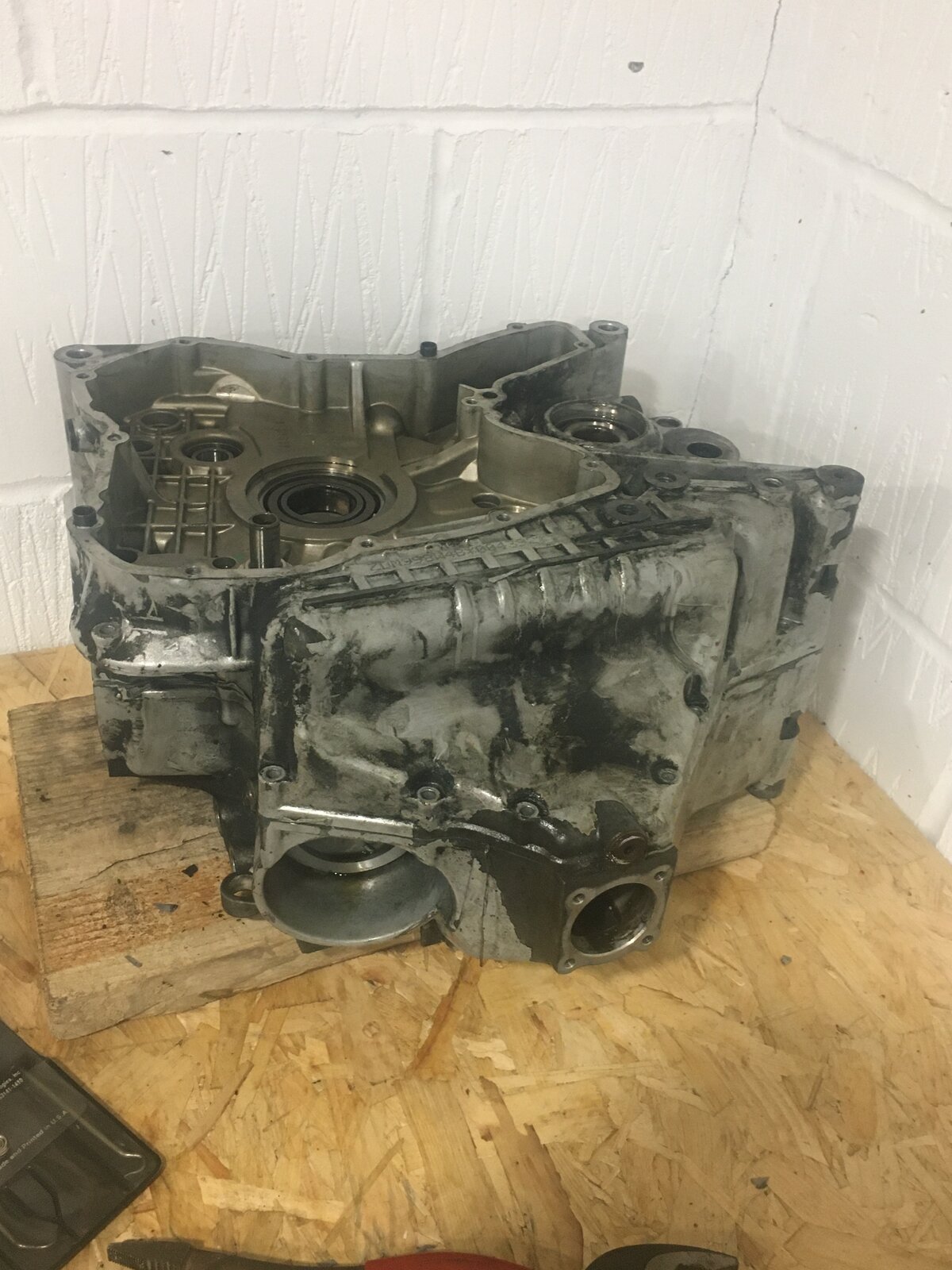

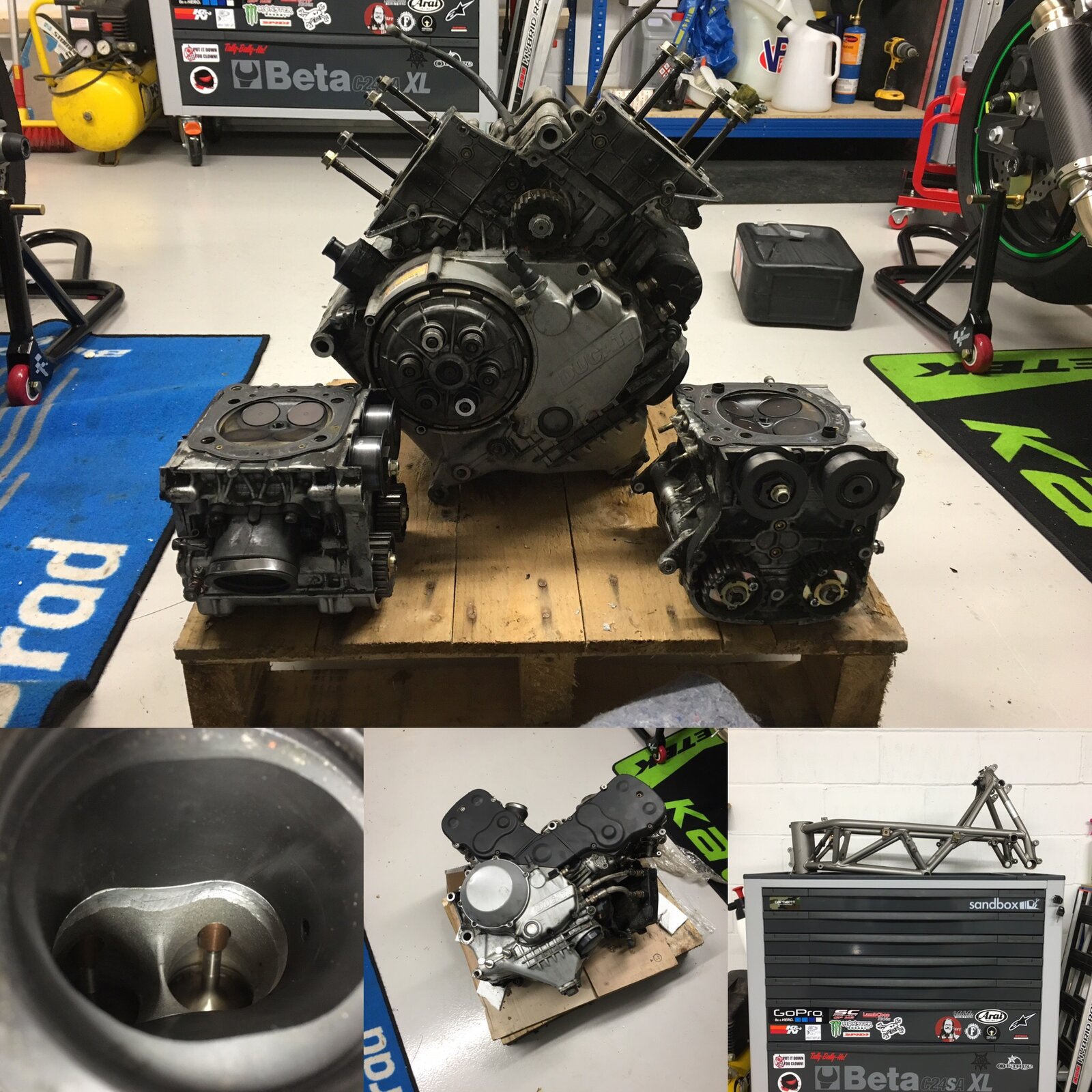

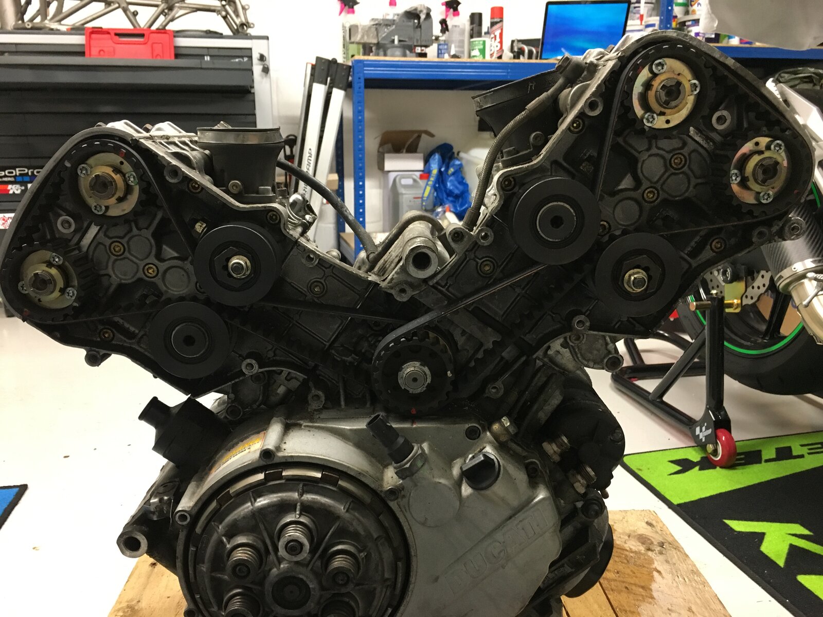

  6. Here's some general pictures of the engine pre and post vapour blasting.
  7. im not certain but i think they are made from steel thats been zinc plated and then black passivated (certainly the tensioner rollers are steel and judging by the rust the tubes for the spark plug are too). if so , it shouldn't be too hard to find a plater who can do this for you or you could look at a DIY zinc plating kit from someone like https://classic-plating.co.uk/
  8. Funny you mention that I saw on the cam wheels today the zinc coating and figured the spark plug tubs might be something similar so was going to aim for that. At least now I know my thinking isn't completely off.
    Thanks for the help.
  9. I've managed to get the spark plug tubes out and there is a company locally I've used for coating before who I think will at least be able to Zinc coat them.

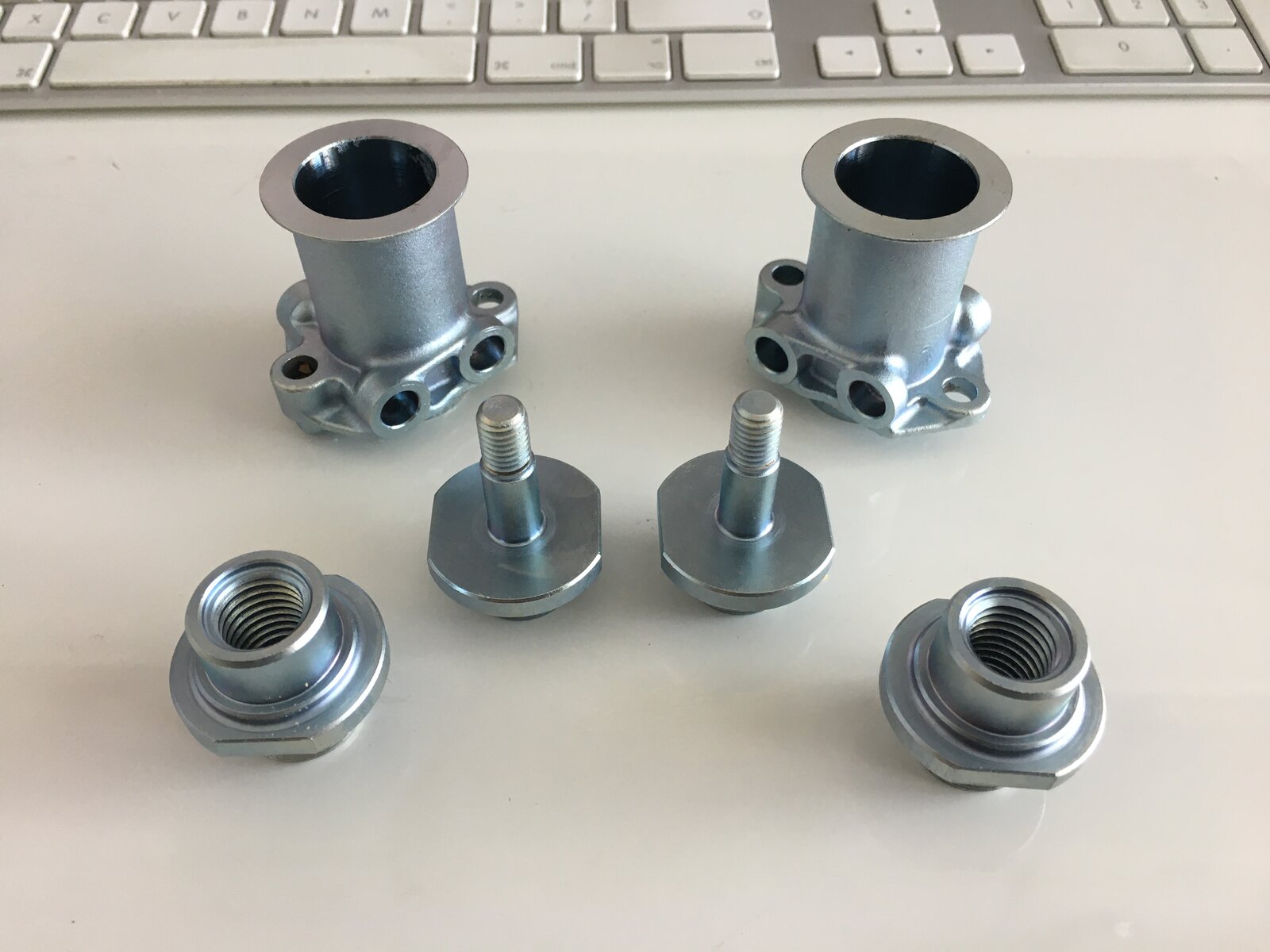

  15. So for those of you that are interested, I picked up my parts from the coating place today and they turned out excellent.
    If you need any coating or anodising and you are in the Milton Keynes area you could check out Collings Finishing Ltd - www.collingsfinishing.co.uk
