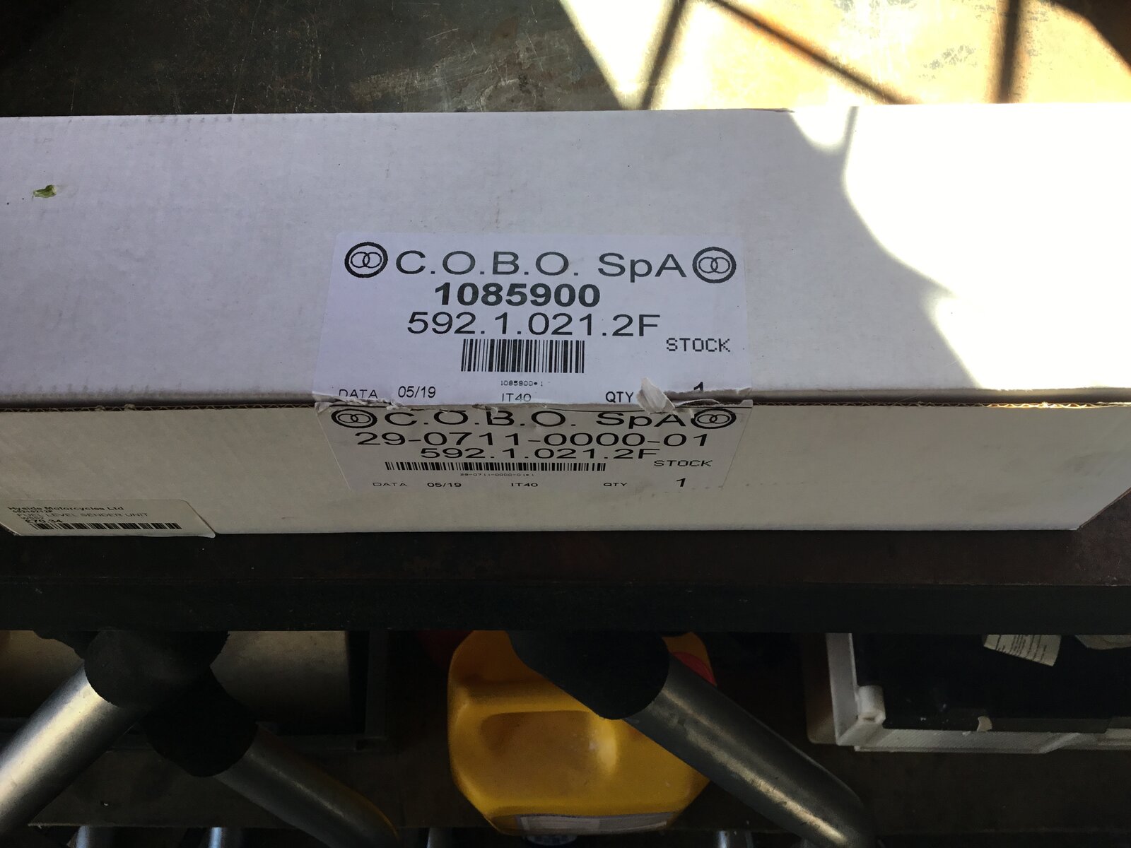

  10. I was reading on one of the FB forums yesterday that we are now up to suffix F on those senders, with the latest one seemingly OK (so far lol) Ducati really ought to honour all faulty sensor claims regardless of bike age. They were poor from day one

  13. Strange you should say that - my Diavel (Gen2) sender finally stopped working a couple of weeks ago and I've been in touch with my local dealership to get a replacement - the guy I spoke to said they have gone from "F" to "E" which seemed counterintuitive, but he said the E has superseded F :thinkingface:

  16. The new one I fitted was an F. I was told this is the latest version! 290A723A-17CC-4946-81E3-F84405596EC6.jpeg

  19. Yep, I checked with the dealer and the service guy got confused/mixed up with the Multi I used to have, the latest for which is "F" - the latest for the Diavel (Gen 2) is "E" (it currently has a "D" installed).
