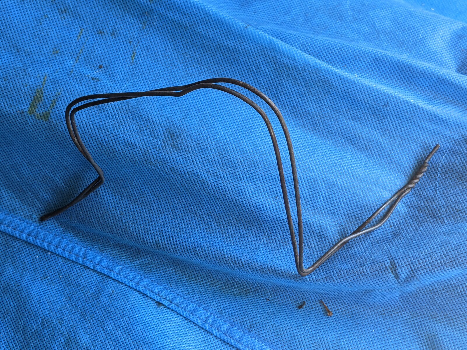

    How to stop a valve falling into the cylinder when removing the closing shim on an old bevel.

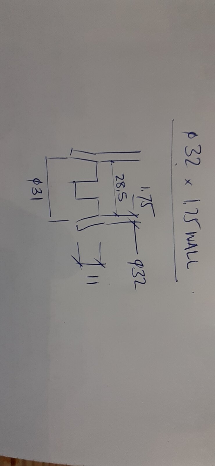

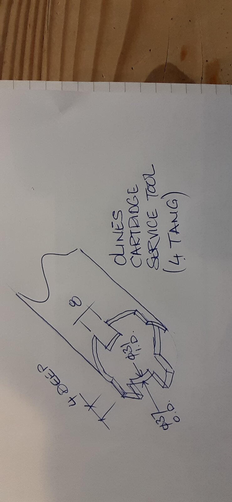

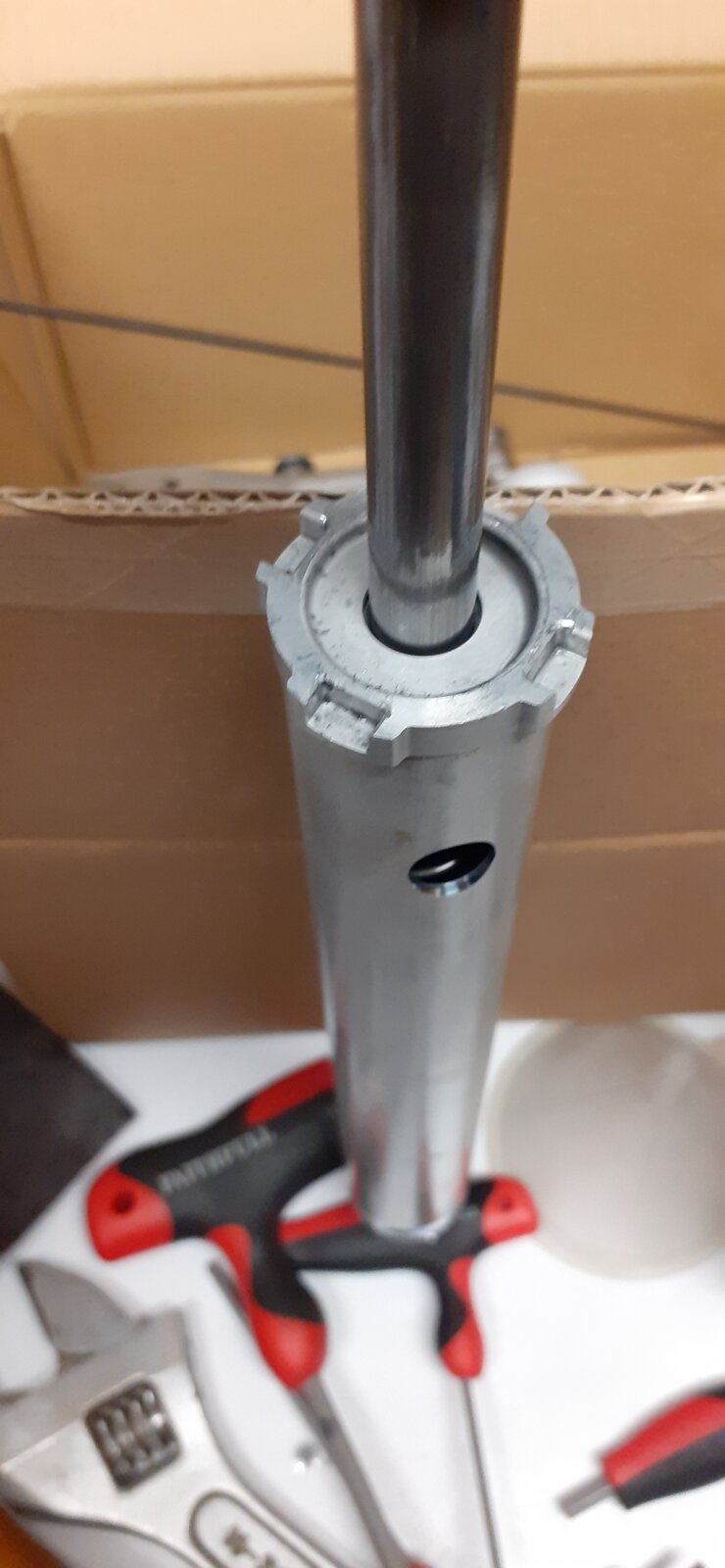

  2. Messing about with some bent Ohline Front Forks.
    Cartridge Service Tool.

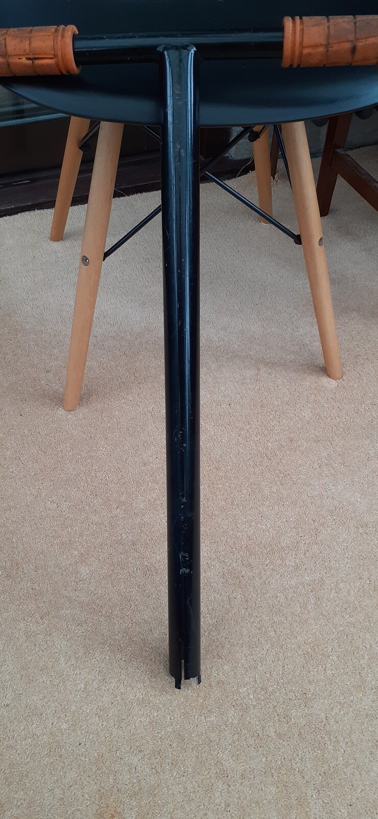

    Made this from a Kids Scooter (Blindside 360 if anyone is intrested) they are too old for it now.
    These are max Dimensions as measured when I got the Cartridge out (to fit in bottom picture).
    These are the sizes of the Scooter tube, I bend the tangs out a bit.
    Cheers Gaz
