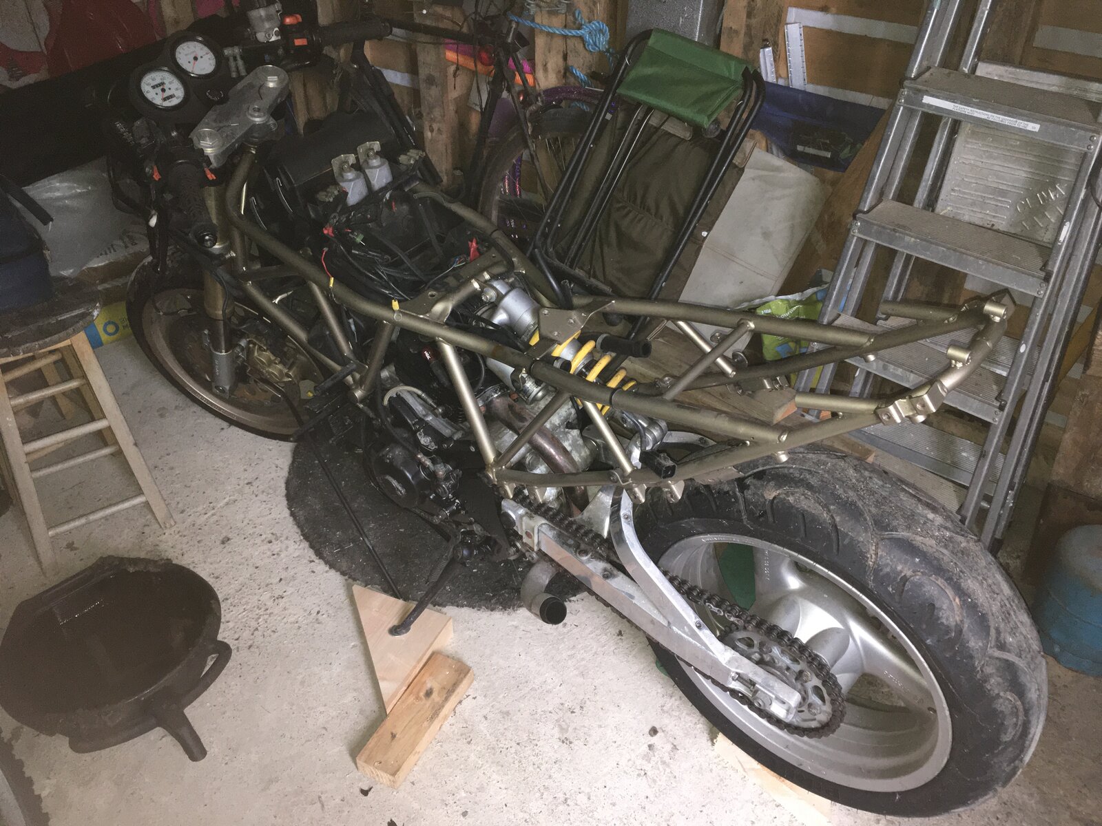

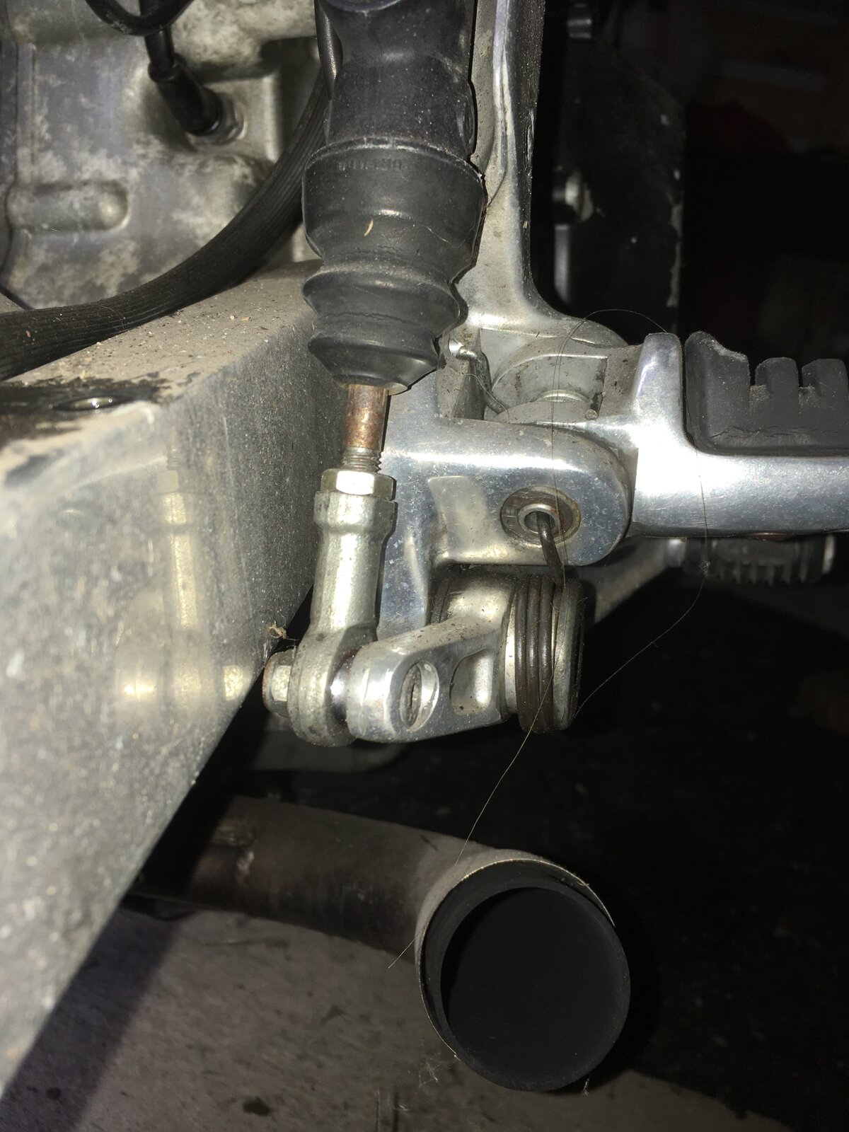

  1. The strip has begun, only problem I have found is the brake leaver looks to be hitting the swing arm.
  2. That's because it is bent or the pivot is. You can see the master cylinder rod is skewed too.
    Or perhaps the rose joint is not an OEM pattern and is a bit too big.....it seems newer than the rod and cylinder.
    If it is the lever which is bent, it can be straightened if done carefully.
    An easier way might just be to use a half nut and Loctite instead of the nyloc nut; but that won't put the rod into the correct line.

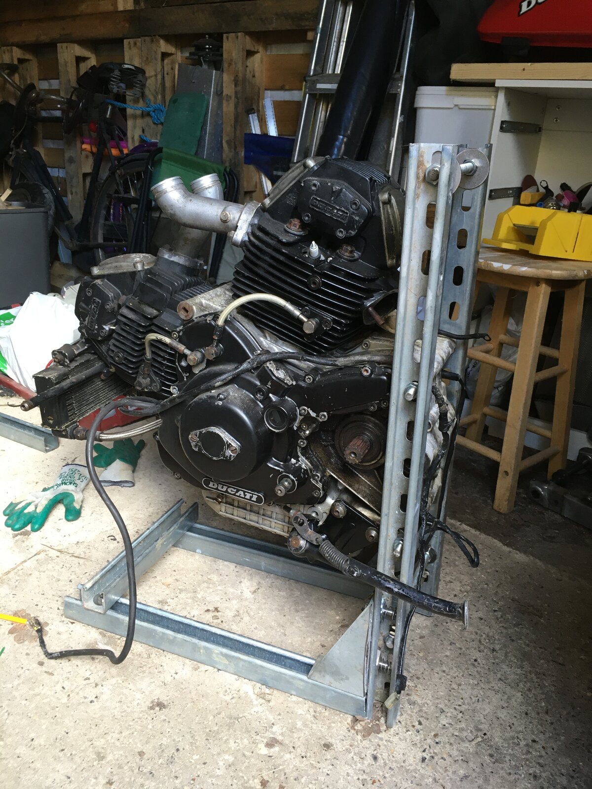

  7. Thanks Mark, I’ve done that before with my old 750, one tunnel was cut on that bike. We are going to try ultrasonic first to see if they will free up. Engine stand is made, photo attached. Made it so I can flat pack when not in use for easy storage. I’m thinking of adding some castors so I can push it around.

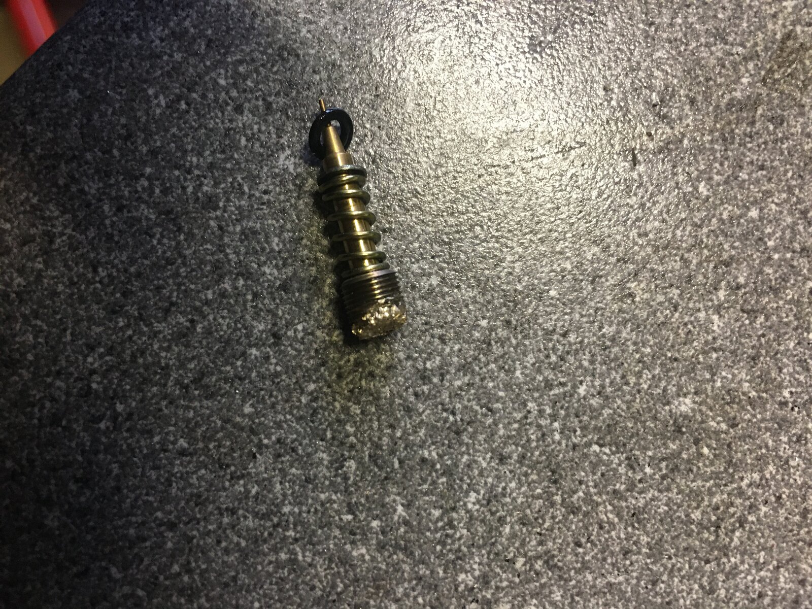

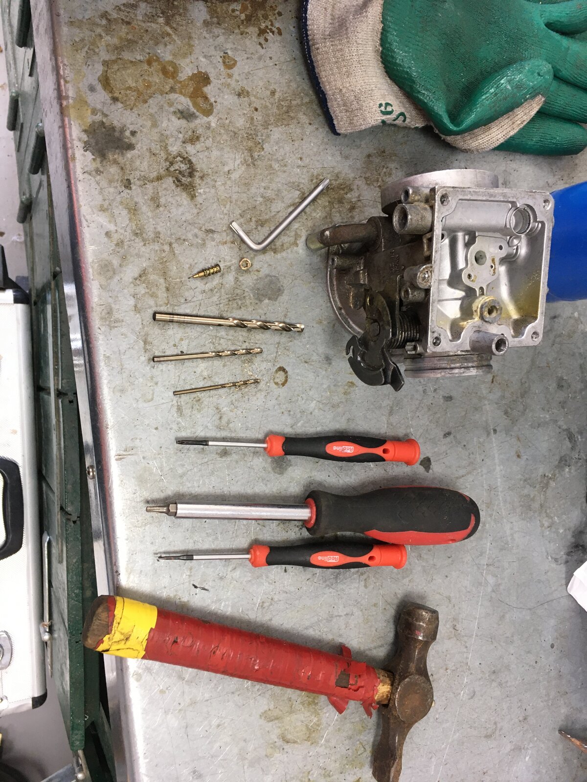

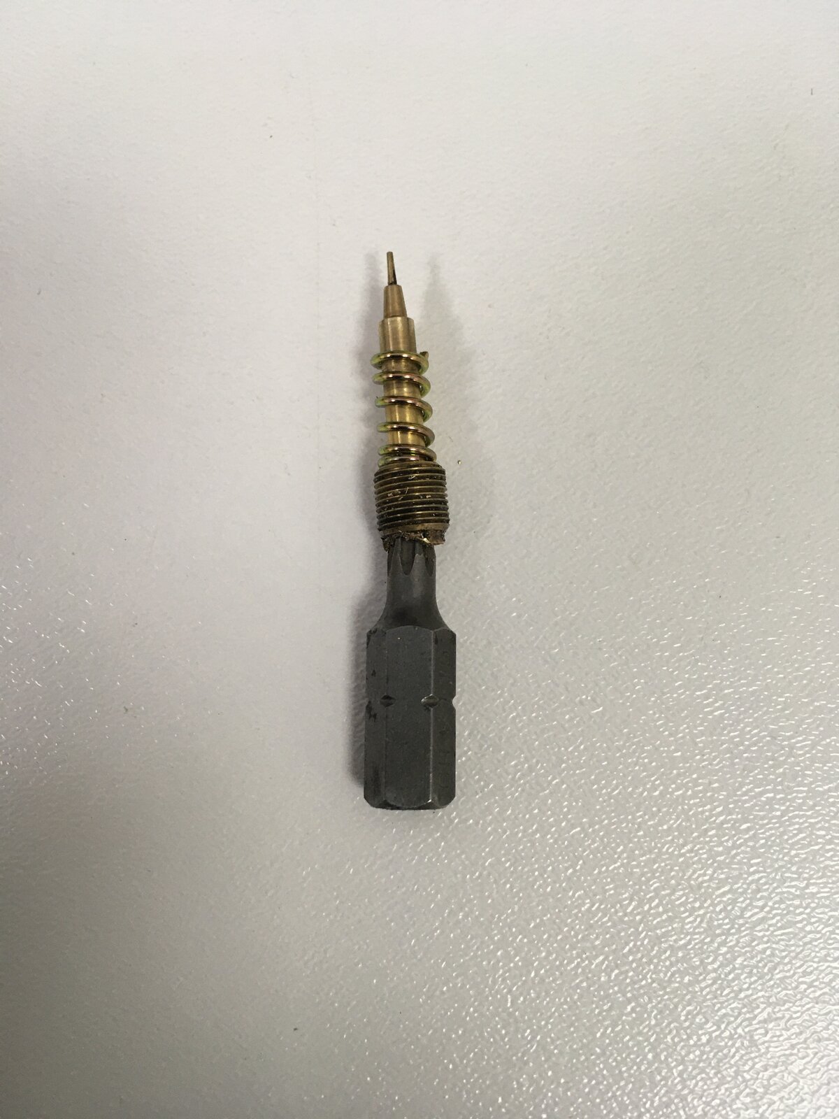

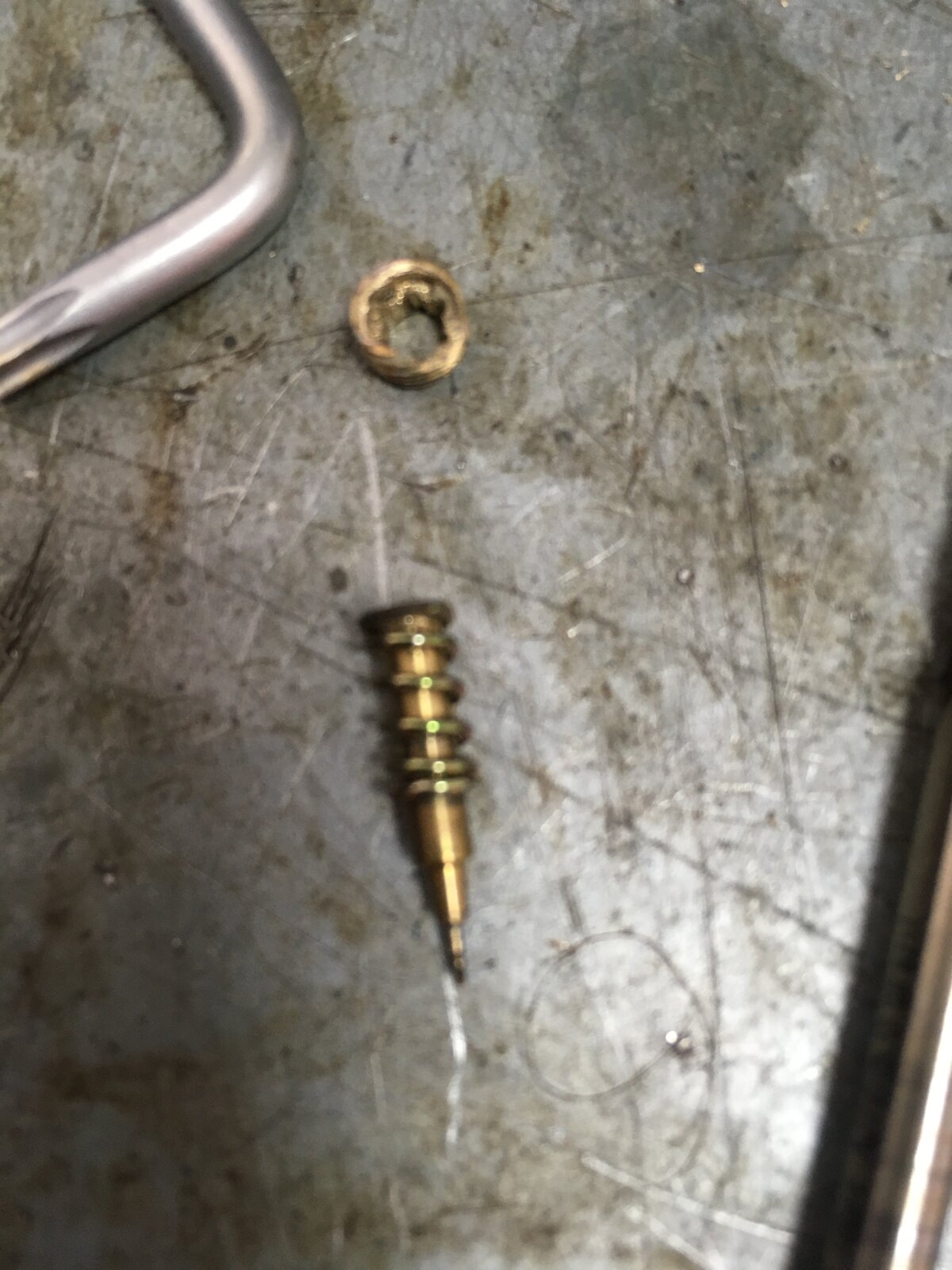

  8. So still plodding along with the little bits I can do. Managed to get one of the mixture screws out today, see photos. After 3 hours in an ultrasonic bath in a citric acid solution still no joy. Decided to try to drill in and use a star/ torque bit bit knocked in to remove. Started with a 2mm hole and T8 but no joy. 3mm with T10 and that rang out so 5mm with a T12 I think, he’d drilled in so far that’s only the tread came out. The tip then tapped out. Can any one suggest somewhere I can source replacements please when things are back to normal? Will have a go at the second one tomorrow, keep your fingers crossed .
  9. Second one out, bit easier.

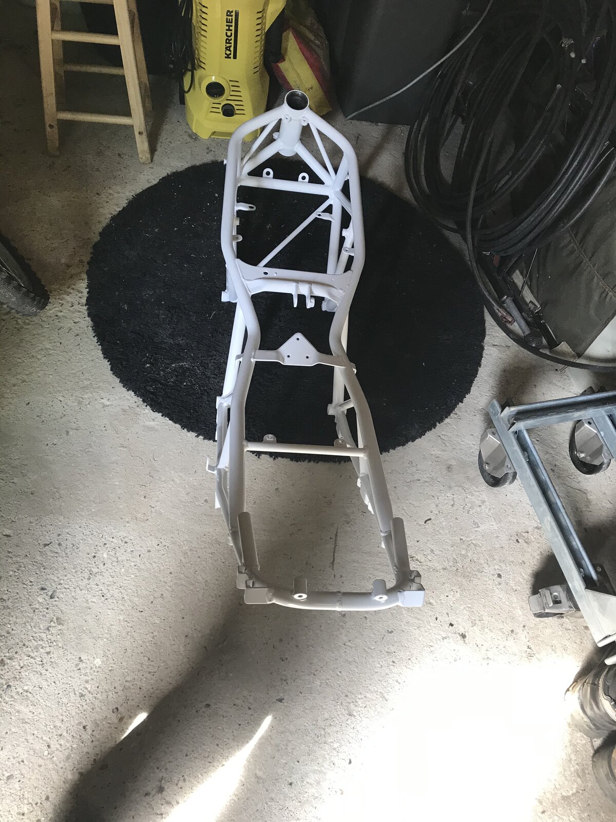

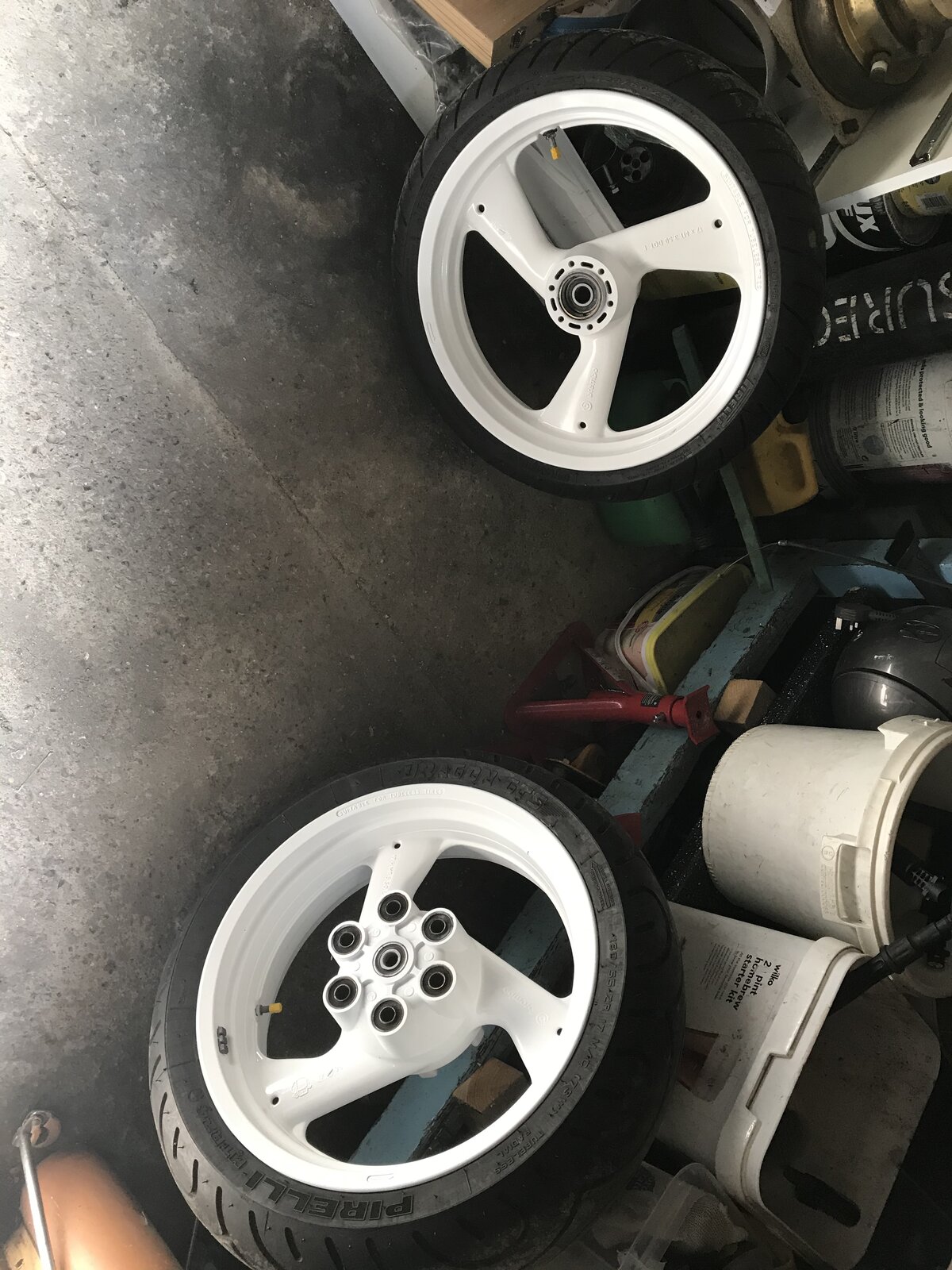

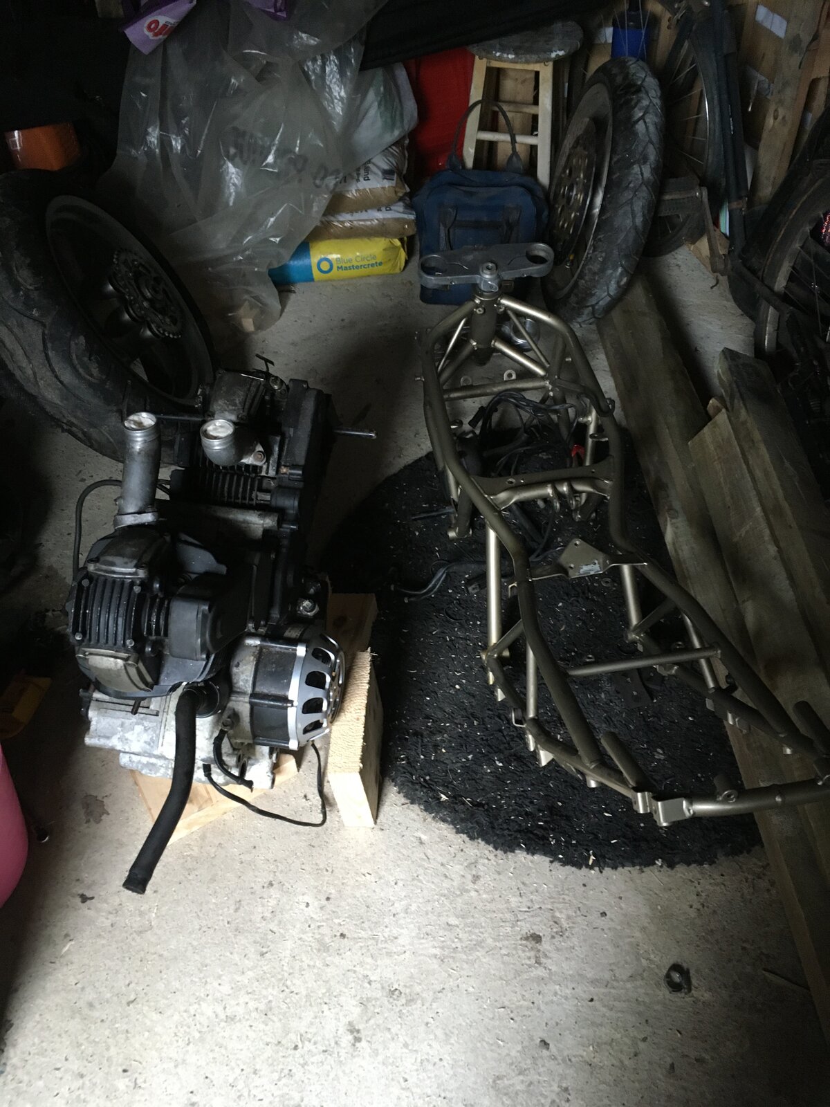

  11. So update, frame and wheels done and engine cases off for painting found a little, any know where the best place is to get a new spring please?
