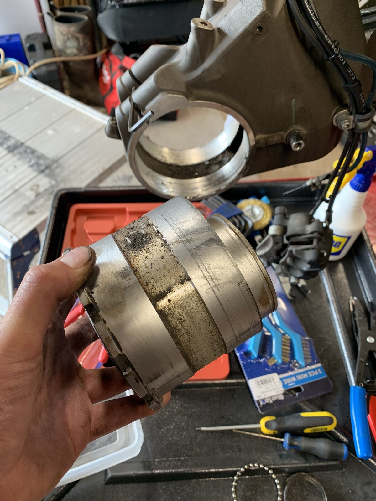

  1. MTJ, sometimes you have to give the hub quite a whack with a mallet, also make sure you have something in the pinch bolt gap, I used a small lever as I gave the hub a whack!
  2. You have removed the external circlip? Sure you would have, but thought I'd ask!
  3. the 1st time I did mine, it was stuck in the spacer sleeve on the sprocket side, it took over an hour of beating the shit out of it with a soft faced mallet to remove it, I cleaned the spacer and greased it on reassembly, when I re visited it 1 year later it slid straight out,

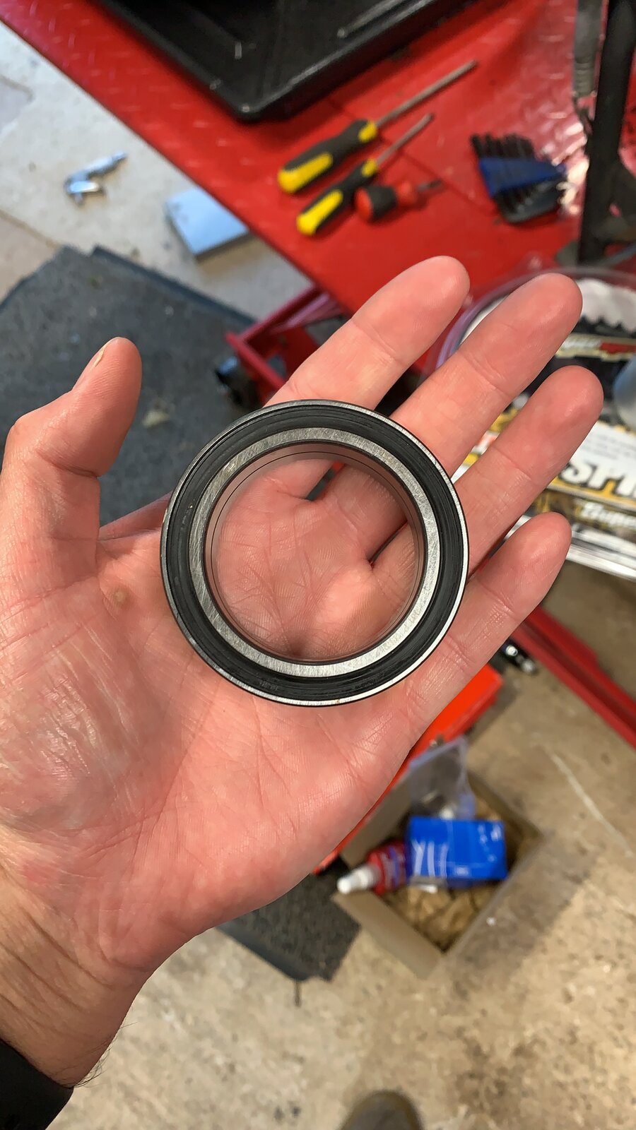

  4. I’ve just put mine back into the swing arm, I initially took it out whilst repacking my rear disc, but got carried away with cleaning things whilst I’m as in there.
    I broke the ball race bearing on the disc side, so I replaced both bearings, stripped them down, washed them in paraffin in my ultrasonic cleaner, then packed them full with Putoline racing bearing grease, i grease everything, with the correct grease.

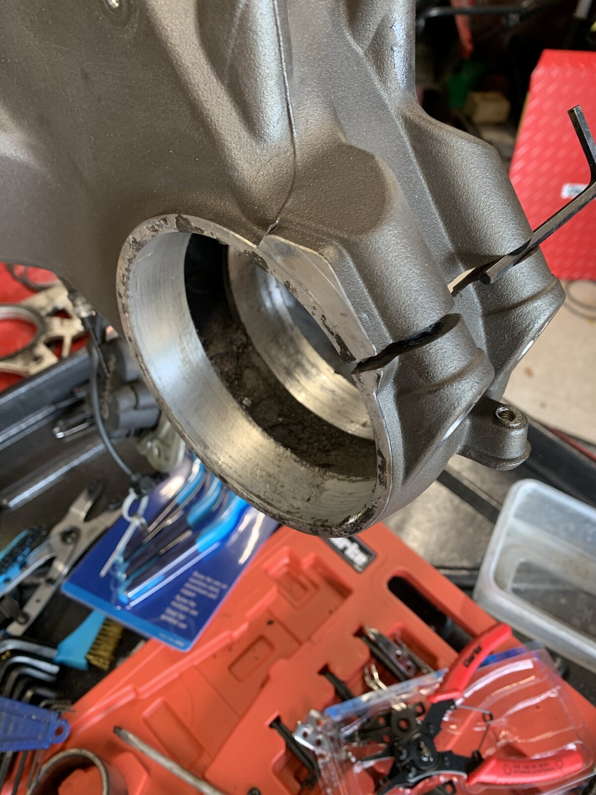

    For spacing the pinch faces apart to help with getting the hub in and out, place a 4mm Allen key in the gap, it’s the perfect size, and it sits on the flats so it doesn’t damage the faces.
