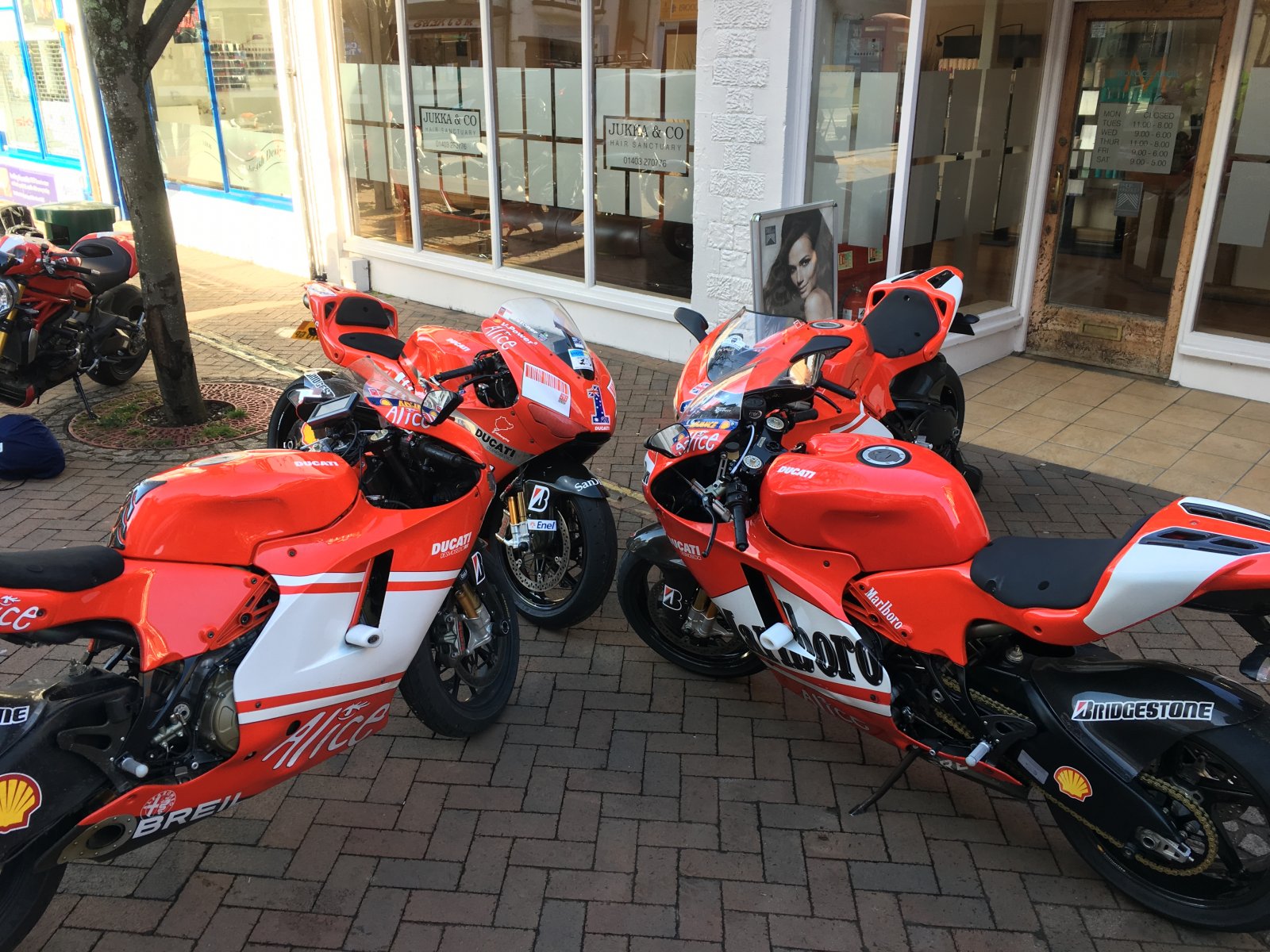

  17. Hi, I see you've got your Desmo now, well done.
    Here is a picture of four of us this year at Pizza Italia.
    Mine is the closest one on the left and @Dave bike with the extended tank is one the right.
    Could have been an expensive accident when I was the last of the four to slot into the X downhill

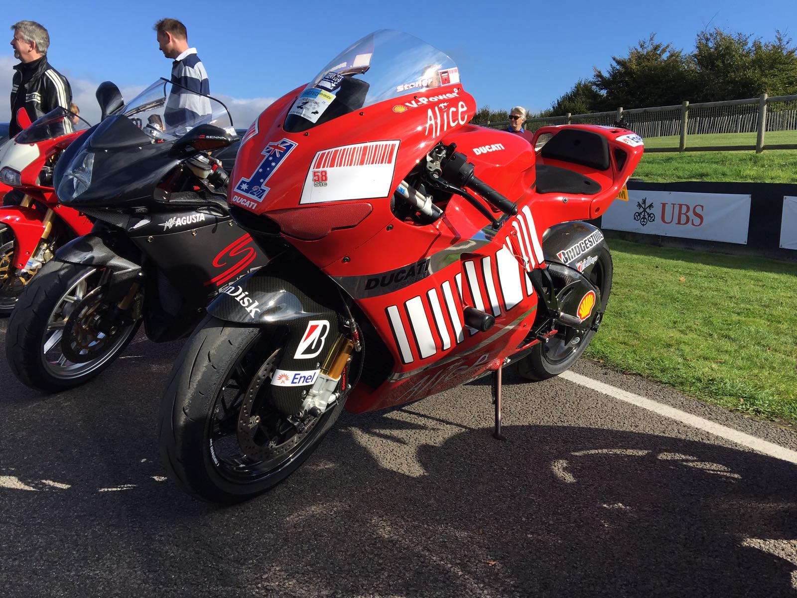

    One of those looks familiar. Good friend went to Goodwood a few weeks ago and sent me this picture (knew how much I liked the D16). Said he spent a while chatting to the owner who apparently used it as it was designed to be used!

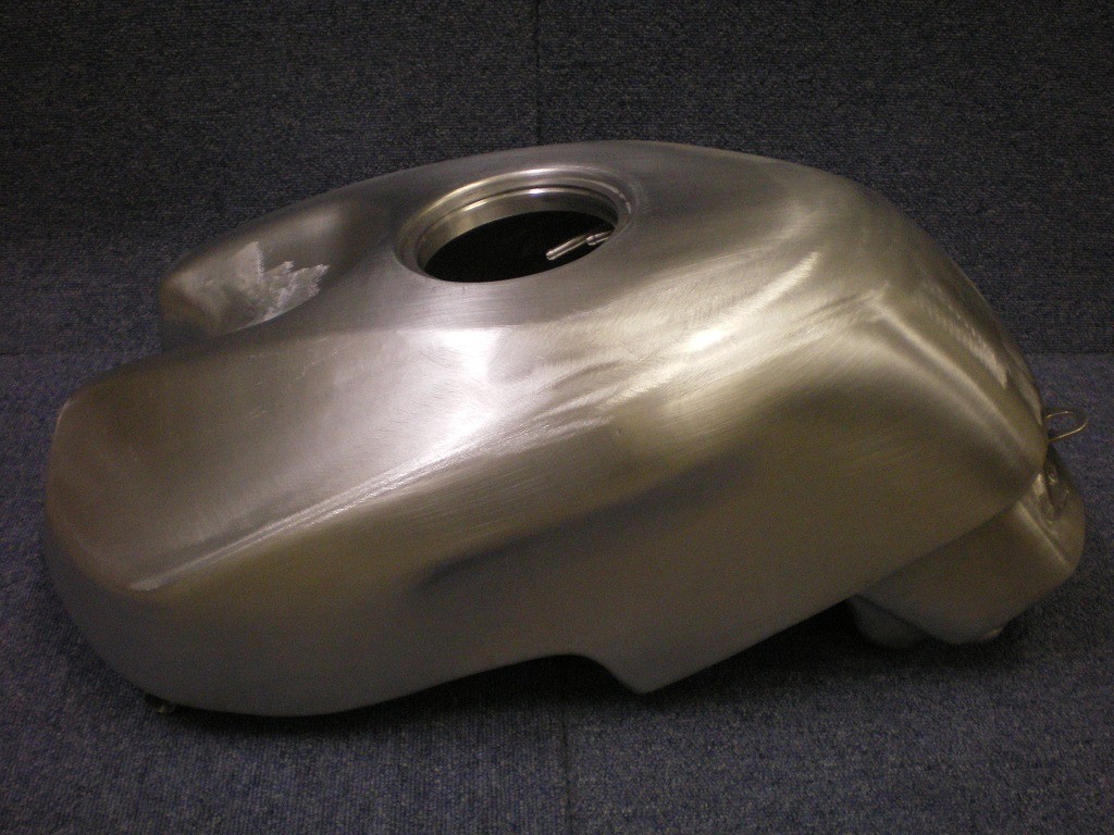

  19. Beater of Japan will make you a stunning alu tank to order.
    As far as I know, they are the same capacity as standard, but I'm sure you can ask them to do an increased capacity version.
    They're not cheap at around 2k, but you can probably get some of that back if you sell your OEM unit.
    DUCATI DESMOSEDICI-RR Aluminum tank | BEATER-JAPAN - Aluminum tank -
