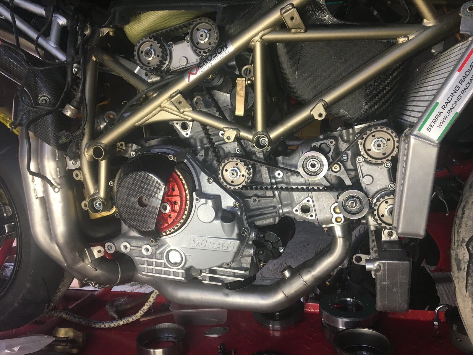

  1. Unusual idler set up on the horiz belt.
  2. Yes thats the setup on race heads.
    They are customer corse heads with 39mm ti inlets and 33mm exhaust.
    Cams are 471 with 20 tooth pulleys and wide belts hence no covers.

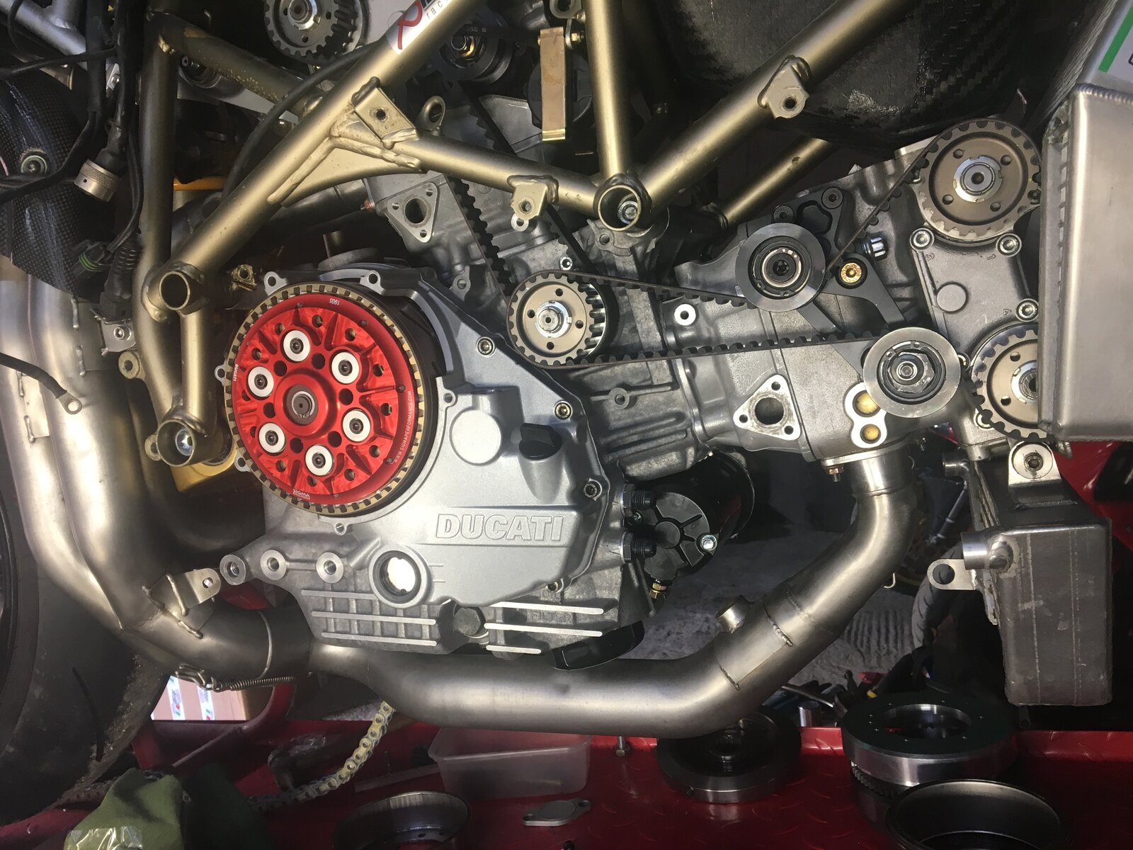

  8. BA1D10D3-DE3C-4AE9-903F-62EB42944578.jpeg 0ECF0D3F-6C88-4D32-AC3D-96D69CD49E49.jpeg A couple of hours this evening have seen a new Sigma race clutch fitted into an old stock RS case.

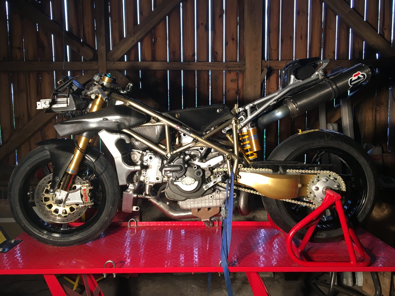

  11. 3EA751D6-EEA0-4CE2-B00F-DFEE4DAF2079.jpeg Waiting for all the carbon to return from the painters.
    Then the sticky job of applying decals.
  12. The gear lever is at the wrong angle :bucktooth:;)
  13. Fair play mate not taking you long.
  14. Have you not seen his cloven feet then :thinkingface:……………...:imp:
  15. Is that a bolt on deep sump under the normal sump?
    Bike looking great.
  16. You’re right but it’s only there so I could put it into gear and set the air gaps on the sensors.
    Waiting for the rearsets to arrive then the correct lever with a shifter will be fitted.
    Don’t forget that it’s 1 up and 5 down on race bikes.
  17. 996 rs era crank cases...
  18. and square up the front mudguard...totally upsets my fen sui
  19. Well spotted!
    The cases and barrels are ex Hodgeson 99 996RS
  20. it looked strange without one so I just dropped it on. Not bolted on because it’s a road guard and the wrong spacings
    The correct one is being painted.
