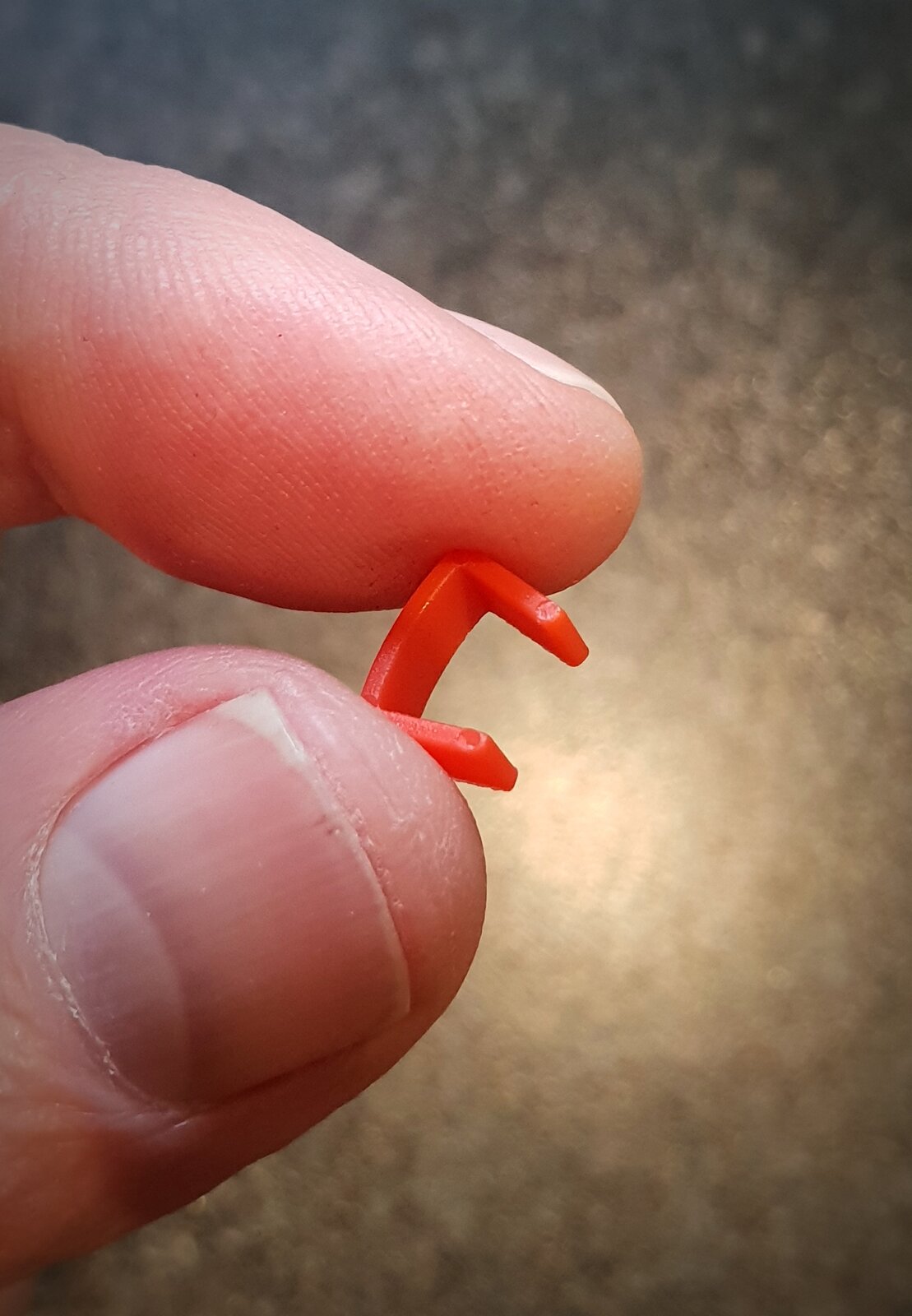

  12. How easy is the throttle spacer to fit?
  13. Looks a doddle. Have a look on YouTube :upyeah:

  16. Make sure you have the correct bit to undo the security bolts on the throttle assembly , the bit that came with my kit was drilled off-centre and I ended up buying a new set of of bits so I could undo those bolts.
  17. Haha I used urban all the time for mounting/dismounting or filtering around town. I set up enduro as a track mode too :upyeah:
  18. Fiddly if you don’t have fingers like a Thai bride
  19. Ah yes, needle nose pliers are your friend. I could barely even start to fit the part with my bare hands.
  20. I bought a cheap pair of dental tweezers, useful for all sorts of things (but not any other things Thai brides might offer)
