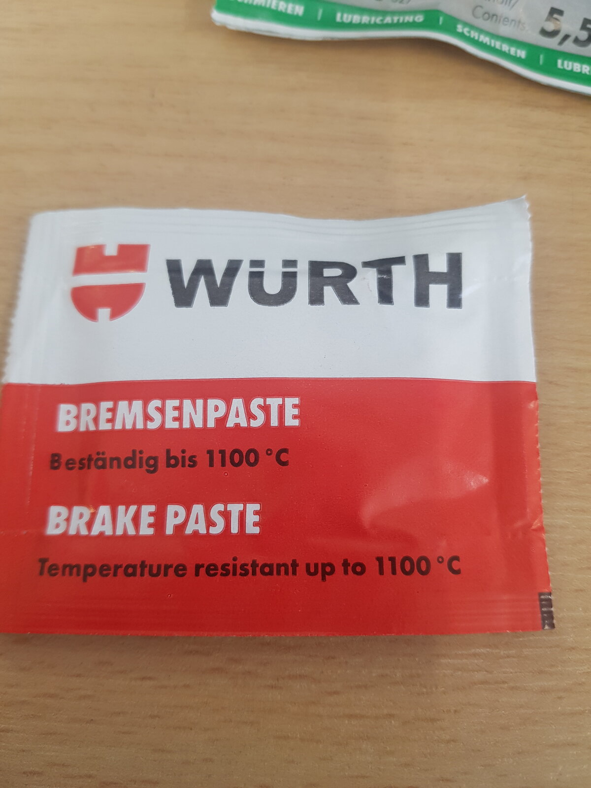

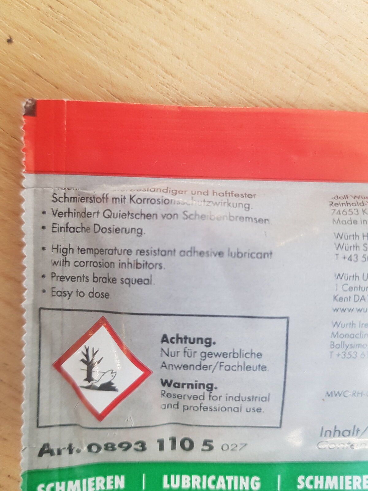

  7. I use this Wurth brake paste on fasteners
    Unsure of the effect on mag.
  8. same for ti with this grease on it?
  9. yup, but if you've got a range such as 25 - 28 say, go for the 25.
