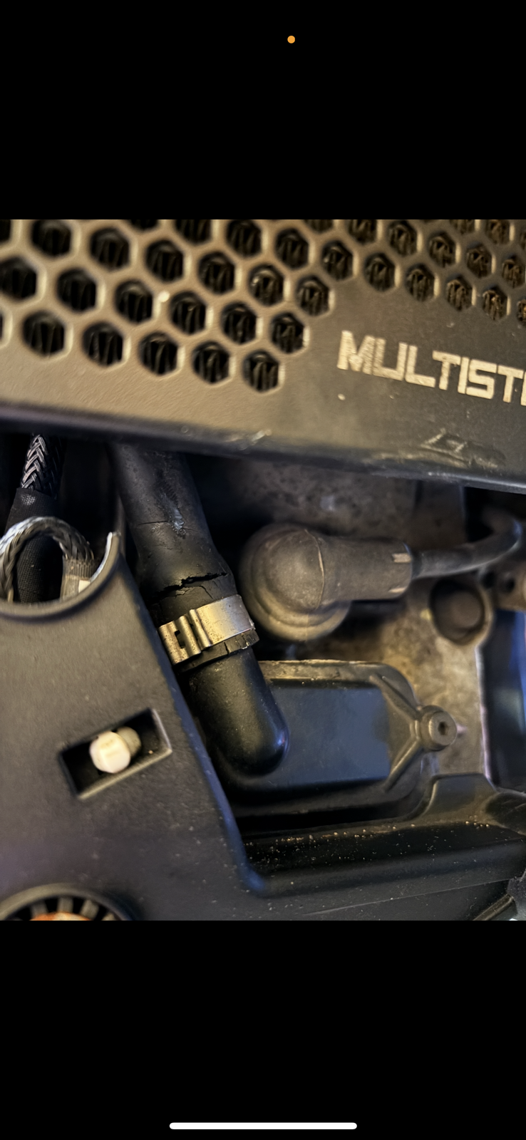

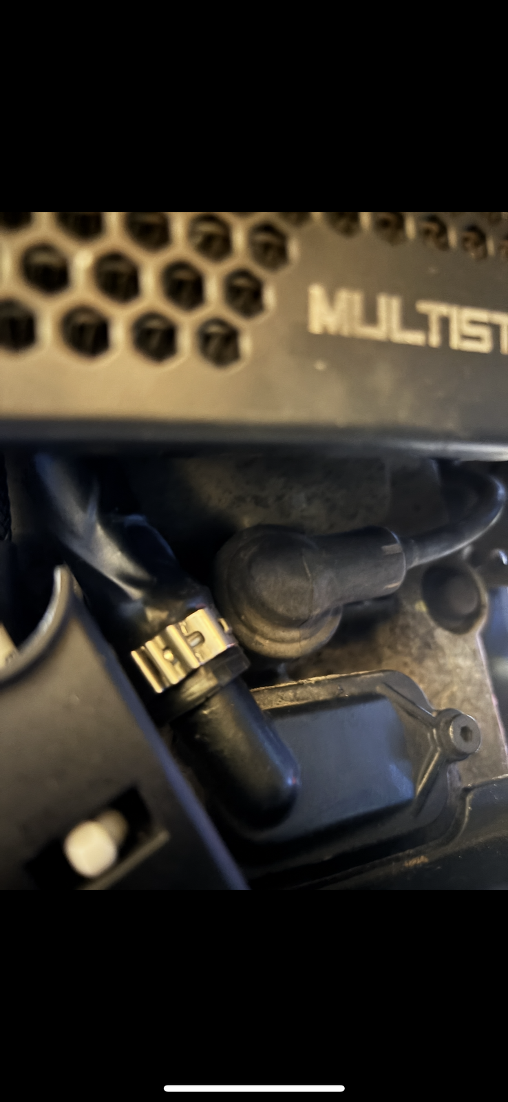

    theres also what looks like a black breather hose at the very front on the top of the horizontal head going into a black rectangular cap thats really splitting and looks like its hold together for its life so thats desperate to be replaced!
  8. Probably something like ceramic grease, it helps with removal of the plug caps when the time comes as they’re notorious for sticking. If it’s applied to the ceramic part of the plug prior to pushing the cap on all well and good but if it’s just been shoved up inside the plug hole and then the cap has been pushed onto the plug it comes into contact with the plug electrode and may inhibit conductivity.
    That’s the hose from the camshaft area breather port to the airbox.
    Check your map sensor tubes carefully, they have a habit of cracking and perishing with the heat from the engine. I’ve not seen major splits but have seen crazing and several tiny minor cracks around them.
  9. Far from ideal but not terminal, worst case you’ll get a slight oil mist around it should it give way altogether. A quick fix would be to disconnect it from the breather plate’s tube, you should be able to reuse the clip. Get some suitable diameter heat shrink tube, clean up the cracked pipe with IPA (not the beer) slip on the heat shrink, shrink it and then reattach the breather pipe and re secure the clip.
  10. Cheers bud, just ran it up after messing with the plugs and leads, could feel it blowing out the cracked joint so I’ll order a new hose, think they’re only £8-£9 but looks like tank off to get to other end of it.
    Bike seemed to hold the revs at constant throttle whereas before they was up and down, not saying I’ve fixed the stutter as I haven’t taken it down the rd and I’ve only removed and refitted everything but if it has gone away I’ll know it’s one of the plug leads breaking down although I was grabbing them all over while it was running and didn’t get a shock
    Looks like il have to remove tank to check the other map sensor hose too so I’ll check that when I replace the breather hose.
    I’ve got my suspicions it’s more around the front horizontal head of the bike with those plug leads and looking at corrosion on the cam cover etc as rest of the bike upside looks nice clean and no corrosion.
  11. All taped up for now with a few wraps as it was blowing wide open, will do the job until the new hose comes

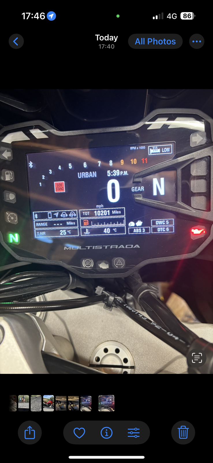

  12. IMG_9081.png Unbelievable I built it back up, go to start it and now my fuel gauge has just gone off
    It pops up with the correct level and miles for a second then starts flashing.
    I’ve not touched anything to do with that that I know of!
    Any ideas or have I got the dreaded fuel gauge fault yet it’s never gone wrong until now.
    Will it come back on riding the bike or filling tank up, like I say when I turn ign on it flashes the correct level and miles to empty for a brief second!
  13. Did you move or disconnect/reconnect anything around the vertical head? The connection for the sensor to the loom is in that vicinity. It would be worth lifting the seat and just checking the connection, pull it apart and give it a clean with some contact cleaner whilst there. It might just be a loose connection - again MelcoDiag will show if there are any stored errors.

  16. Unbelievable I went out to bike and without touching anything except starting it the fuel level came back on as full then dropped to the correct level.
    Like I say never had any issues and strange how it just went yesterday while I was going over the plug leads and map sensor.
    Will see how long it stays for or whether it just had a moment!
