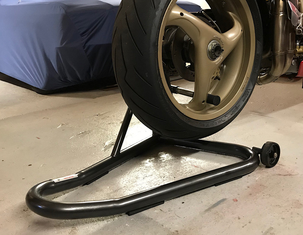

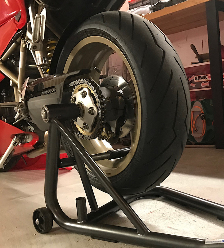

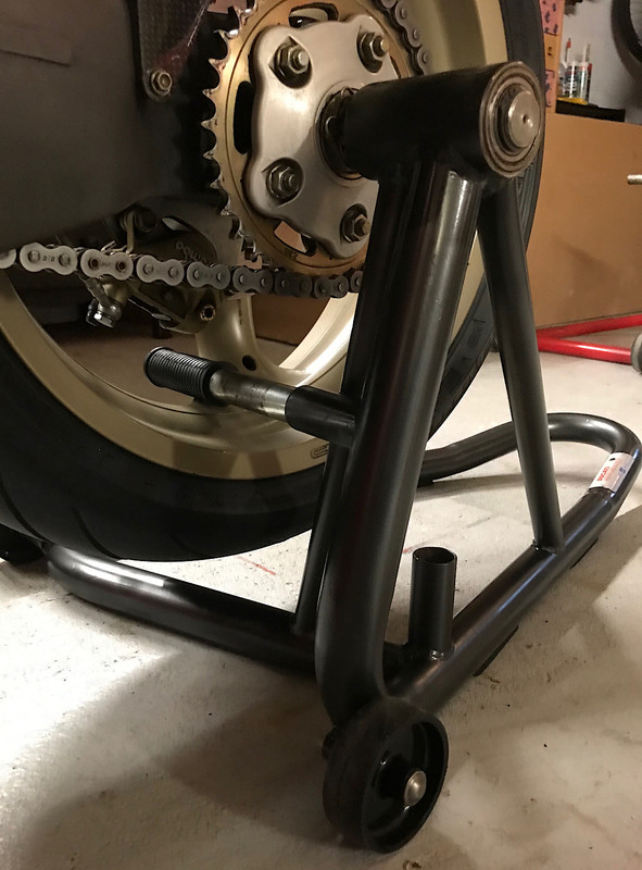

    On a single sided swing arm, all you need is an OEM style rear paddock stand with the bar that allows you to block the rear wheel. Then you can work alone on your bike, even when serious torquing is required.

  9. I torque my rear wheels (200 Nm) with this and no damage to the rims. The tip of the bar is covered with a pretty decent rubber protection. Which can be reinforced with rags, etc if need be.
