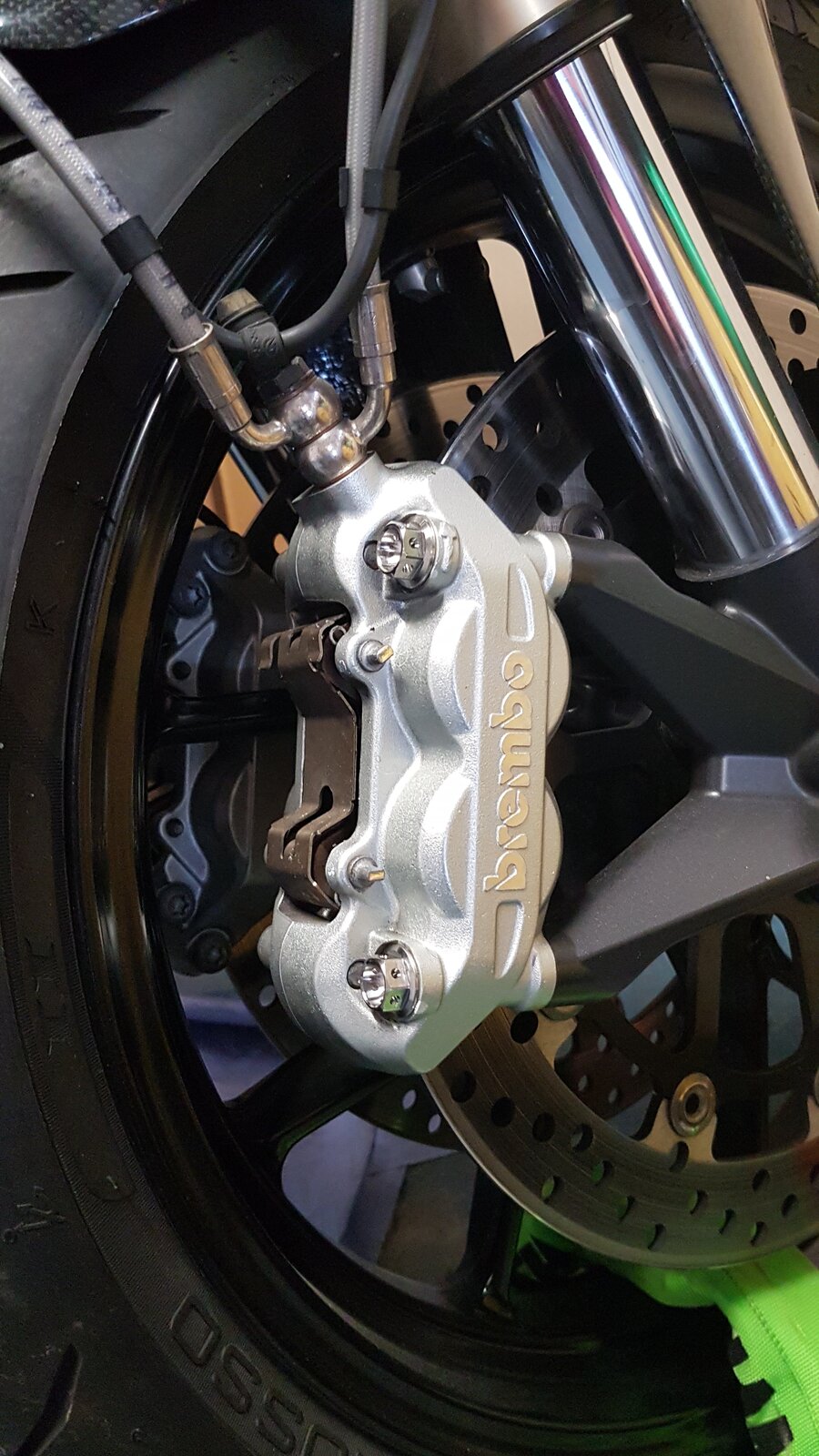

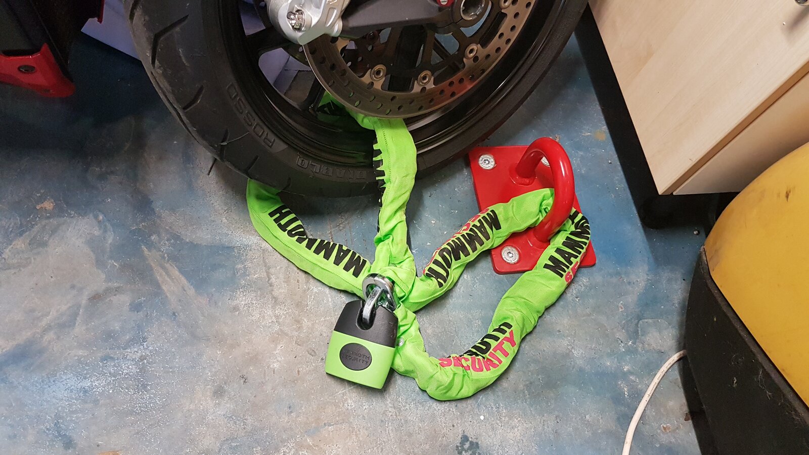

    coolant leak sorted , celebrated with some titanium calliper bolts , floor clamps fitted , rear as well making it as difficult as possible for perps..... 20200428_183842.jpg 20200428_183804.jpg
  2. If you really want make life harder for thieving scum then a shorter chain that keeps the lock off the floor would be far more effective.
    In that position it looks very accessible to freezing and a sledgehammer attack.
    • Agree Agree x 4
  3. Although a big set of bolt croppers would make short work of that chain.
    Sorry - not meaning to be negative - just did a lot of research before buying security products and it’s just a matter of seconds for properly prepared bike thieves to get through locks and chains like that - easier still if they aren’t installed in the best possible position.

  5. Needs a 19 or 22mm pragmasis/almax chain as that’s cut in seconds.
    Ball bearings whacked into the top of the bolts to stop them being unscrewed.
    Did you put the bolts into resin vials?
  6. That set up will stop local scrotes wheeling it away. But the pros would make very short work of it. That said, if the pro’s really want your bike, they’ll have it. Making it harder to nick than the other guys is key...

  7. Cordless grinders and 1mm cutting discs are your enemy.

  12. I have 2 types of fixings I use, there the Kemfix ones ,the other end of the bike I used csk sleeve anchors with ball bearings in the top

    You are totally right that a layered approach is best - if left alone undisturbed there’s no such thing as a chain that can’t be cut with the right tools so it’s just a case of making life as difficult as possible for the scum.
    What surprised me most when I did my research though was that you need at least a 16mm chain for it to be uncroppable - after that the quickest and quietist attack is with a sledgehammer so keeping the lock and chain off the floor makes that almost impossible.
    The idea is basically to force them to use a cutting disc as that’s the most time consuming and noisy. Bennetts seem to perform the most comprehensive tests these days. Based on their work I went with pragmasis - an alarm - and CCTV. In the absence of big fecking dogs it’s the best I can do!
