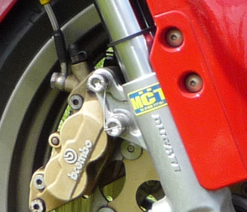

  8. Any use?
    Lockwire so that each bolt is being pulled in the direction of tightening.....
    I couldn't find my lockwire pliers so I did these with a small hand drill into which I stuffed the ends of the wire and pulled on the drill while turning which gives a nice tight twist.
    Unfortunately this one went a tiny bit slack as I turned the sharp ends into the socket cap, but it's enough to stop the bolts from coming undone.
  9. I would prefer the shank to be the same thickness as the OEM ones....calipers may not sit quite proper otherwise (ie slightly rotated) but it probably doesn't matter.

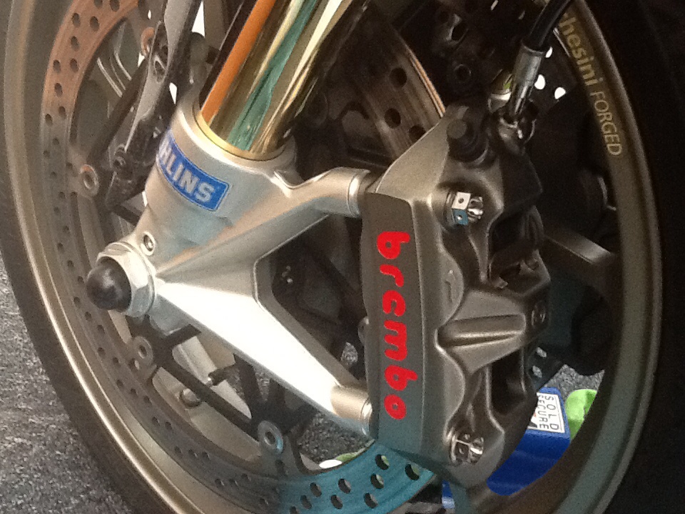

  11. Here's an example of how M Rutters team anti lock wired his bikes HM SS in the TT this year, if you want an HM SS give me a shout ;)
    Here's some of my lock wire skills on my blade :)
    Its all about the bling :D on safely of corse...lol
  12. is that bolt on to the gear lever left hand thread then.............
  13. on the "professionally done" bike.....its er wrong!
