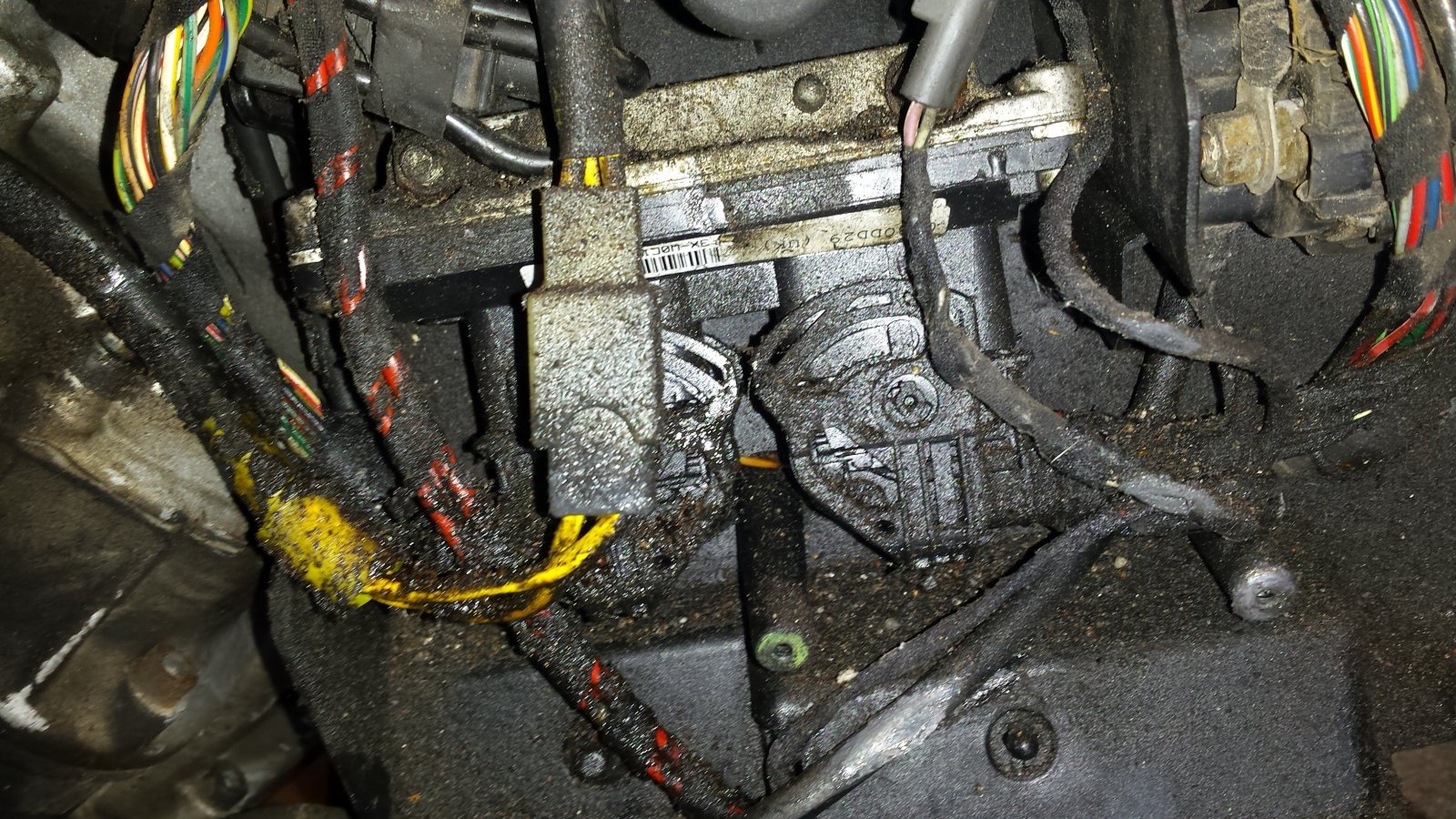

  4. OK , so I finally get round to stripping the ecu out, When I got down to it there's grease or oil all over the connector and inside. I'm sure that's not helping. Th 40 amp fuse container is also full of liquid oil when I open it . There's nothing at all on the engine or oil cooler - where is that coming from ?
    I have checked the wiring an unfortunately all good.
    The fault code is still the same 10.2 so it looks like a new ECU and Flash. Well Scunnered.
