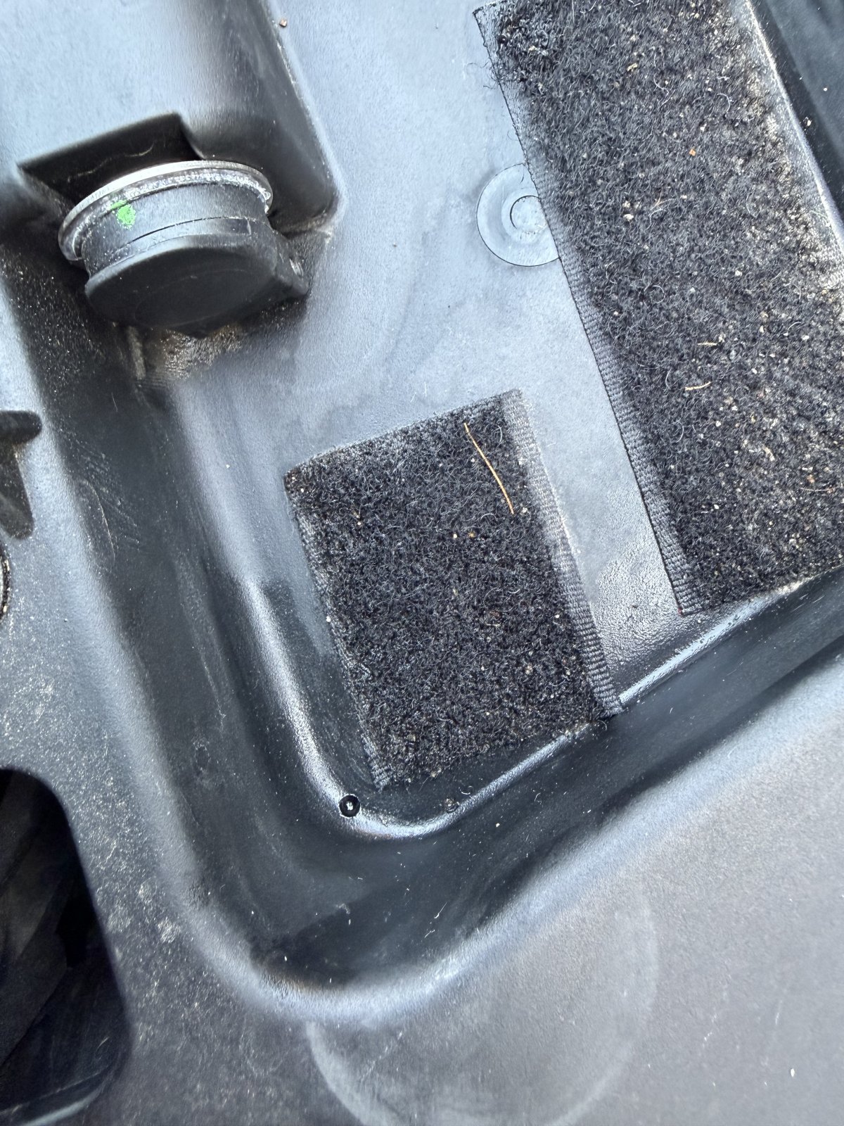

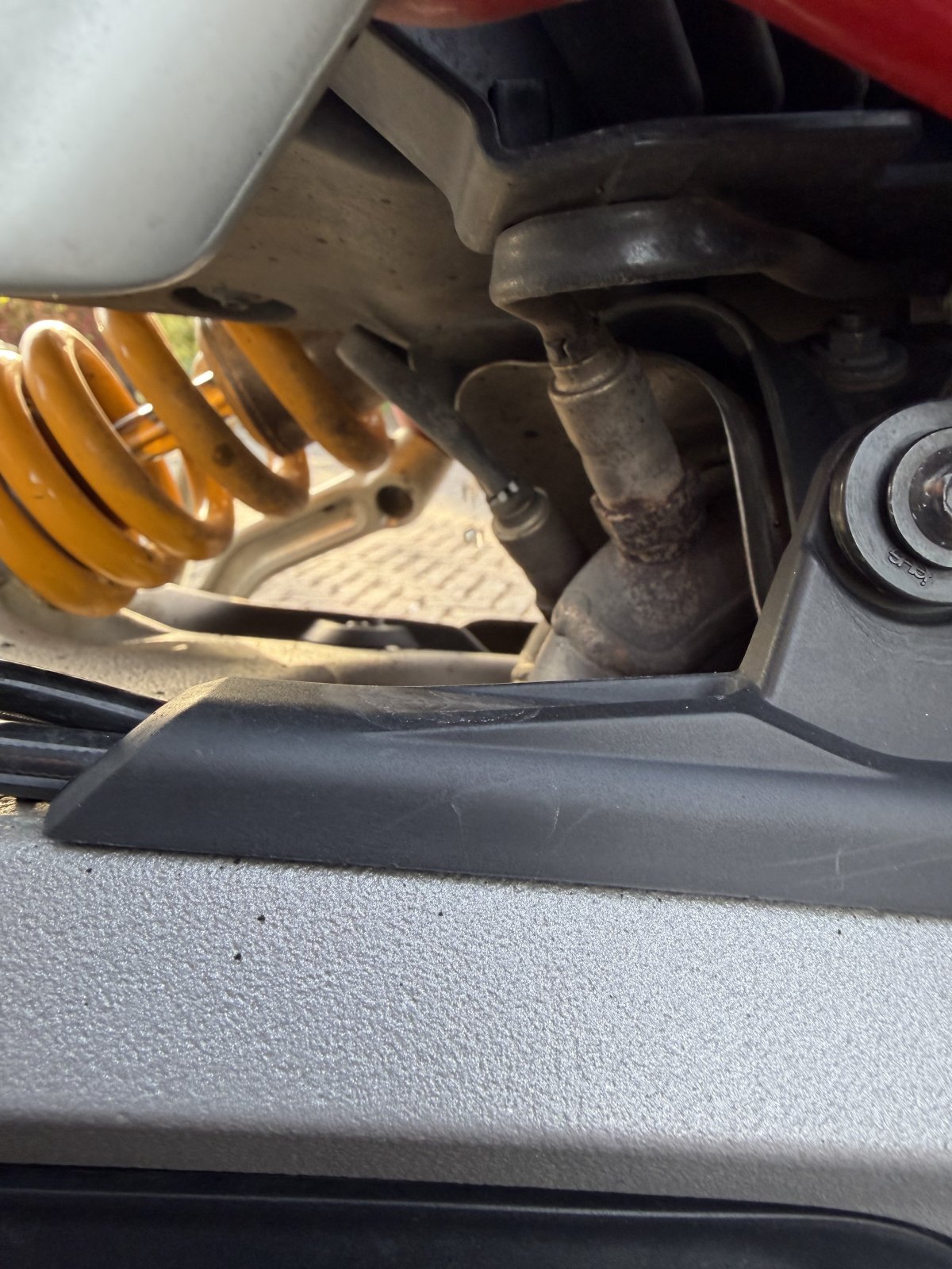

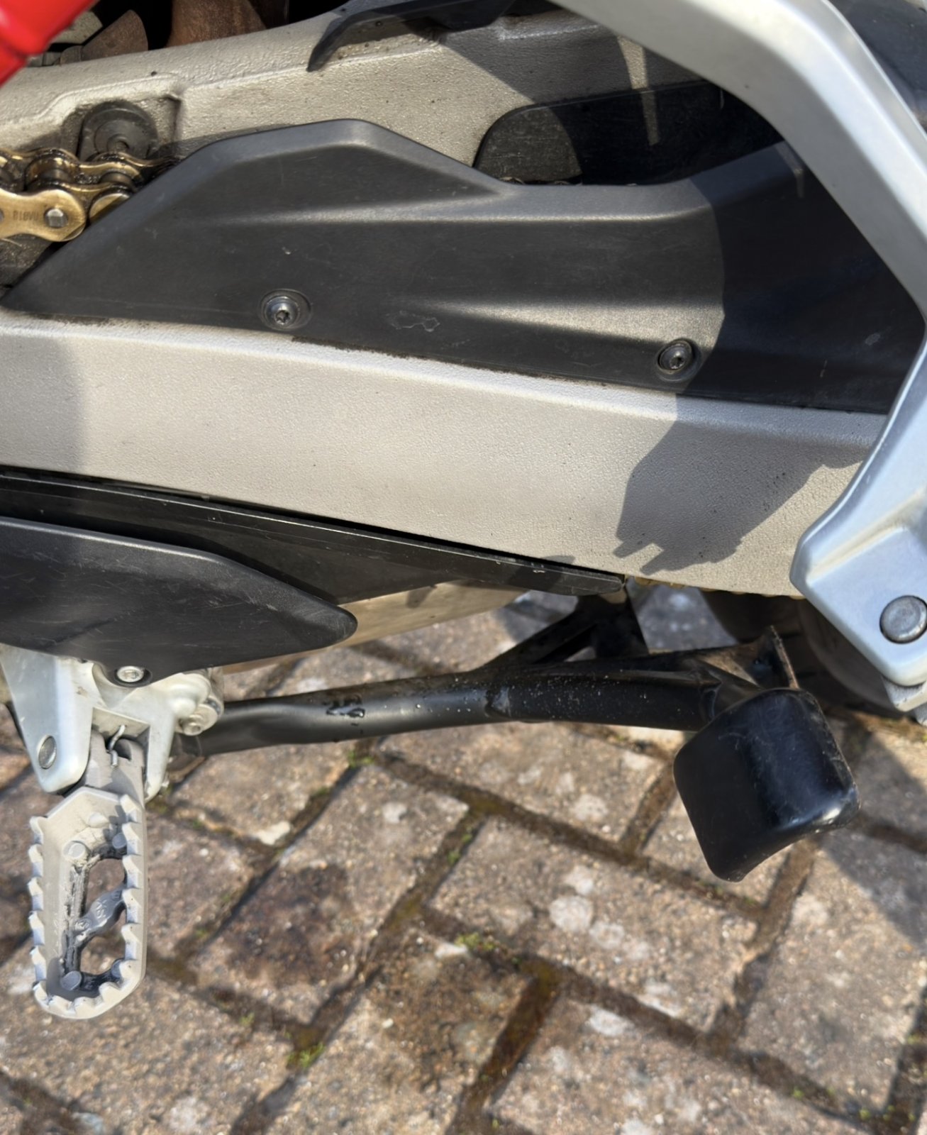

  19. Tool kit swimming again, particularly after washing, so I drilled a very small hole… drains down onto the tail undertray I think, runs down and drips out between the shock and the exhaust, down on to the ground. Should do the job…
    I always find small stones in the recess the kit sits in too :thinkingface::thinkingface: so hopefully they don't block it!
