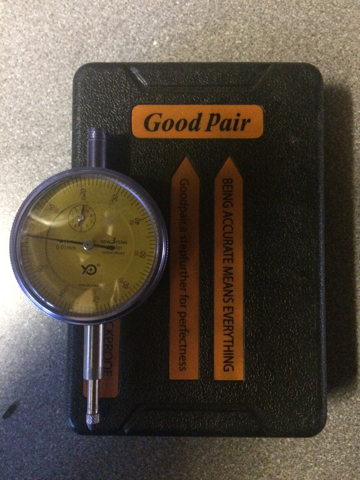

    Then there’s my dial gauge called ...
    As it says on the box I believe we should all strive for “perfectness” when fettling our machines.
