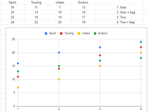

  13. Not sure if this is worth it to anyone, but after setting the front manually, this is what I've settled on in terms of rear preload for a 1260 S GT, I've yet to test these settings, but the graph certainly helped make it clearer and a few of my settings were way off.
    Note, I'm 14.5 stone (2 stone over what I should be mind you...) at 6'2" tall.
  14. I'm a bit confused, I didn't think there was a manual intervention to set pre load on the rear shock for a 1260 ?
  15. There is no manual adjustment for the 1260 S versions (Skyhook systems). Rear preload is via the dash in the suspension settings.

  17. Does anyone have the 1260 sag measurements? Both with and without rider? And even better, with pillion?
  18. I'm interested in this too. Is there somewhere we can see the settings for rider weights on the 1260, as the manual just has generic instructions?
