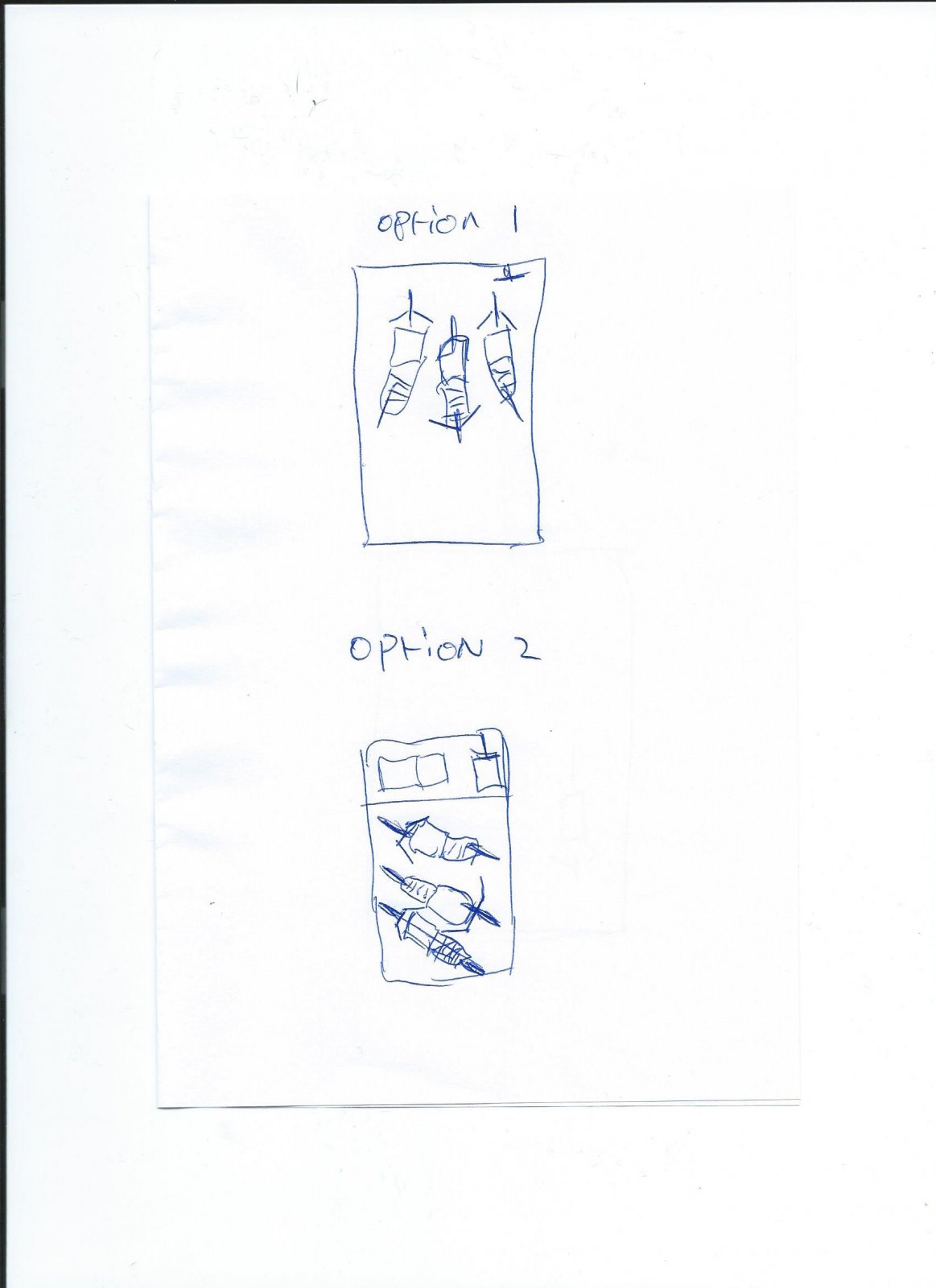

  14. Two go in facing forward, strap the fronts down, swing the rears to the side and put third bike in rear end first or put them in at an angel in the van with the front facing one way then the next with the rear next to the front of first bike third bike front facing rear of second bike, using blankets or foam keeping bikes apart, At the angel option jam tyres to side of van, dont forget you got to get kit, tools fuel and food maybe fold up chairs etc in as well. A really rough sketch to try an help. When i was a member of street specials and we had a display at Sheffield we used a luton van, i think we had 5 or 6 bikes in the back. many years ago. Oh yes I dont recommend when loading the bikes in the van using engine if you are not use to it as i have seen so many people panic rev the bike up only to have it spit the plank/loading ramp off the van with bike on top of rider/owner reving its nut off. You can do a lot of damage to a bike like this so push it in. Also keep the weight of the bike against your body when tying down so you dont lose the bike ie falling away from you, causing damge to bike and damage to hire van which most company's will charge for. Hope this is of some help Scan.jpg

  16. Thanks, and love the drawing :)
    Sent from my iPhone using Tapatalk Pro
  17. Clearly the artist of the forum
