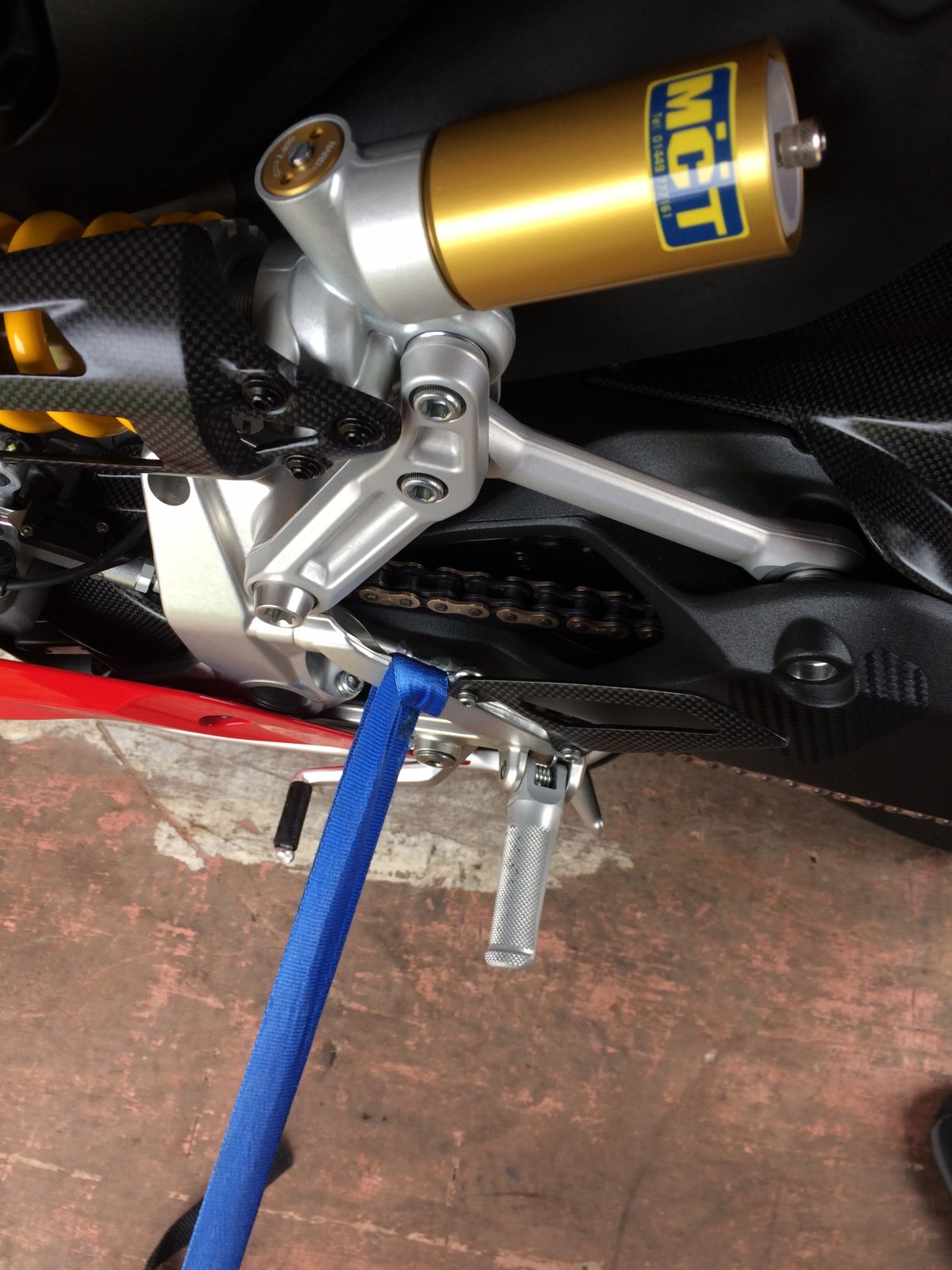

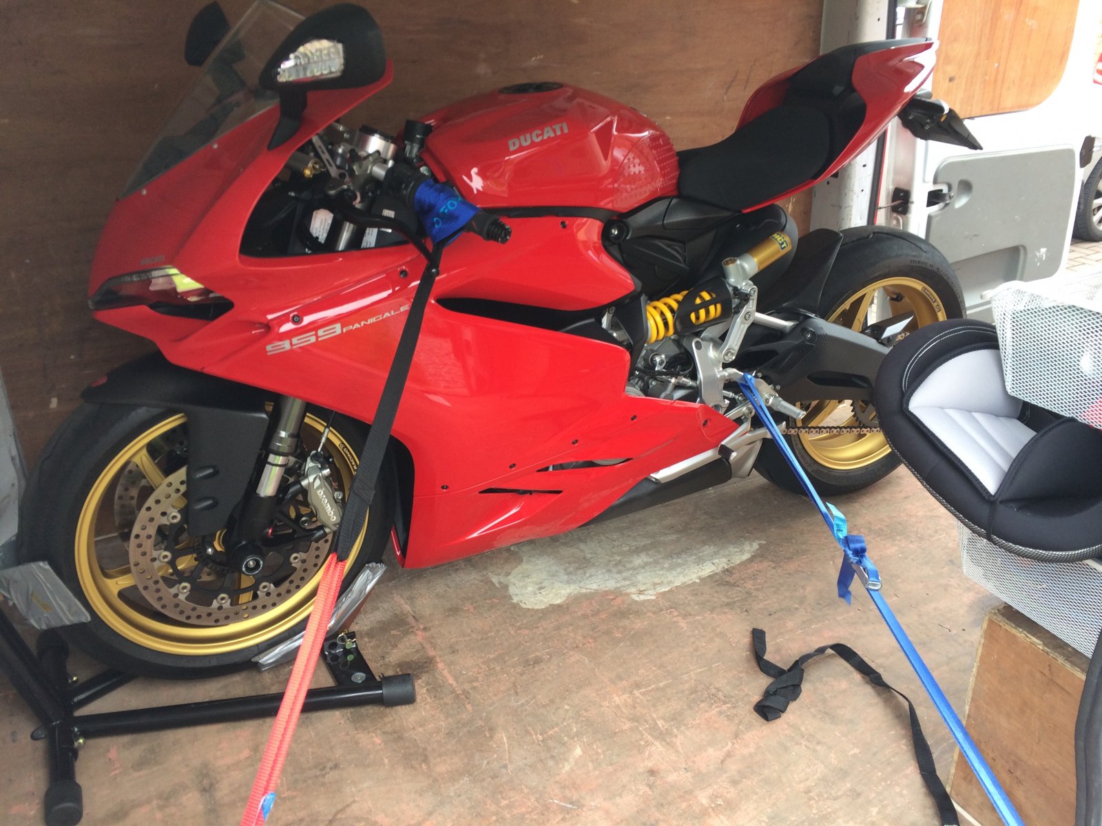

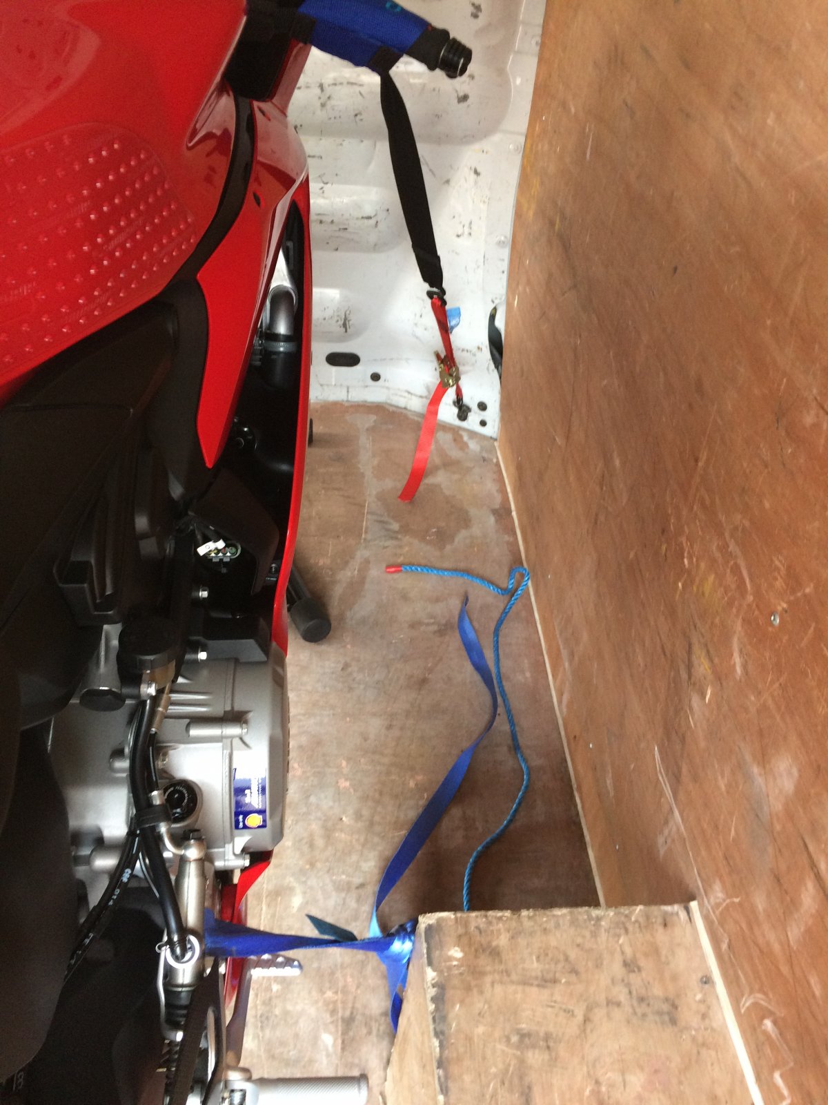

  7. Here are how I do it
    Was thinking of getting eyebolt for where pillion pegs were to anchor to subframe but touch wood this has been fine so far
  8. You'll be lucky to get two bikes in strapping it like that. :)
