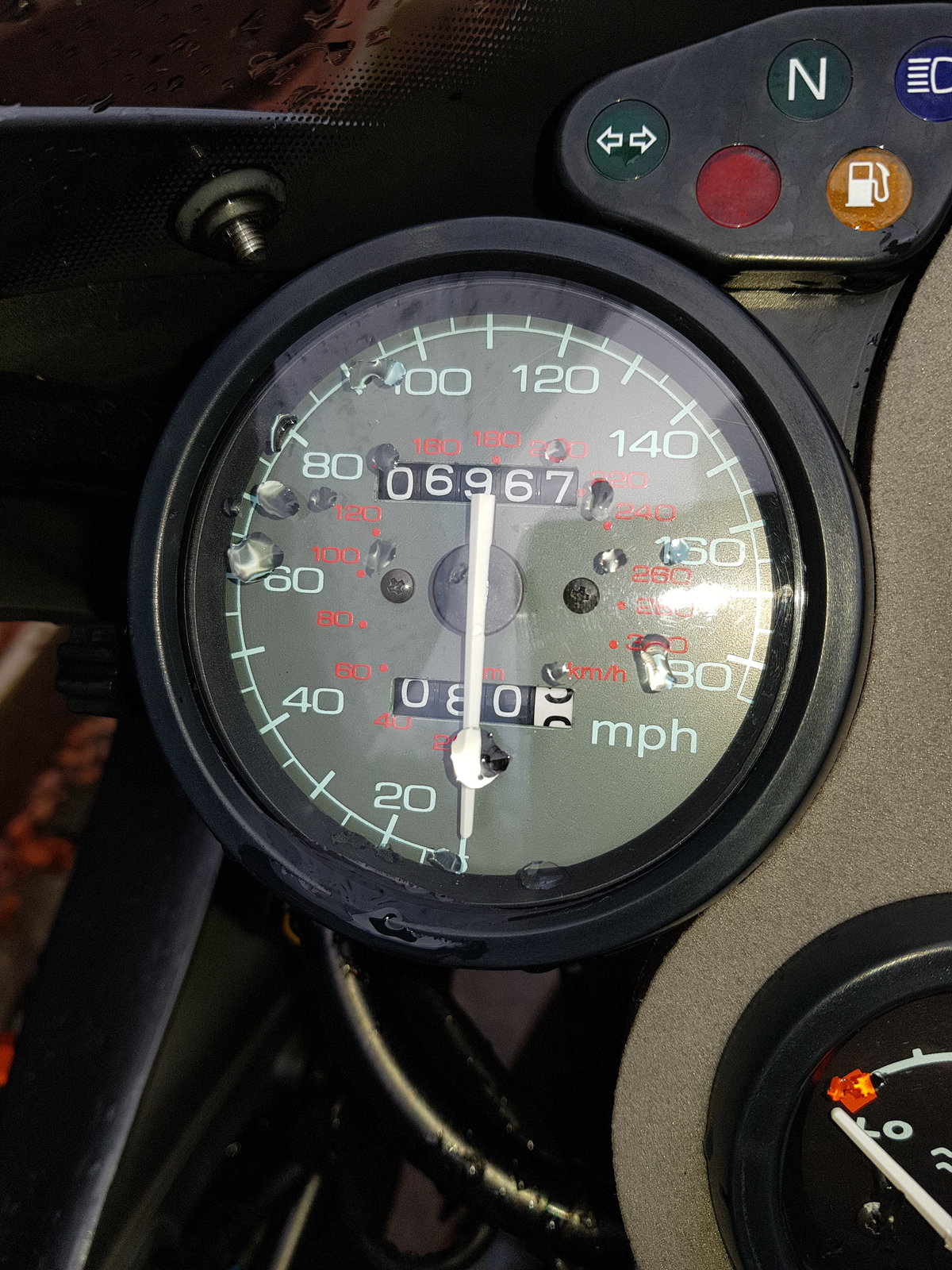

  1. So today I discovered my trip meter is in KMs and Speed is in MPH?! It's a UK bike so I need miles, is there a selection switch or something. Maybe some drunk Italian assembled it back in 2002 this way just to mess with someones head?

  4. It's a mechanical unit for the SS ie. I thought the tank had super capacity until today when mates bike had 60 and I had 100 odd. Worked it out that his was indeed correct. Weirdest thing. Dial says miles FB_IMG_1501439972215.jpg

  6. proper odd! Is it just the trip meter or the odometer also?
  7. Turns out the Odometer is KMs too! Speed is definitely MPH. Strange
  8. In that case then, I suspect its a KM/H unit that's had a MPH card put on the front(where the 2 screws are)
  9. Hence, a possibility that your bike was not UK supply originally ??
  10. Well then. That's means my mileage is a lot lower. Awesome. The card looks very good quality as I thought it was original. It goes up to 180mph and the ones I've seen on eBay are 160 and have CEV printed on them....

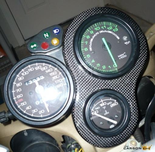

  12. Does look a different top card compared to this 2002 from Google ??

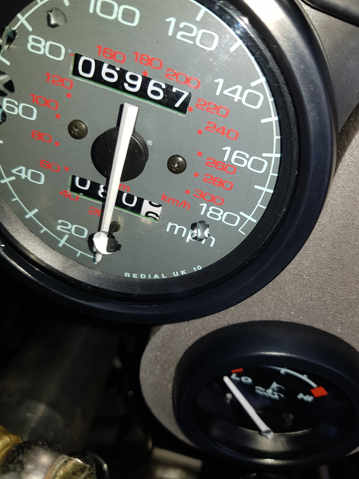

  14. Mystery solved!!!! I have a low miles example then. Bonus!!!! See bottom of dial FB_IMG_1501443443969.jpg
  15. Couldn't read it from normal angle
  16. So it is a different card then ?? I accept cheques or cash :upyeah:
