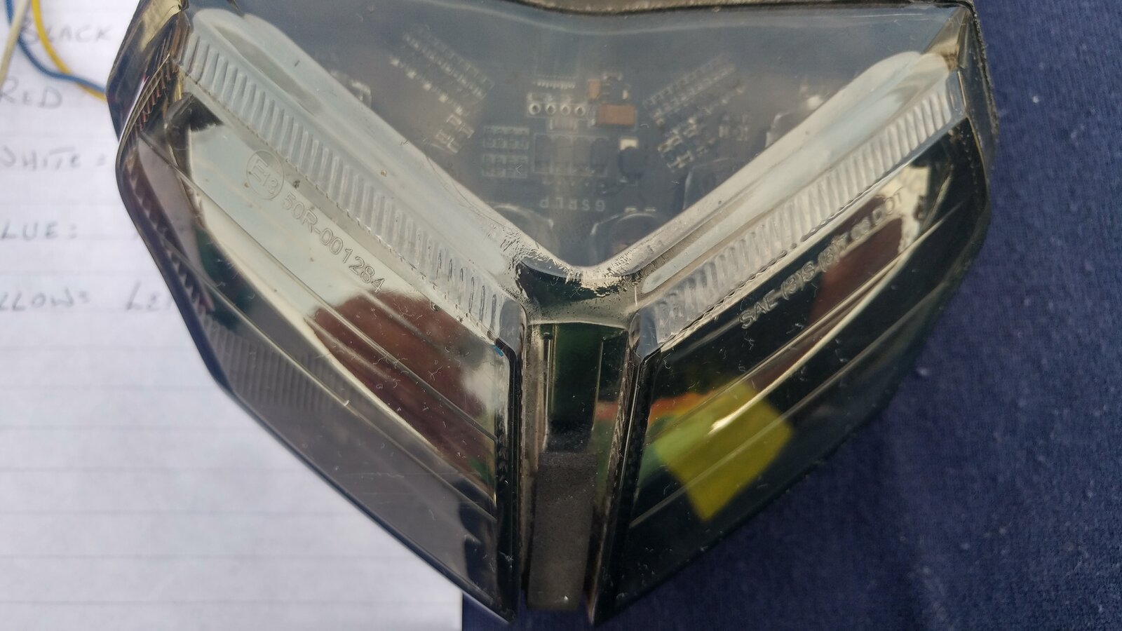

hi chaps Anyone using the TST Industries integrated brake light? https://tstindustries.com/tst-led-integrated-sequential-tail-light-ducati-848-1098-1198.html Also, any advice or links to LED front lights, inc indicators, side lights etc? Mines is an early 848. Thanks

I went and measured the gap. From the right indicator to the left (TST). Am out by 50mm. Hopefully won’t be picked up on. Have you got the TST setup?

I have the tst rear light and it's a good piece of kit but the advantage here is we don't have the annual mot so nothing to worry about there.
Got the Brakers set up with the TST on mine, but only as a stop light The TST tail light is the best I have seem IMHO On the Brakers I found the control box a bit flimsy and the wiring loom between the components tight, it all worked in the end but it was a little bit of a faff As I recall for the Brakers lights & indicators to work, the lights have to be on. Not a problem for most but I have the lights modified so I can switch them off, really just for maintenance if I'm testing something but it's just for info Here is just a short vid of the bike but skip to 2:20 to see the tail light and Brakers Unit

I use the TST unit, but I also have a set of motogadget m.blaze edge as well - so there are lots of brake lights as well as the indicators. My first MOT didn't like the TST unit (quoting the seperation) and I pointed out as they were secondary indicators the rule didn't apply - the swallowed that quite happily. Really tidies up the rear end without breaking the law (even a little bit..)
