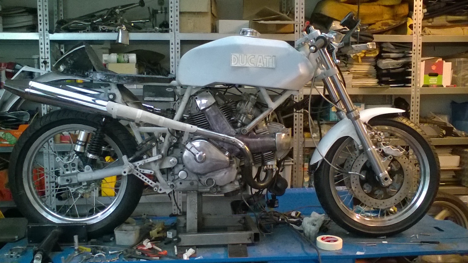

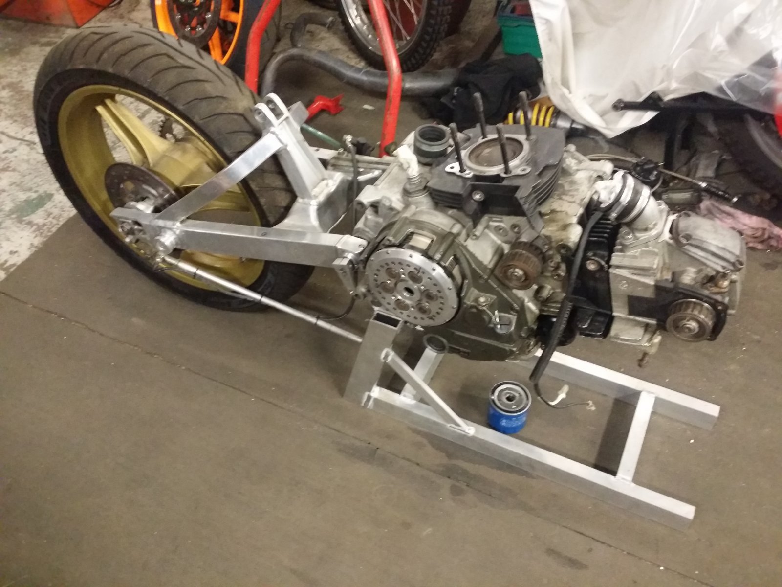

  1. Quick update on the f2,just checking the valve seats on the modded rear cylinder they are both spot on after 2 seasons running but we did find a loose valve guide which was under sized to the stock one,i never checked the size when i got them.i knocked this stand up to make the job easier,3 engine boots and lift the chassis off. 20160329_190346.jpg

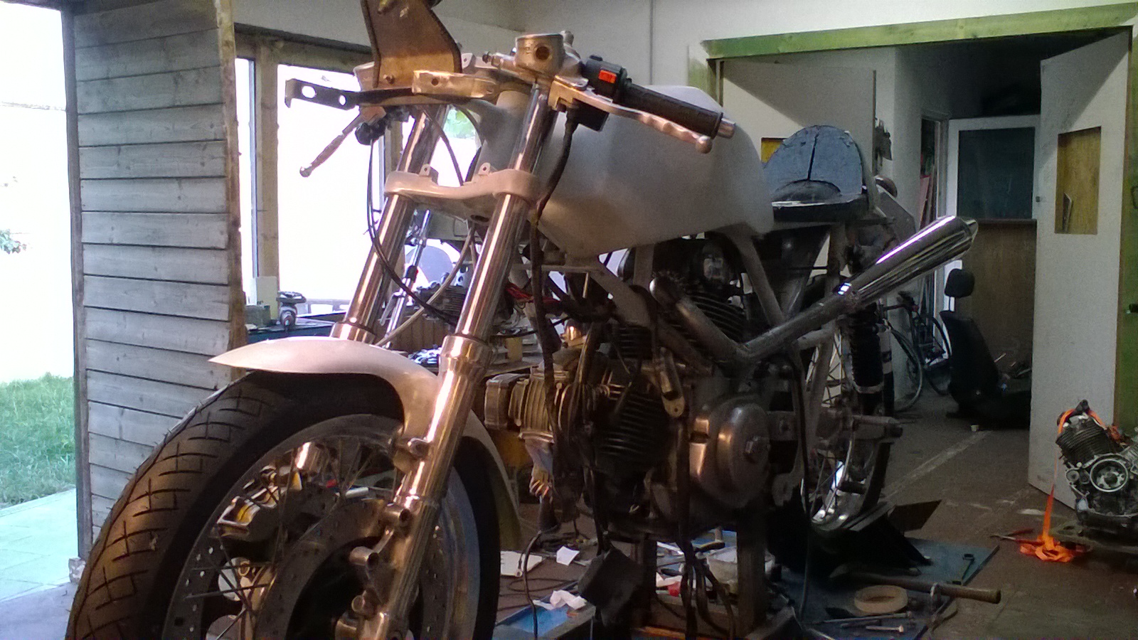

  5. hello, also new on the forum, did something similar and used kawasaki ninja 6r forks, guzzi front hub
  6. They look good hendrik,any more info on the bike.

  9. They are 41.7mm BMW K100 yokes and stem this is plug and play in my converted allazurra frame, front wheel guzzi, rear wheel husqvarna, tank is pantah but i changed the shape (cutting,welding) i also did the reversed head conversion but its a M600 head (with the smaller valves its relativeliy easy), however due to the fact its desmo the valve deck position in the valve seat is critical for valve adjustment. lucily the m600 heads are quite cheap for experimenting...
