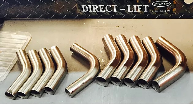

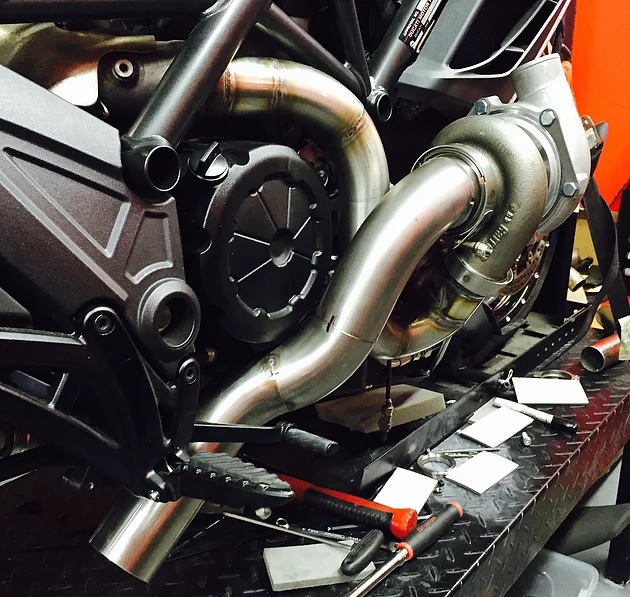

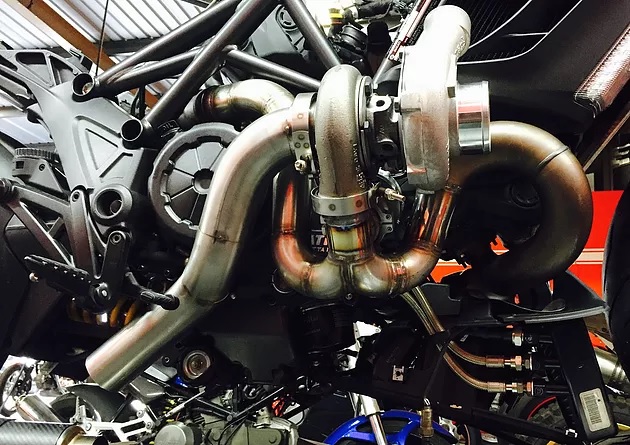

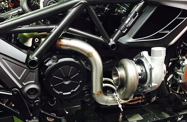

  5. Excerpt from their blog and some pics of build:
    The fabrication process began with a call to the local stockist for Garrett Turbocharges to enquire about size options, we were lucky enough that they had exactly what we wanted. Once we had the turbo in our hands we were able to work out what diameter header pipe we required and it was now time to place an order for the stainless steel mandrel bends. Once we received the bends it was time for the fun to begin.
    Justin entered the fabrication room and we left him in the zone for the rest of the week, by the rest of the week I mean it was safe to assume that he wouldn't be home for dinner most nights. When he finally resurfaced it was time for a mock fit up. Those who know Justin know that he doesn't do things by halves and what is a 100% perfection to others is always a challenge for Justin to push it to the next level so we watched him re-enter the fabrication room again for some additional tweaks. Once he was satisfied with the pipe work and had fitted it all to the bike it was time to move on to the intake plenum.

    Lovely bit of welding and pipe work though. Mechanical porn
