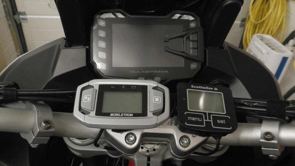

  6. I've fitted the Mobiltron motorcycle TPMS. It's not particularly sophisticated but works and is relatively cheap (at £99).
    I use the standard internal sensors which are rather crudely are held inside the rim by big jubilee clips. Valve cap sensors are available but I don't know if they'll fit on a Multi.
    The display unit shows pressure and temperature, with no attempt to correct the pressure for temperature. There is an alarm feature, for low and high pressure plus high temperature (see manual for details). I've connected the display unit to a switched 12V supply (shared with the Sat Nav) and mounted it on the handle bar clamp with 3M Dual Loop. The sensors have an internal battery (3 year life), so the pressure is displayed after then display has booted up.
    I've found the system very reliable and accurate. I find a TPMS useful for checking the pressures before I set off and for making sure I've remembered to increase the tyre pressures when carrying a pillion.

  9. Great, thanks. Do you have a picture of the handlebar mounting?
  10. Here you go. The Scottoiler eSystem display is mounted on in the same way. I can't see the displays when I've got a tank bag fitted, not without leaning forward anyway, so this limits the effectiveness of the alarm function.
    The 3M Dual Lock (available on Amazon and lots of other online re-sellers) works well for this sort of application.

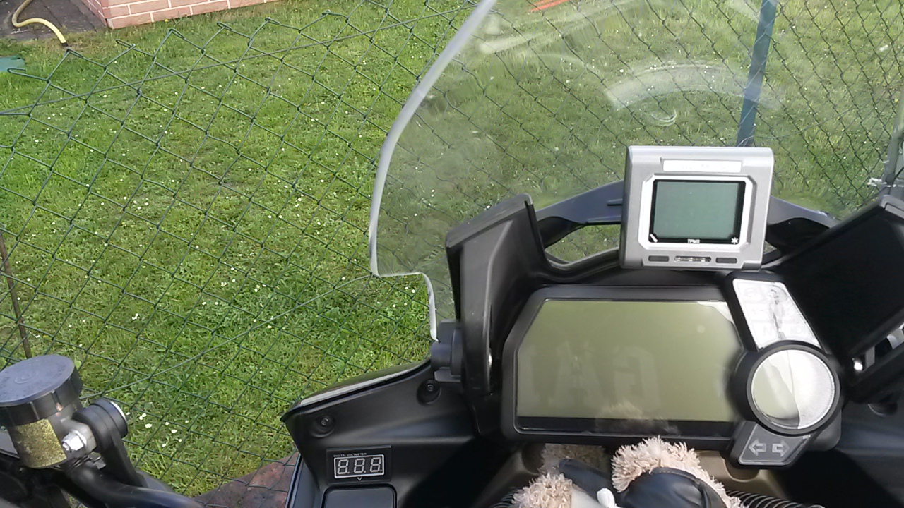

    I use this type. The little display is mounted on the handlebar clamp and wired to come on with the ignition. Easy to check the pressures before during and after each ride. Shows how much pressure goes up with temperature. Flashes red if there's a puncture. It's simple, helpful, and reassuring.
