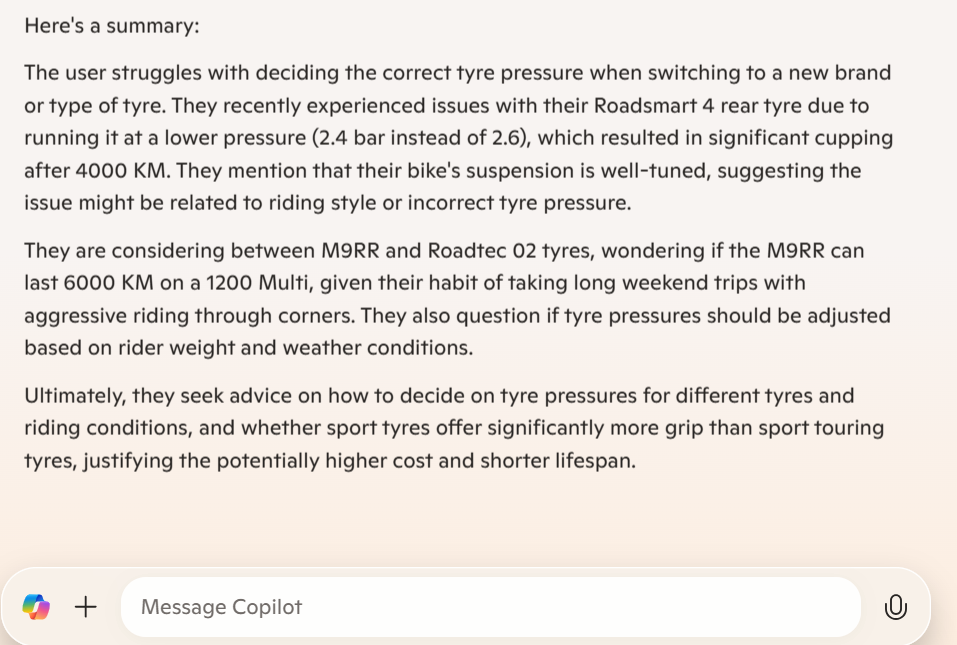

    I got a bit lost in your post - so I have asked Copilot to provide a summary that gets to the point (extracted below).
    I believe this to be too complex to provide an answer that covers all tyres.
    May I suggest reding the tyre reviews in magazines and online. With the help of translate you can read English, reviews as easily as German, French or Spanish. You may be able to track down the characteristics of individual tyres.
