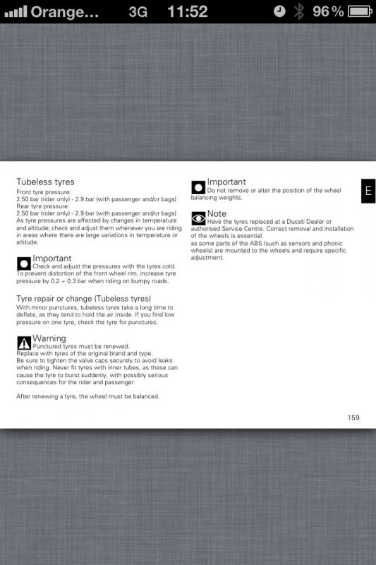

  1. Can anyone tell me the correct tyre pressures for the Pirelli Scorpions fitted to the Multi 1200 ABS.
    Amazingly the owner's handbook doesn't seem to supply this information.
  2. The 'S' models are 2.5 bar front and rear. That is 36 psi or 250,000 pascals (!)
  3. It is in the manual albeit very small
  4. Thanks for that. Any idea is it mentioned anywhere in the owner's manual?
  5. Thanks Jase1
  6. That is from the owners manual it is a PDF version but same thing. Page 160 I think it says.
