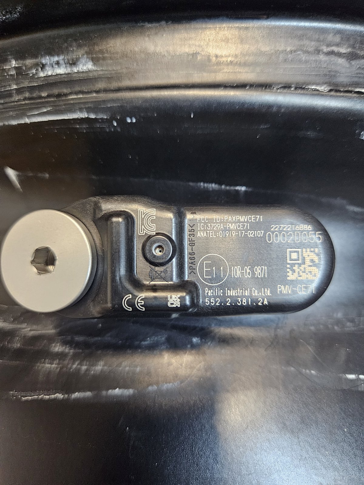

  12. Are those sensors any different to the ones used in cars? I just replaced the ones on my car with a set from Ali express. £23 for 4. No coding necessary, just fitted and they worked.
  13. Exhibit A, m'lud!
