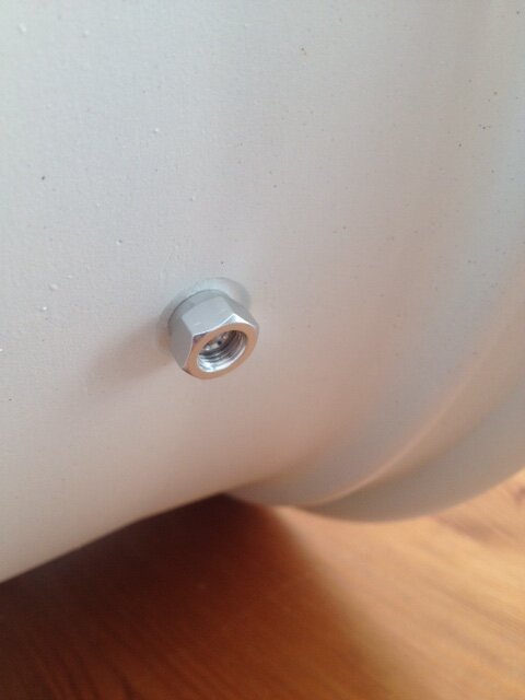

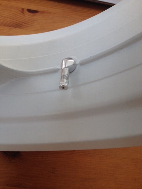

  6. Well I've gone and done it, after analysing it to death. I think I prefer the original black plastic caps, which I thought I'd ordered, but they turned up with these instead. Half the thread is exposed when the caps are fully wound in, so they're bound to accumulate crud..

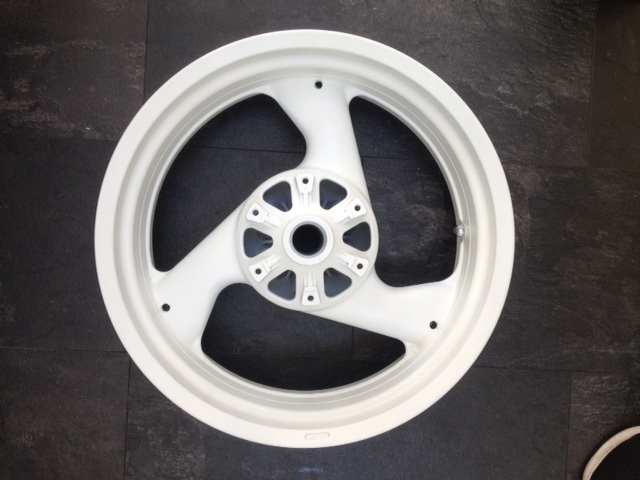

  7. Wheels look amazing! Love newly painted/powdercoated parts
  8. Wow, look a bit short on the inside, surely the threads should come at least to the top of the nut! Are these really genuine Ducati????
  9. Thanks, but they aren't great TBH. I made the decision that I didn't want to hoik out the cush drive rubbers, and because the recommended powder coater didn't work to RAL codes, I decided to get the correct RAL 9016 paint and do it myself. This was a mistake I think, and a poor decision on my part. Although, I did really enjoy the process of painting. Same for the frame.
  10. These aren't genuine Ducati. Again, another poor decision..

  12. If a tyre valve fails you get a very rapid deflation akin to a blow out, the rule of thumb with threads on fixings is that at least one thread should be visible past the nut, clearly not the case in your photo CK, don’t use them, here’s what happened to me, I bought a second hand Fireblade, it already had 90 degree valves fitted, not the metal base type as above but with a rubber base with a brass 90 degree valve stem, I was doing 70 on the A38 when the bike pulled slightly to the left, I went to correct it but the bike felt like it had a rubber frame, I slowly rolled the throttle off and didn’t touch the brakes, I was approaching a bend in the A38 but as luck would have it the slip road to Ripley was directly in front of me, this allowed me to continue slowing without having to change direction, as I went into the slip road the bike was tank slapping, came to a halt without falling off somehow, got off the bike, front tyre was completely flat, the valve stem had ripped out of the rubber bung causing very rapid deflation , trying to save money on valves, tyres or brakes always needs careful consideration.
