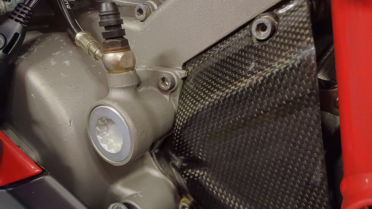

  14. 20250308_144416 1200x675.jpg Here's a picture of it taken just a few weeks before the swearfest descended.

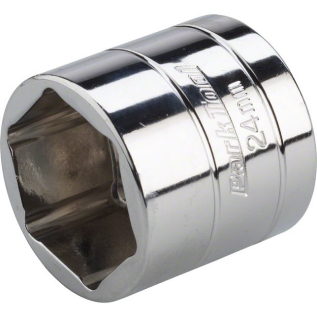

  15. Got a pic of what it looks like now?
    Have you got deep 6-point sockets?
    Like this, but deep:

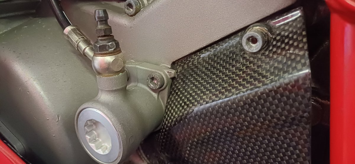

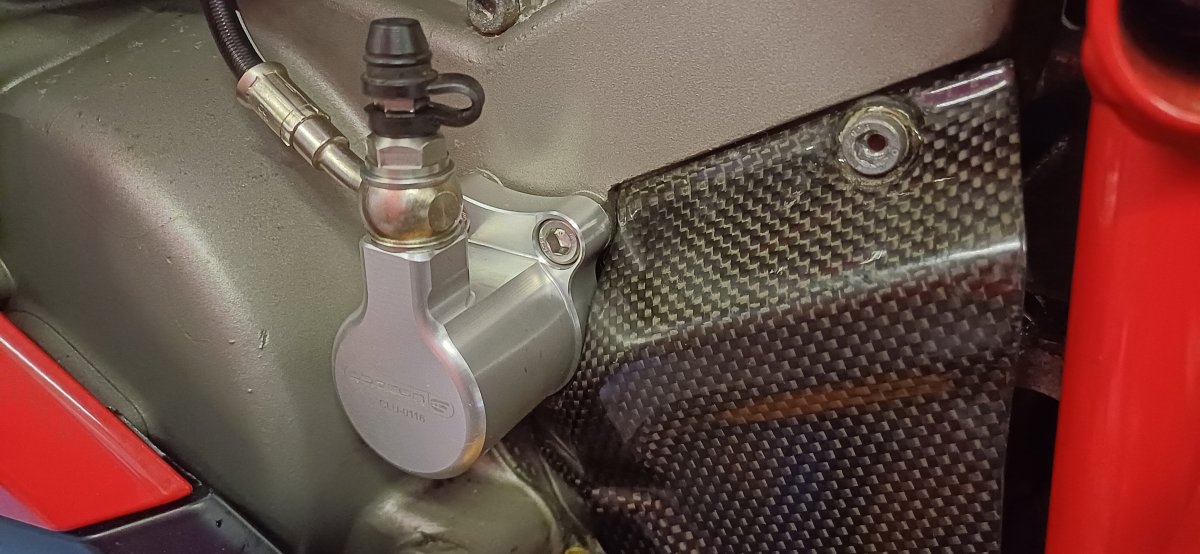

    I will add that on the Monday or Tuesday I sprayed some penetrative oil in preparation.
    The socket went on after some persuasive taps, no doubt because of the burring I'd inflicted earlier.
    The sound of that crack as it gave way was very satisfying I must say.
    Went out on Sunday with no issues.
    Thanks again.
