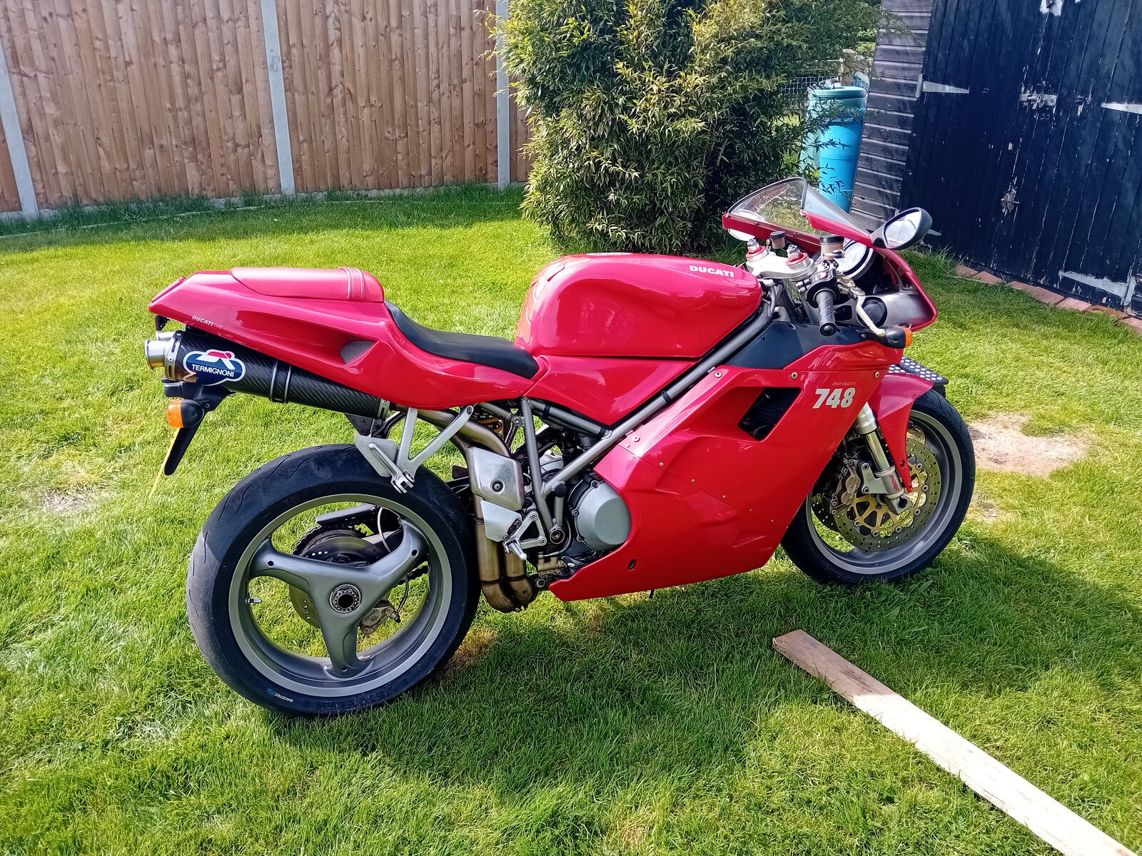

  1. Hi everybody, I have started to gather some parts for my 748 reinstatement, new battery and some Metzelers have arrived,
    Hopefully come next month we can get back on the road.
    I bought it in 2002 for £7250 and its been stashed for years as I bought a Hypermotard but kept it .
    Its time has arrived.

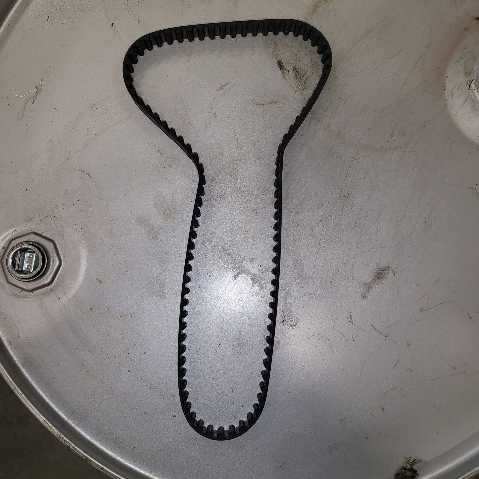

  2. Don't forget belts if it's been sitting a while.

  10. A big step nearer on getting one of my better buys back otr, it's off for belts etc , I just havnt got the facilities to do it here.
    I looked at the service history and its super no expense spared,
    I've have all the books ,reciets complete tool kit ,original plate from 2002 original end cans I've cleaned and boxed up as stay with the bike .
    Hopefully next week it's back otr

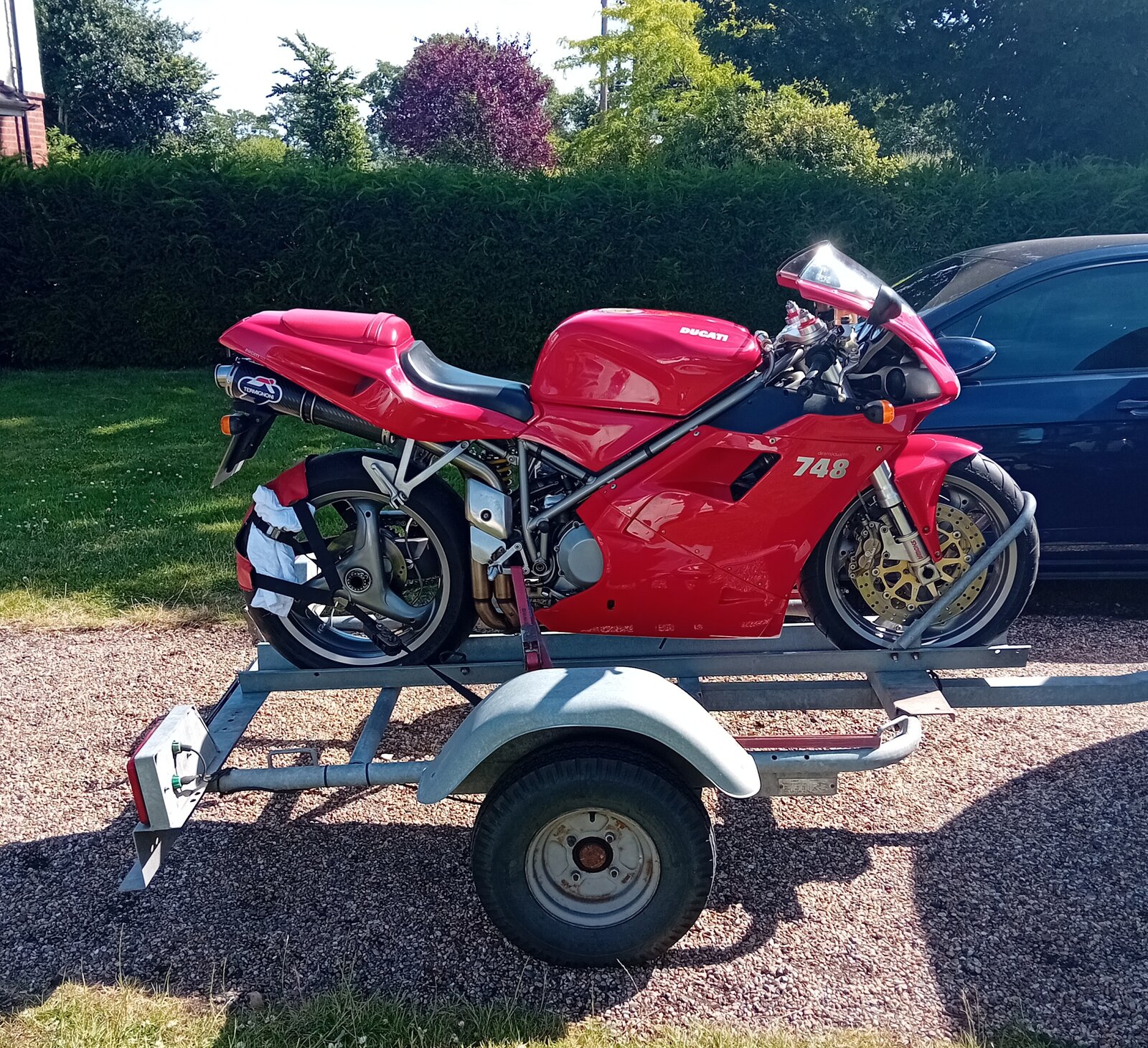

    My 12 years off the road 748 is
    Reinstated
    Serviced
    Taxed
    Mot
    Insured &
    I don't think I can collect it until Saturday..
  12. You taken it to Glen, Moto v
  13. Thought it was i could tell by the wall and path, i really must get out more :D
    #13 Roadtrip, Jul 7, 2024
  14. Absolutely, mega job putting a old Desmo back otr
    #14 Jay Blake, Jul 7, 2024
  15. I think it will probably piss down until then anyway.
  16. Can't praise the the service & work enough.
