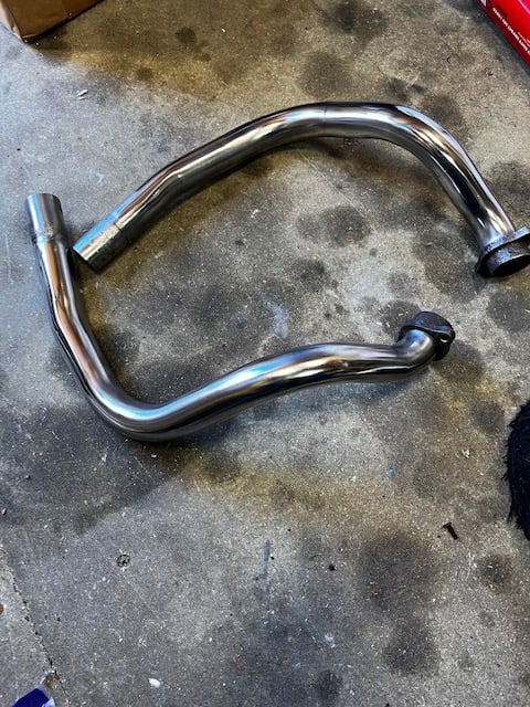

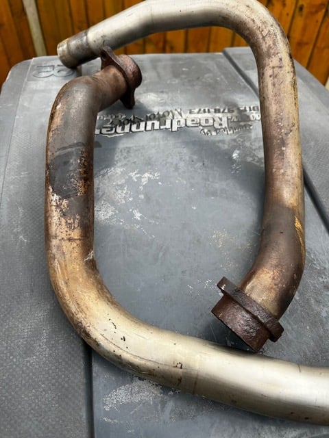

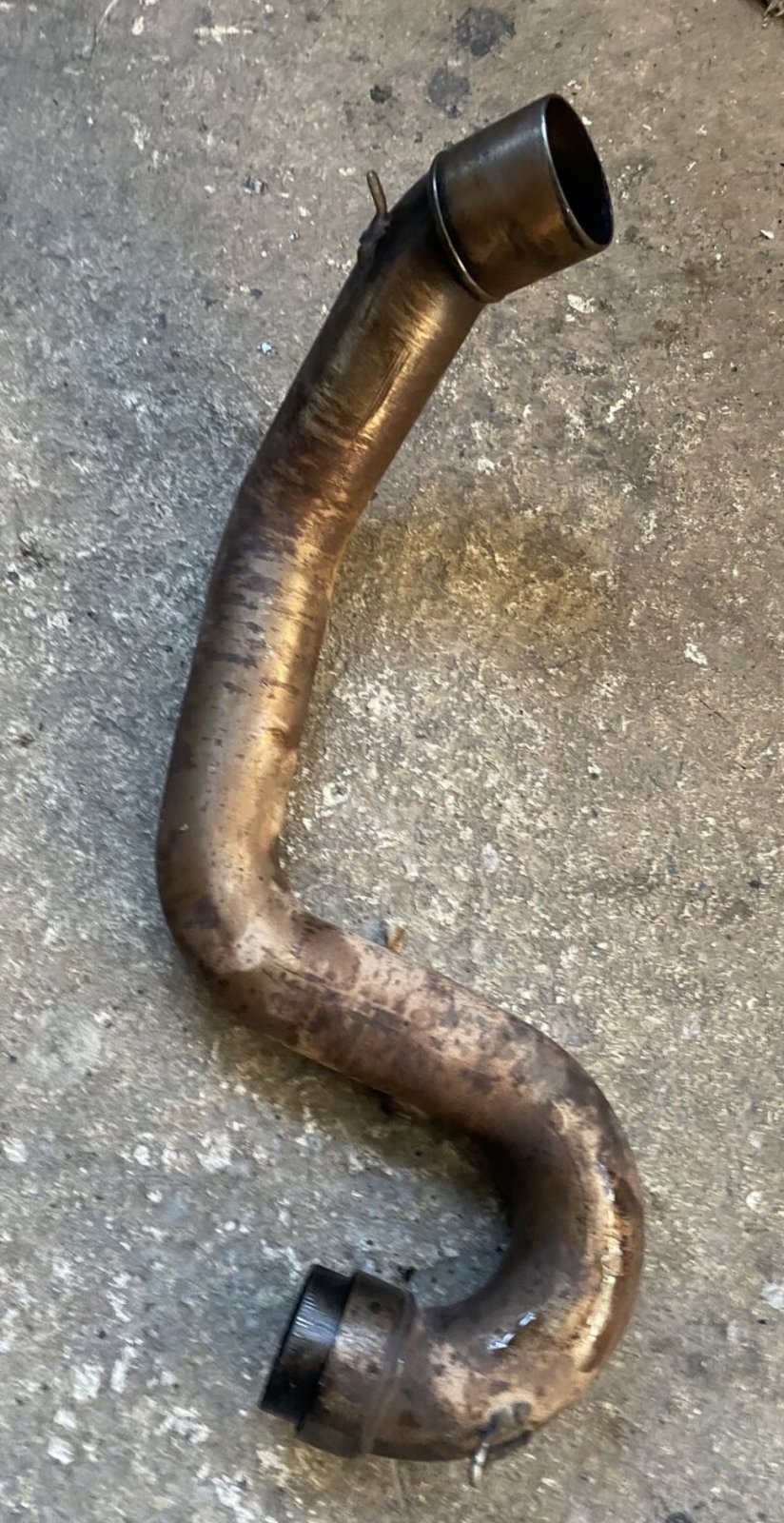

By chance, did this yesterday with Harpic 10x. As mentioned, rinse well with water and wear gloves. Before and after...

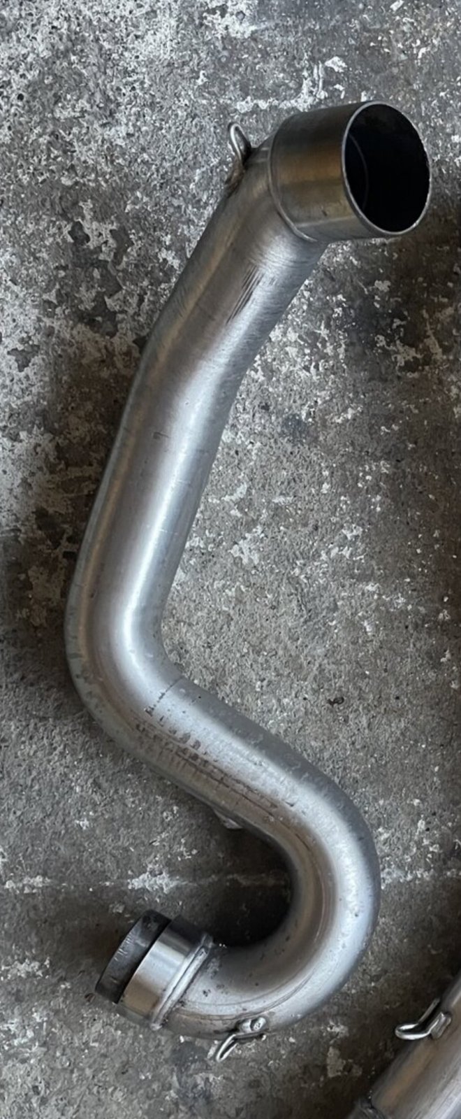

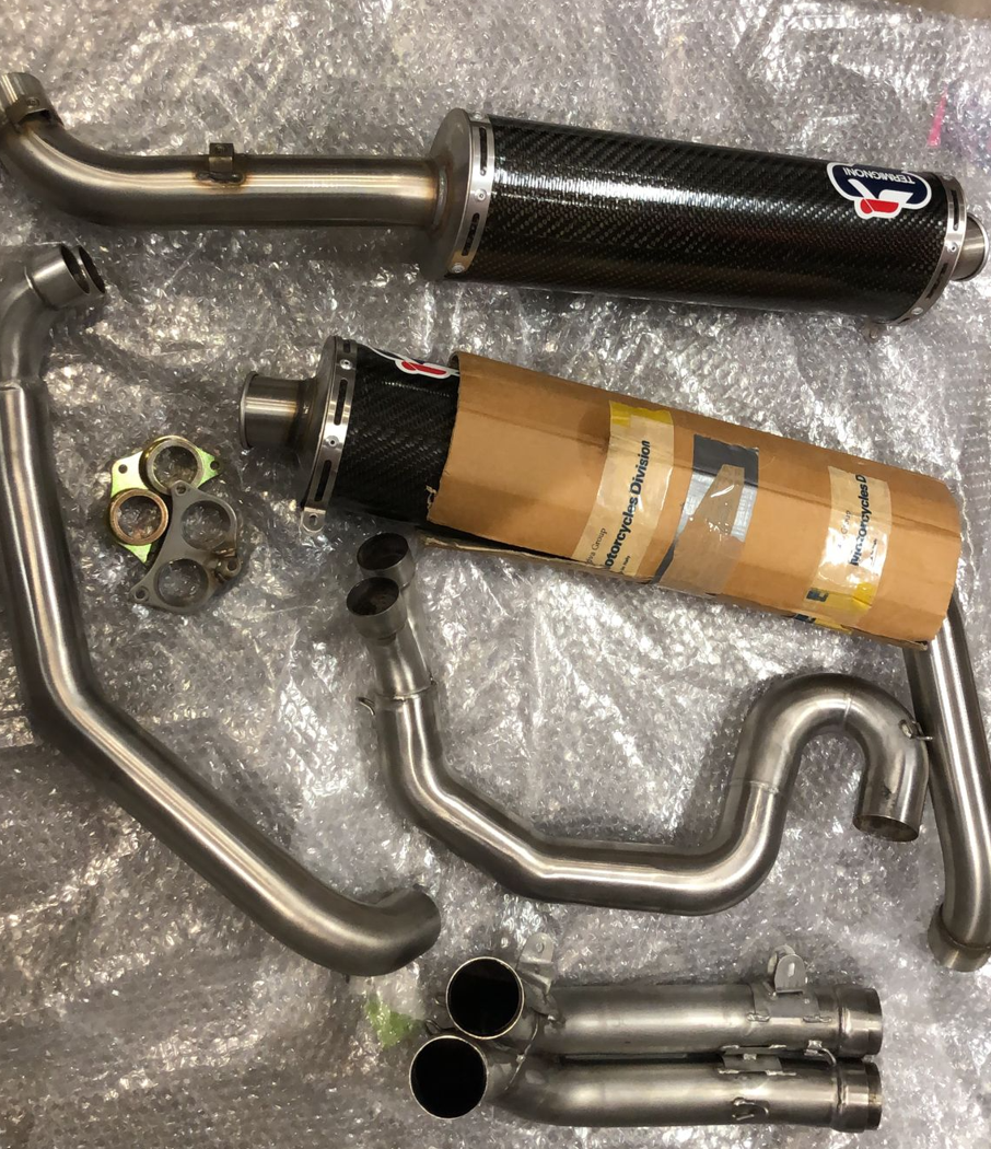

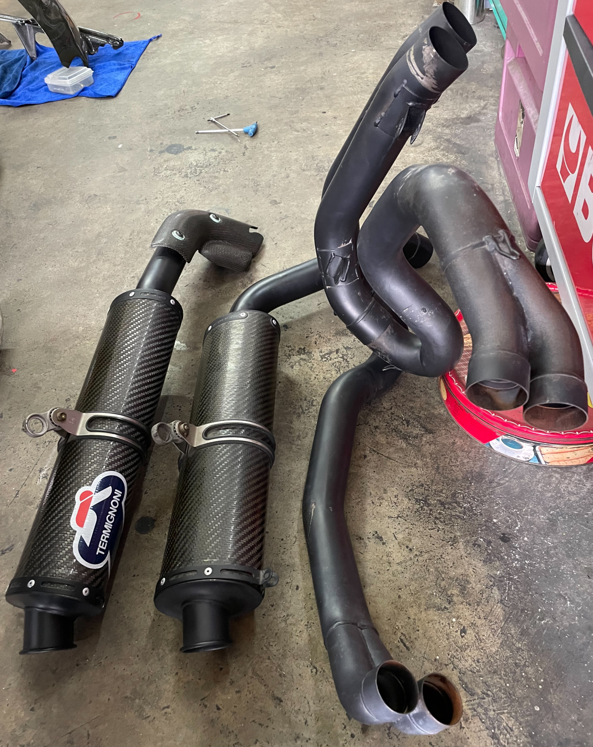

I dont have any better pictures of the dry ice blasted exhaust on hand, I can take some pictures when I get home next week. It looks exactly the same as Paul55 #11. It looks good, but I would like to polish it a bit more towards the OEM look. This is how it looked before dry ice blasting: 50mm system: I dont ride my 996 SPS and 916 Racing, neither are registered for the road. Occasionally I ride my 916 SP, but only very short trips. Thailand roads are dangerous, too hot for full leathers and I tend to drive too fast as it only starts pulling around 7000 rpm.

Brick acid.i did my 916 exhausts with it, here’s a before and after. They are as unpolished as you can get. Took me half an hour.
