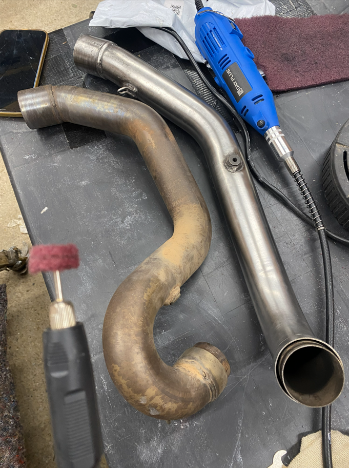

Hydrogen chloride. Used for dissolving mortar stains from masonry. And cleaning my spirit levels and tools. And exhaust pipes it seems.
