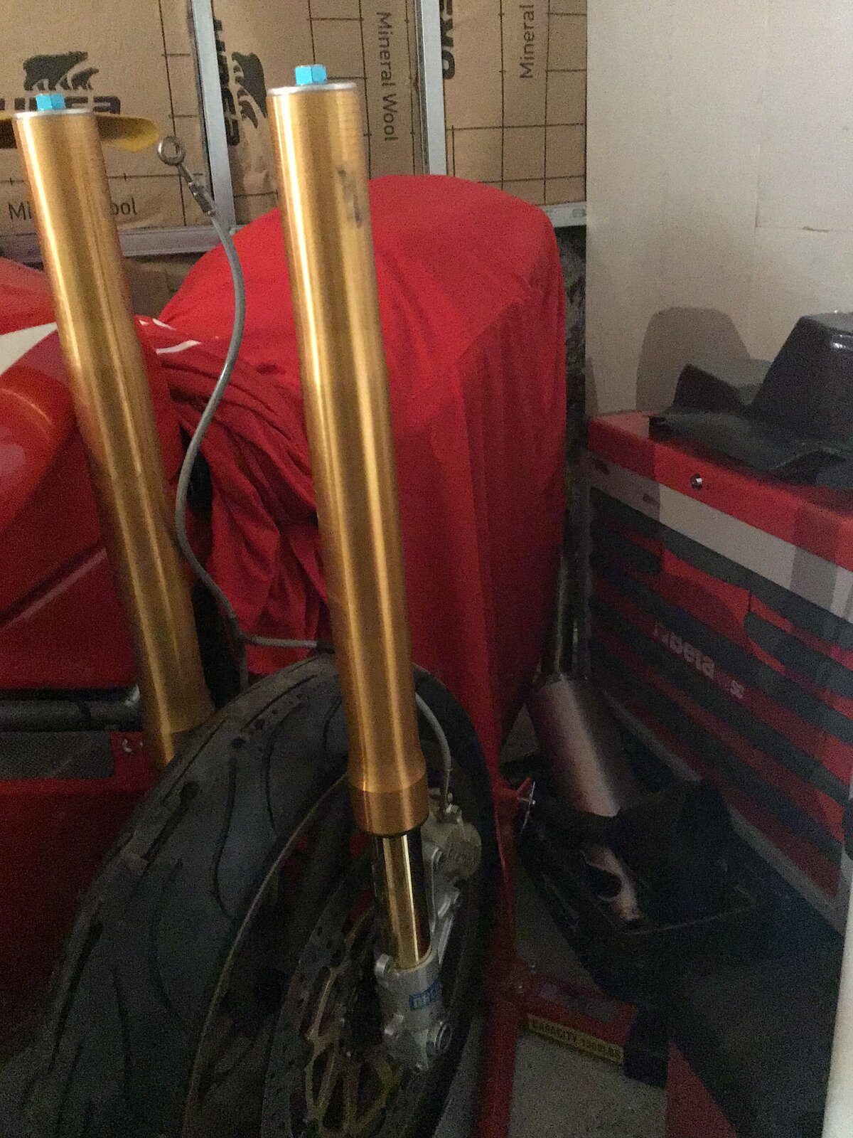

  10. FG 43's. No, I have no idea what mudguard it is off. It was very cheap, yet still good quality.

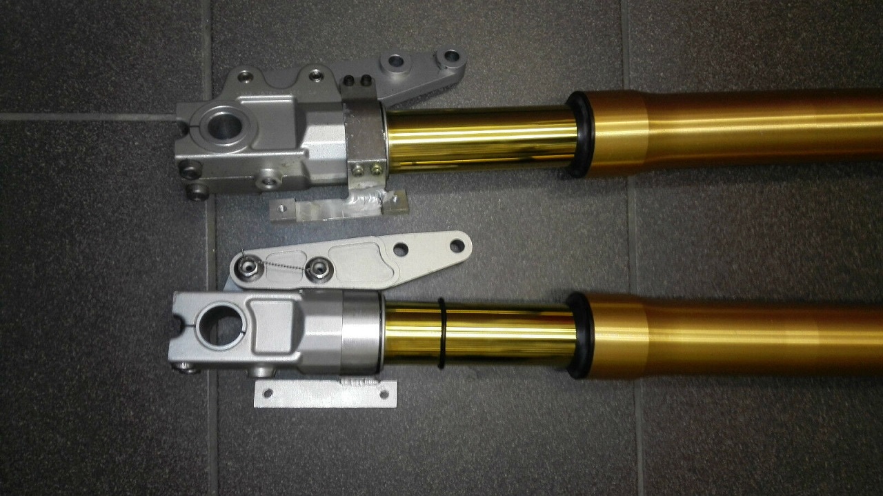

  11. thanks! but someone said to me that there slightly differences from oem ohlins (p. ex sps) and non oem ohlins. Do you know about it? Are non oem ohlins the R&T specifications or the ohlins from sps also R&T. Normally the sps are also Fg43 ?
  12. Thank you all for you messages, and your pictures :heart_eyes:

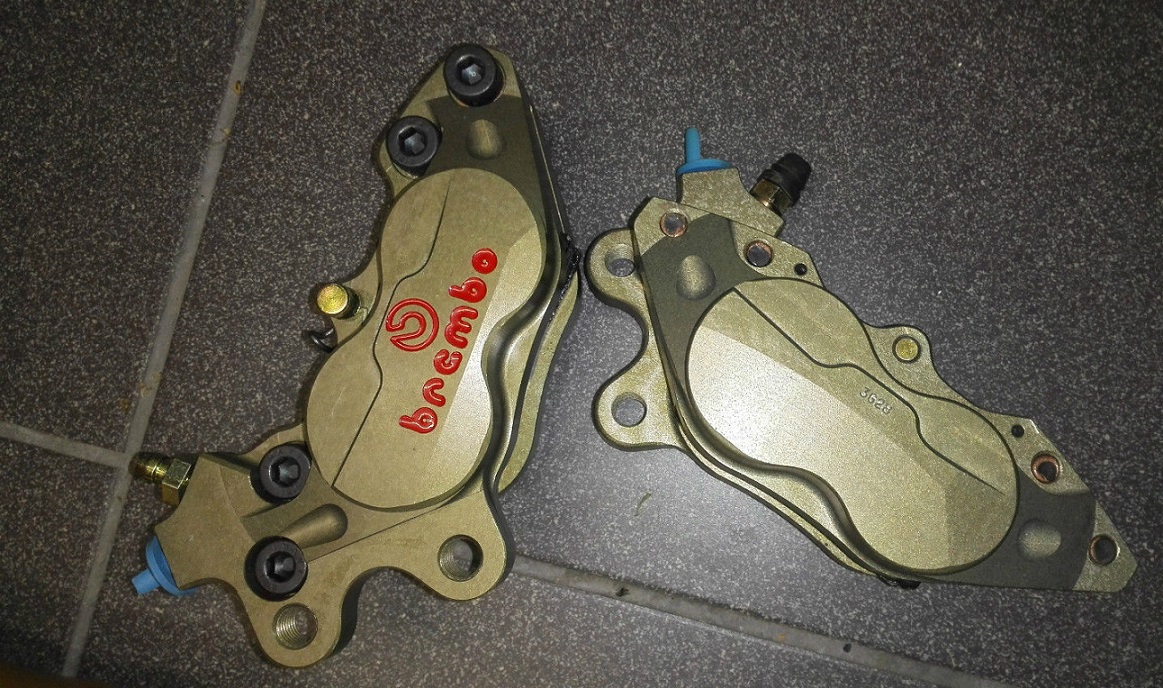

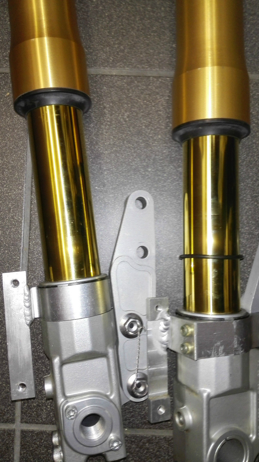

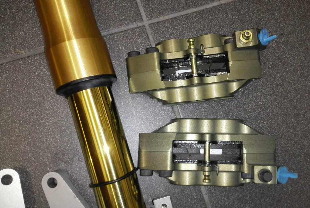

    Have found these, with a set of cnc brembos.
    Recently revalved, not in bad shape, and the price seems fair 2500eur.
    I just see the mudguard who is not original, and there's some scratches, not in the tubes and forks.
    What do you think?
    Cheers mates

  13. What I meant was early SP's and SPS's didn't ever come with Ohlin's forks. There are many different specs of Ohlin's and the ones fitted to later models are the base level of what Ohlin's manufacture - yes they are called Road & Track as far as I am aware.
  14. Road &Track Ohlins are not OEM. They are better than the baseline Ohlins fitted per OEM.
