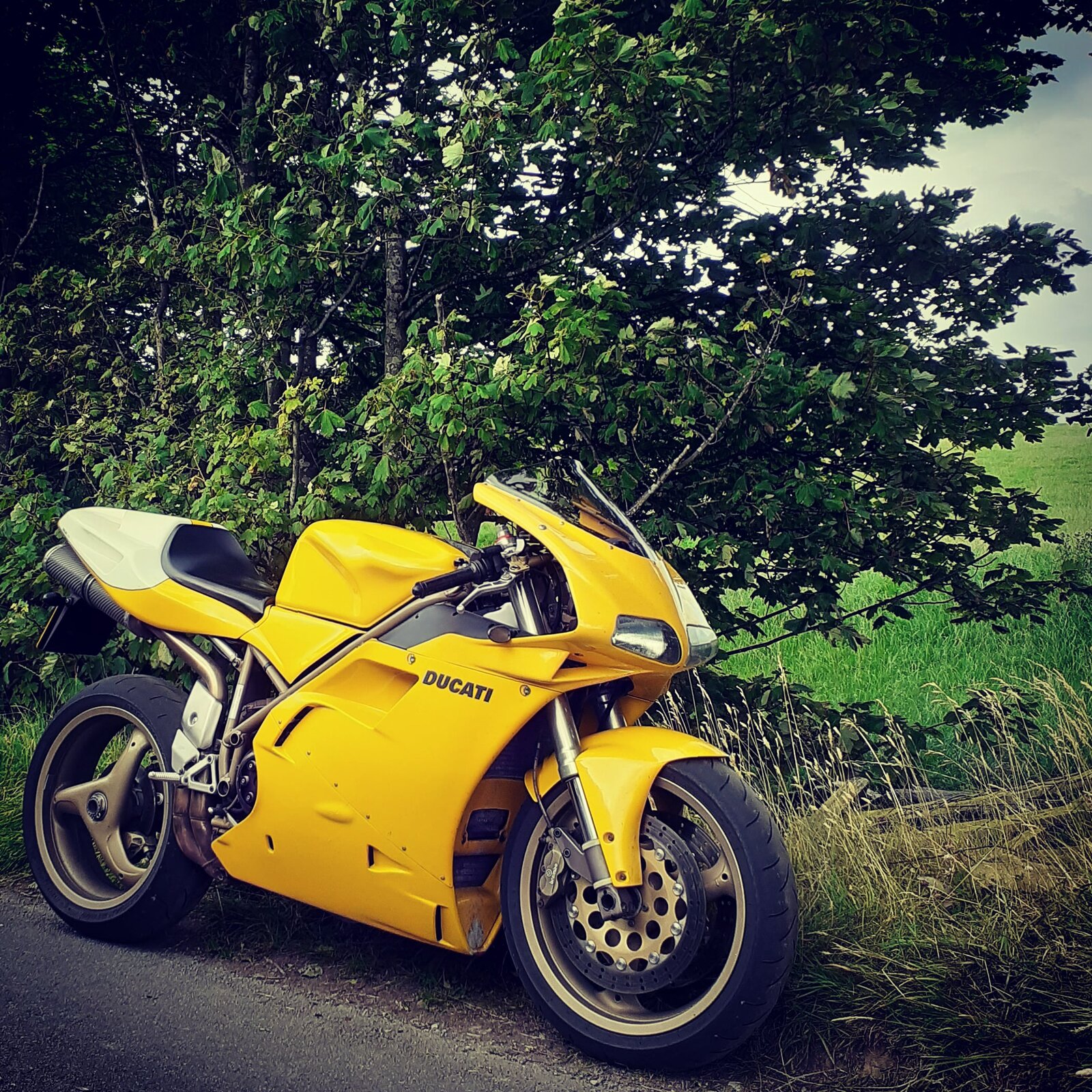

Just finished installing Exact-Start cables to my 916 and have to say i'm very pleased with the results! I've owned the bike about 17 years and it's always been a lazy starter. The difference after fitting the cables is huge. Just effortless starting hot or cold. I spent a very long time cleaning all the connections, which is key if you are going to fully benefit from this upgrade. All in all i'm very pleased and wouldn't hesitate to recommend this modification. I only wish I had done it years ago..
Great to hear! I am picking up a 2002 748s in Titanium Grey tomorrow and this is one of the first things I want to do. How was the install?
They were simple to install. The instructions they came with were very clear and only took about an hour to fit
