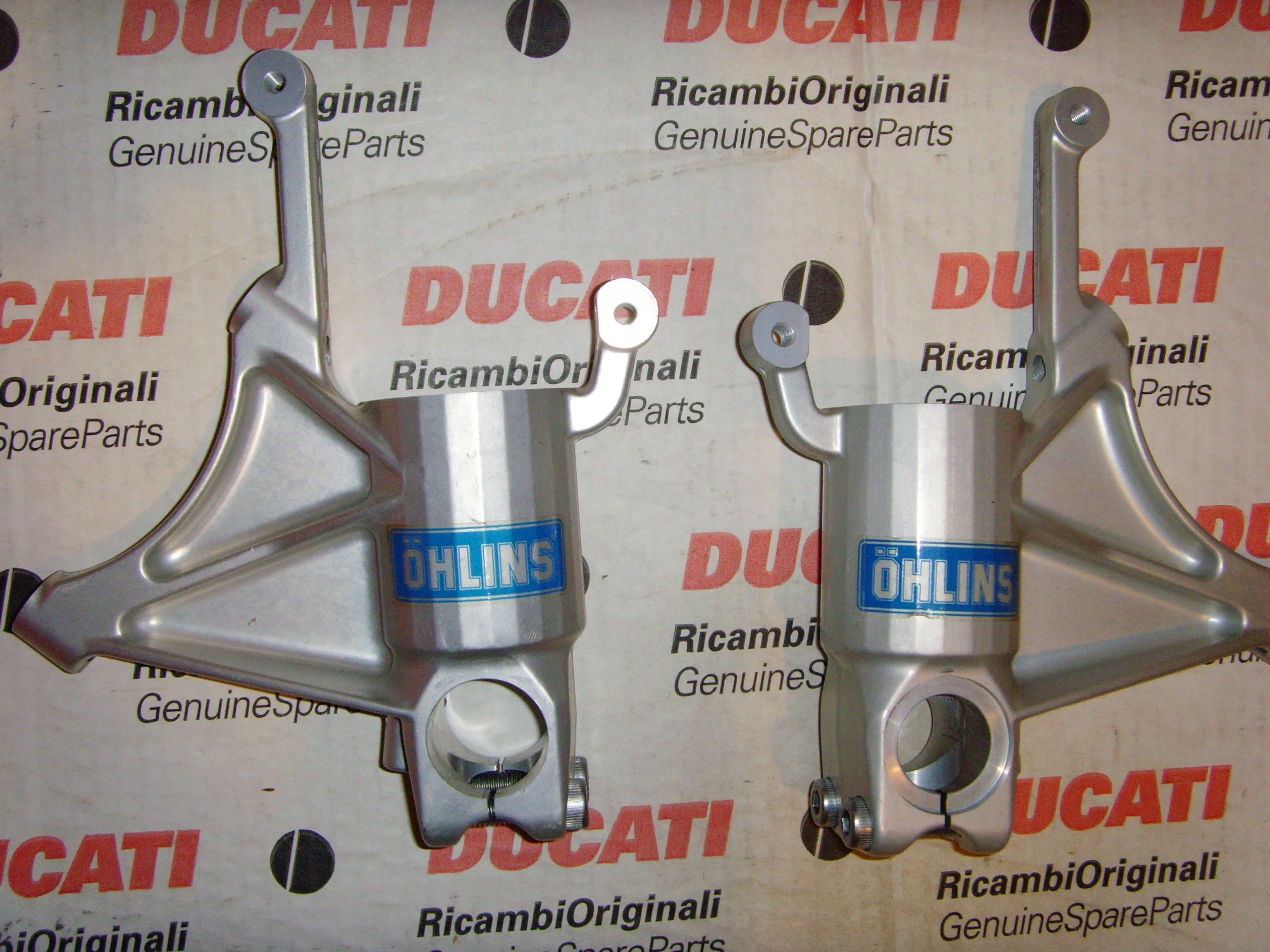

  7. Loads of options depending on budget and standard forks spec.848 radial forks ,999/1098 radial ohlins forks.Plus ohlins bottom yoke if your running showa as oe.
    Or swap fork bottoms via ebay ducati stores or Moto Corse,NCR etc.I was gonna go the moto corse route until I spotted some 999R ohlins radial fork bottoms for sale.

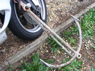

  11. one option...for better 'anchors'...:D
