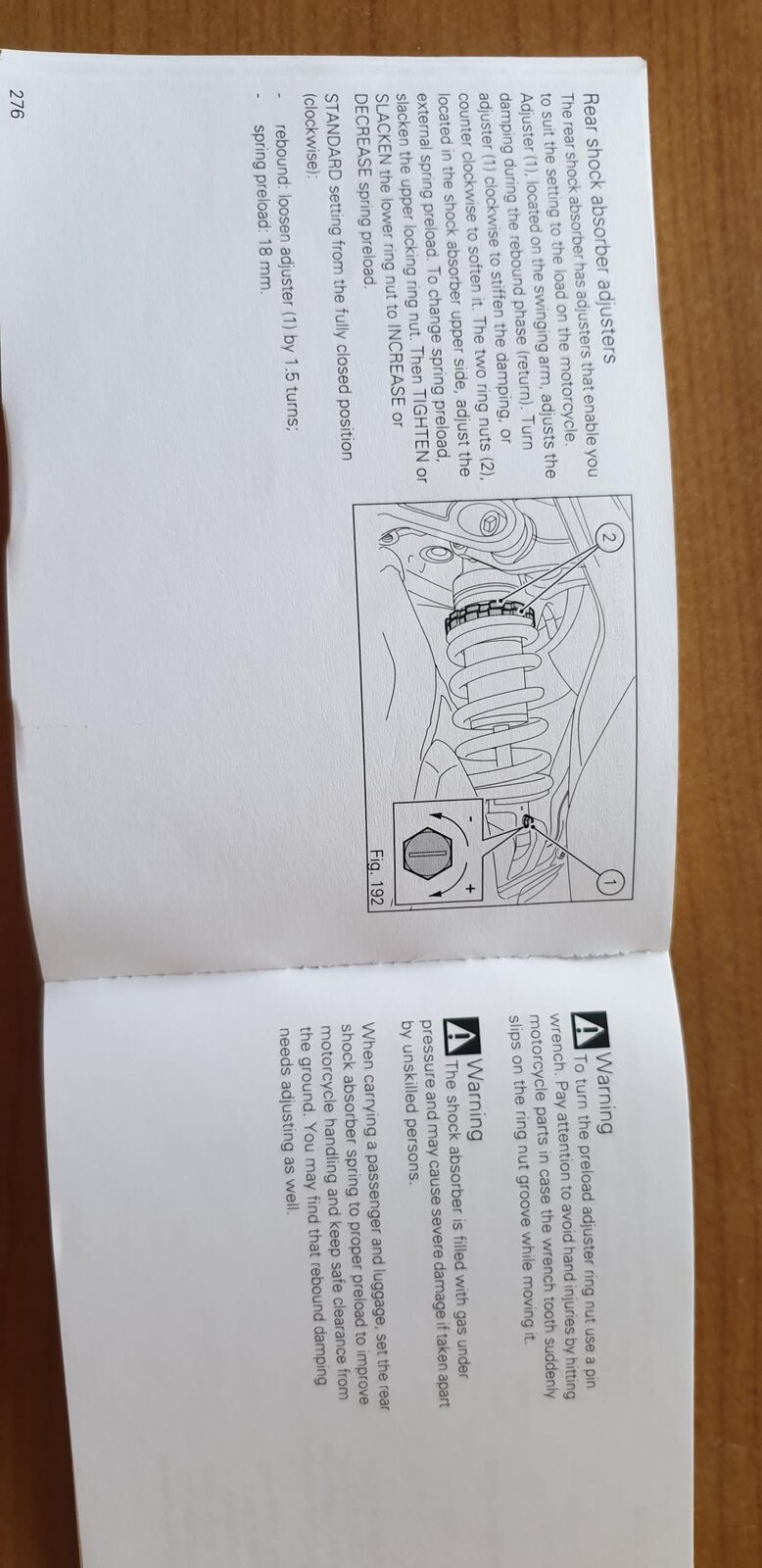

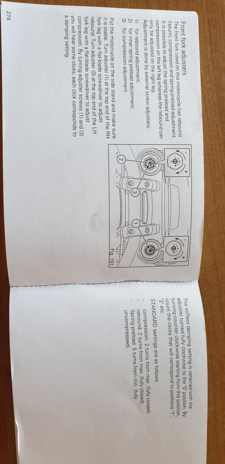

  7. Am looking at the owners manual ATM, am 5 foot 10 and 82Kg. Any advice? 20190526_180437.jpg 20190526_180445.jpg
  8. Currently round at my girlfriend's. I'll have a look at the manual when I get back and give you some suggestions to try. Andy
  9. @Richard8466, a quick Google shows at least 3 independent suspension set up specialists in your region (Birmingham ?) which can provide a ride in/ride out service for road bikes. A basic setup change shouldn’t cost more than about £80 and could even be less. However, if you want to have a go yourself and apart from the rear shock absorber pre load adjustment you use basic tools, the owner’s hand book gives you the original factory settings to get you back to square one if you think you have gone wrong. I’m happy to work with you using the forum PM function, if you want to have a go. One word of caution, although the Marzocchi front forks and Sachs rear shock absorber are not the most versatile suspension on the market, you should get a better setting and what your Dealer is suggesting, probably an Andreani kit, will cost about £900 just for parts. Andy
