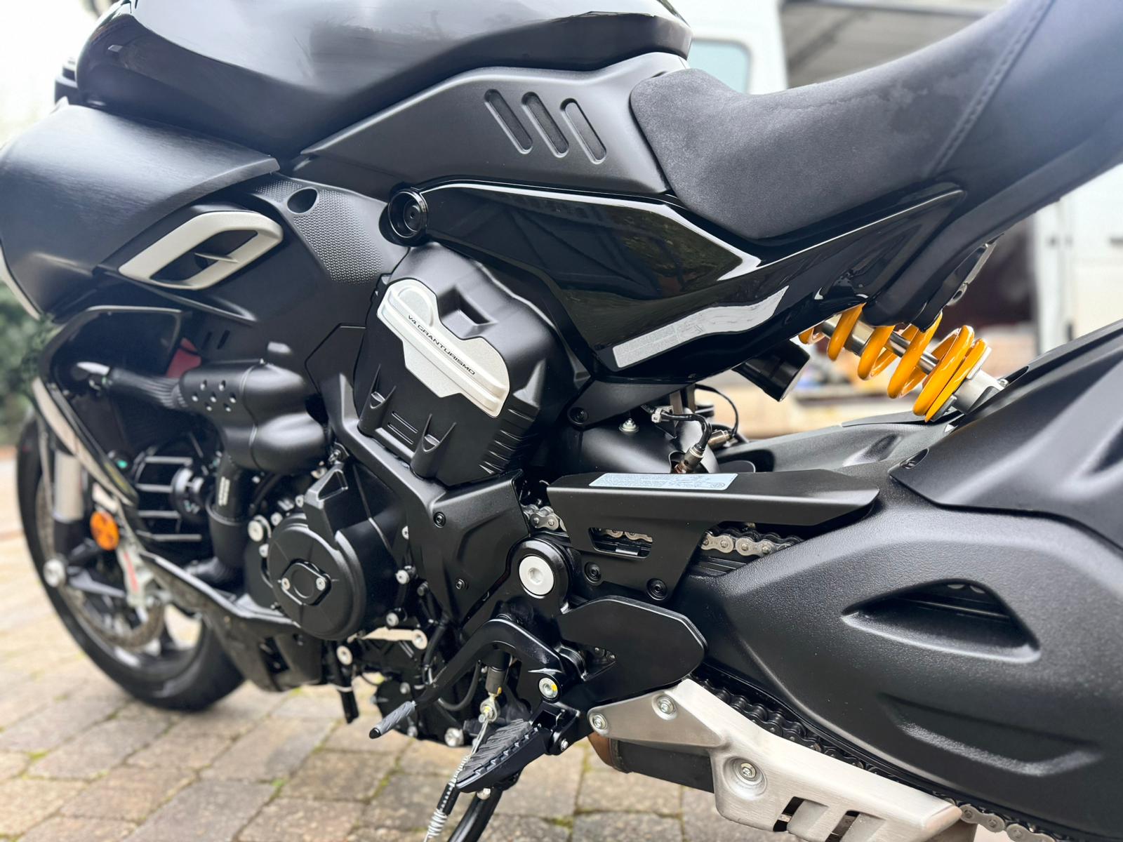

    In the second picture, you can clearly see that bodywork has been removed to make the adjusters accessible.
    To me this is clearly a design flaw. I am guessing the bike was intended to have electronically adjustable suspension but this didn't make it into production.

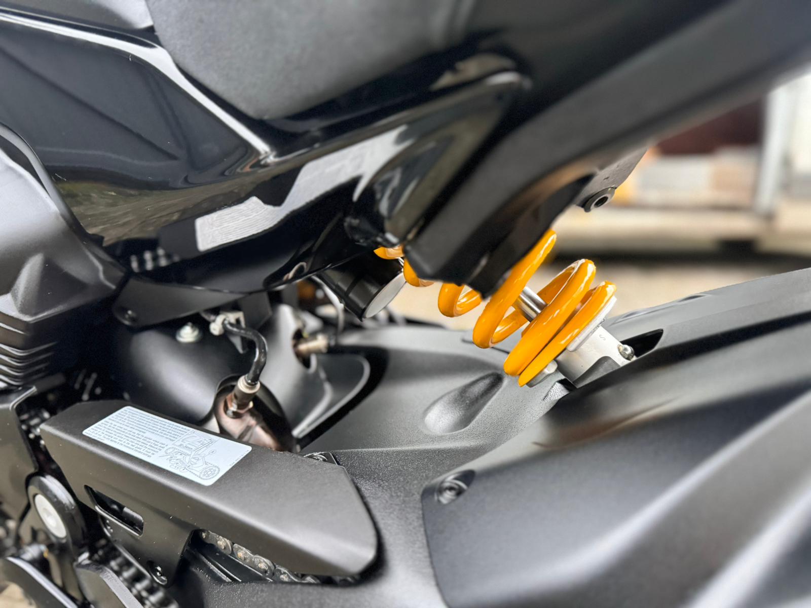

    I think this picture might tell the story. The preload adjustment rings are definitely under the side fairings. I get what you are saying about the image just being a 'cut-away' but I genuinely think they need to come off to access the adjusters.

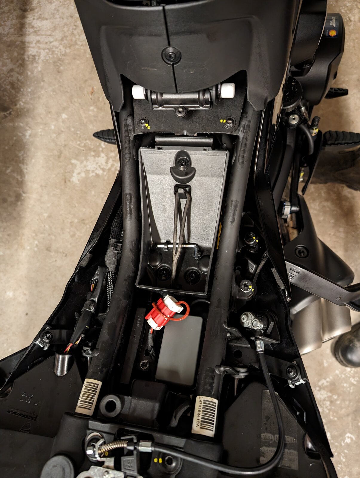

    I had previously checked under the seat but at that stage was sure there must be an easier way, so I'd not started disassembling stuff under there.

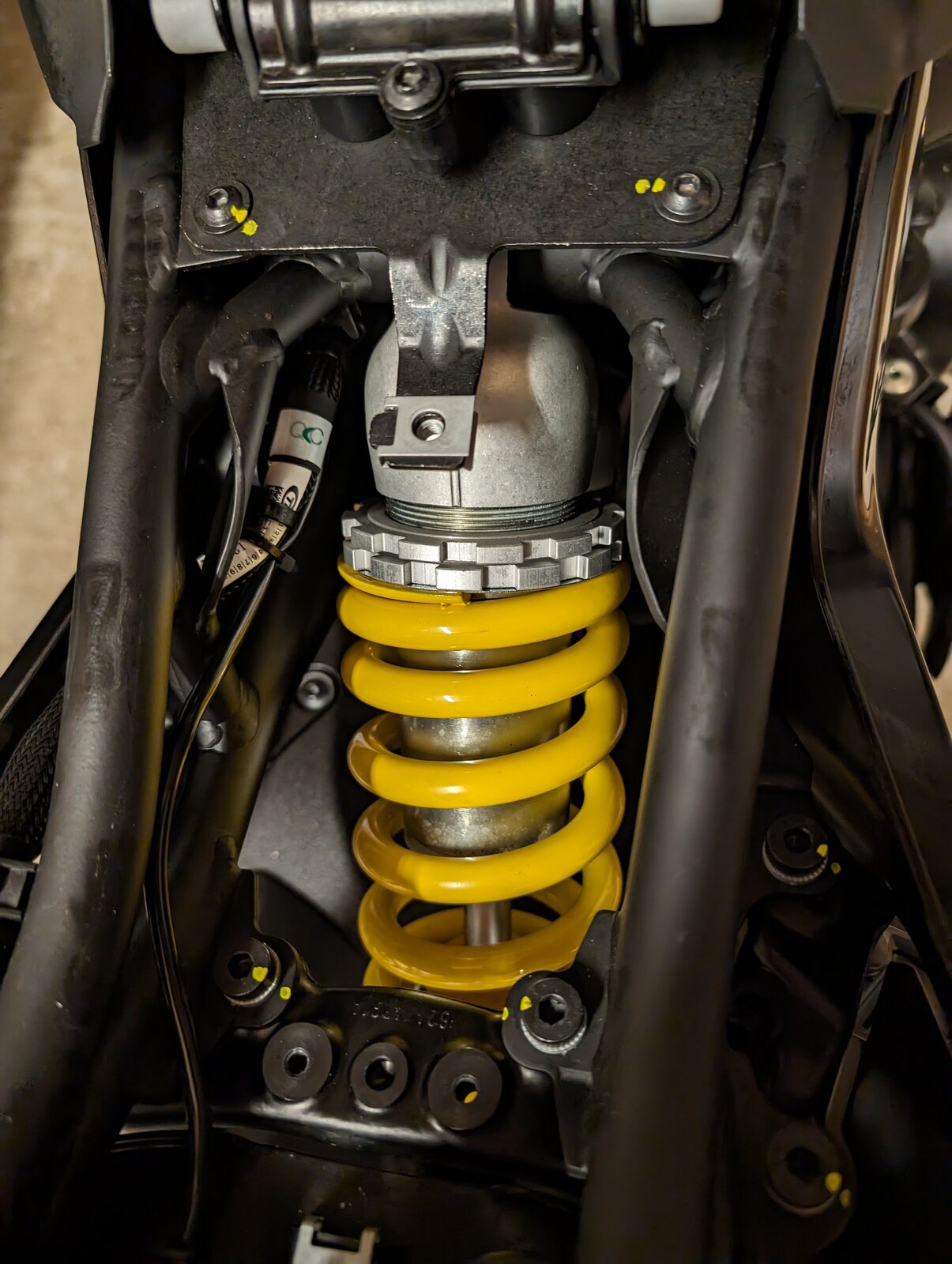

    Under the seat, this is what you have:
    You can then remove the plastic tray (four allen bolts) and you get this!
    Yay! The adjustment rings at last.
    I should have figured this sooner but after taking the seat off previously, I did not even think that I copuld remove more stuff to get to the top of the shock.
    Not much room to work there but it might just be enough. Shame the owners manual does not cover this.
    Thanks everyone.
