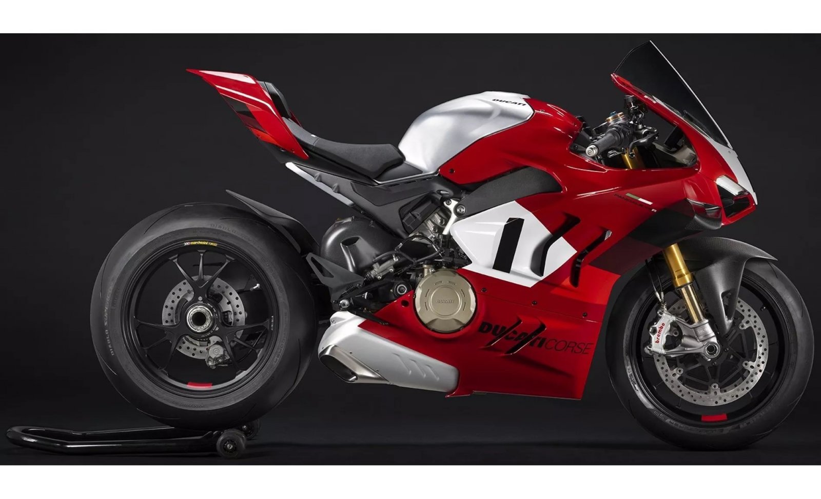

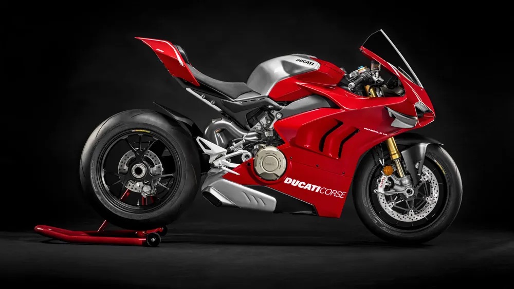

  2. Is it a first or 2nd gen v4r? The latter has a smaller clutch pack and gets through them at a greater pace.
  3. I don't know the generation J0n. It it easy to tell?
  4. First
    Second
    The side pods on the lower faring, less angular tank shape, rear sets are black.
