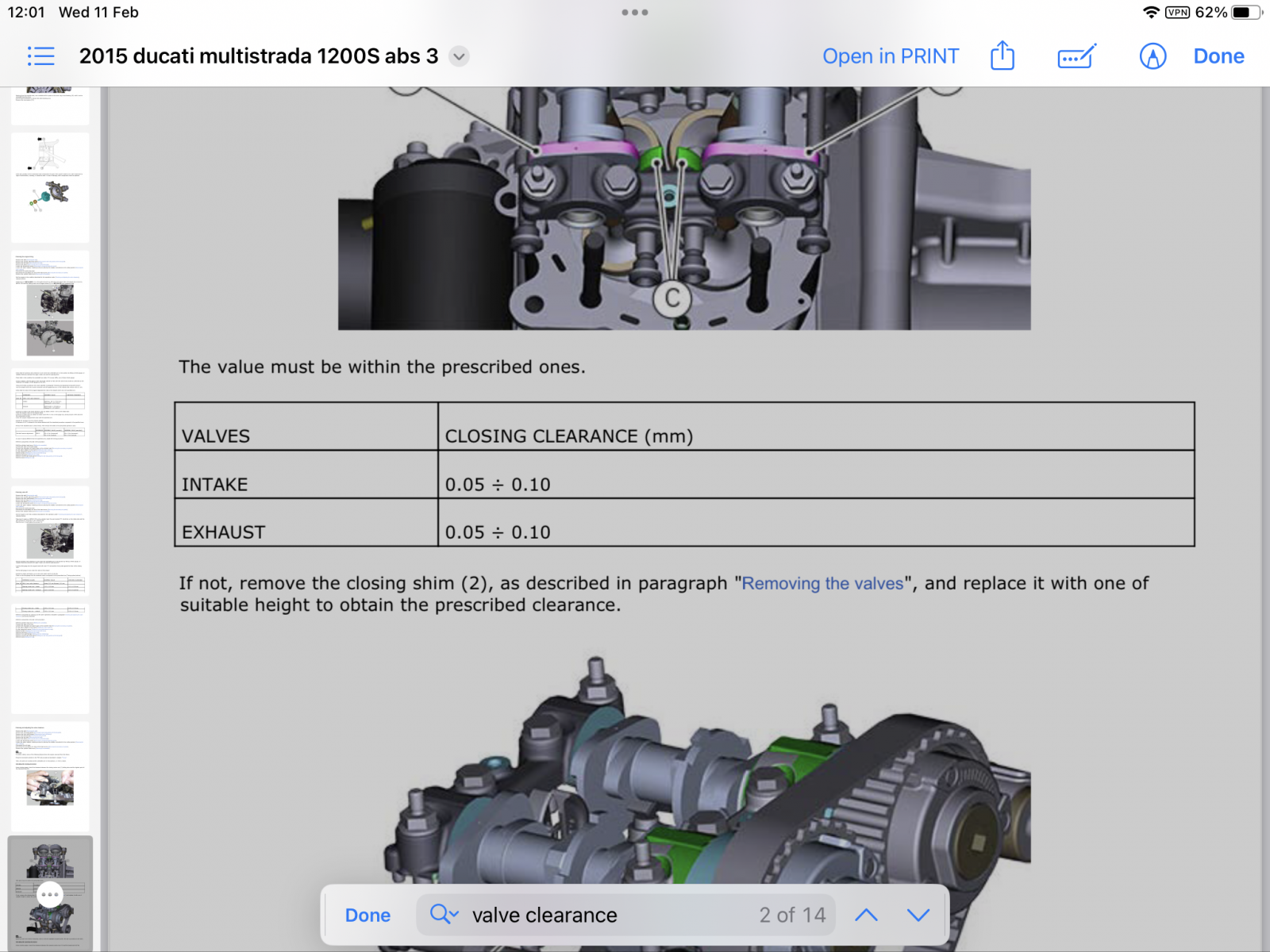

  4. In the service manual I have for a 2015 Multi 1200, these are the values quoted.
    They are so tight a tolerance, that I assume they are the same as the assembly values too ???

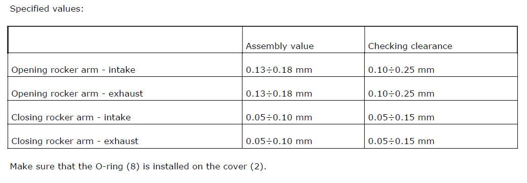

  9. Where did you source your manual? Not all are created equal. There are a lot on the 'net that are littered with errors.
    The couple I have looked at, carry the same figures as in Keith's post... The latter figures are for inspection.
    Opening rocker arm - intake 0.13 to 0.18 mm - 0.10 to 0.25 mm
    Opening rocker arm - exhaust 0.13 to 0.18 mm - 0.10 to 0.25 mm
    Closing rocker arm - intake 0.05-0.10 mm - 0.05 to 0.15 mm
    Closing rocker arm - exhaust 0.05-0.10 mm - 0.05 to 0.15 mm
