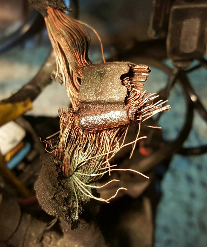

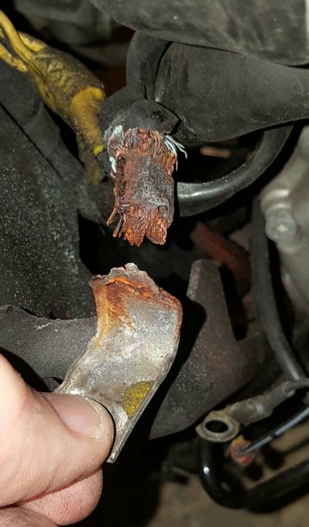

  10. Started having starting problems with my 999. Thought it was just the colder weather (Perth winter). So I got a a motoelectric wire kit which looks nice, good quality stuff.
    When I pulled the battery I realised I have a bigger problem and explains why the starter was struggling to crank the motor [​IMG]
    Has anyone else had this sort of corrosion problem. It's the - ve (lower) terminal.
  11. Wow
    wow...
  12. Yeah! Nasty surprise
  13. Wise after the event, but it is good preventative maintenance that stops this being a problem. Before the winter disconnect both battery terminals, clean them and coat in dielectric grease, no corrosion problems in 13 years of 749 ownership.
