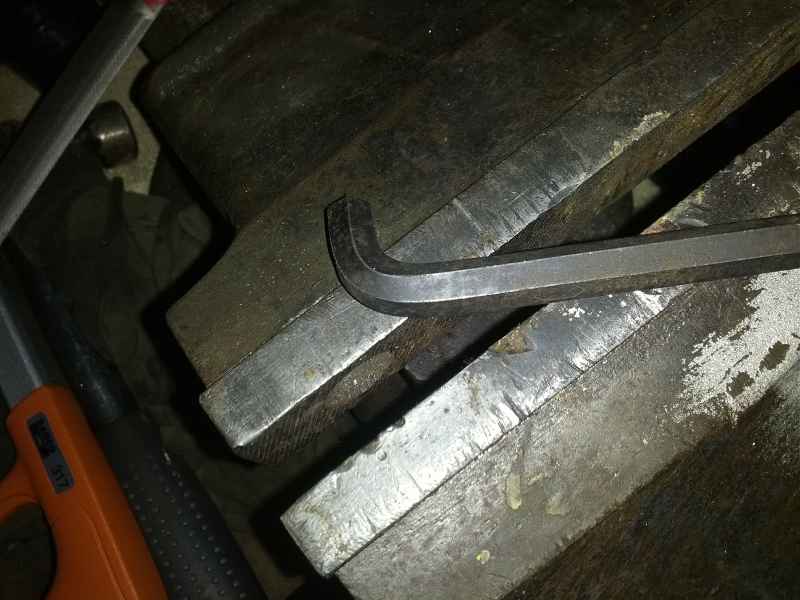

  1. I doubt - you will be able to hacksaw the allen key stub off to be honest? Should be harder than the hacksaw blade? If it isnt then get yourself a better one. :upyeah:
    Would recommend using an actual spanner rather than an adjustable on the stub, will hold the stub better, less risk of slippage & Several Short Words. :wink:
    You can link spanners together to get more leverage in a tight space if only a spanner will fit? Use two combination spanners (ring at one end, open ended other)
    Fit the ring end of one spanner on the nut (lefthand of the pic), then link the ring end of the other one onto the open end as shown, use this to move the first spanner round? :upyeah:
    (Pic shown after decat-ing my car with a large masonary drill :biggrin: )
  2. Sorted!
    Got an old 8mm Allen key and a good hacksaw and managed to cut it to fit. It did take a while and doubt the blade will be much use again but, hey-ho!
