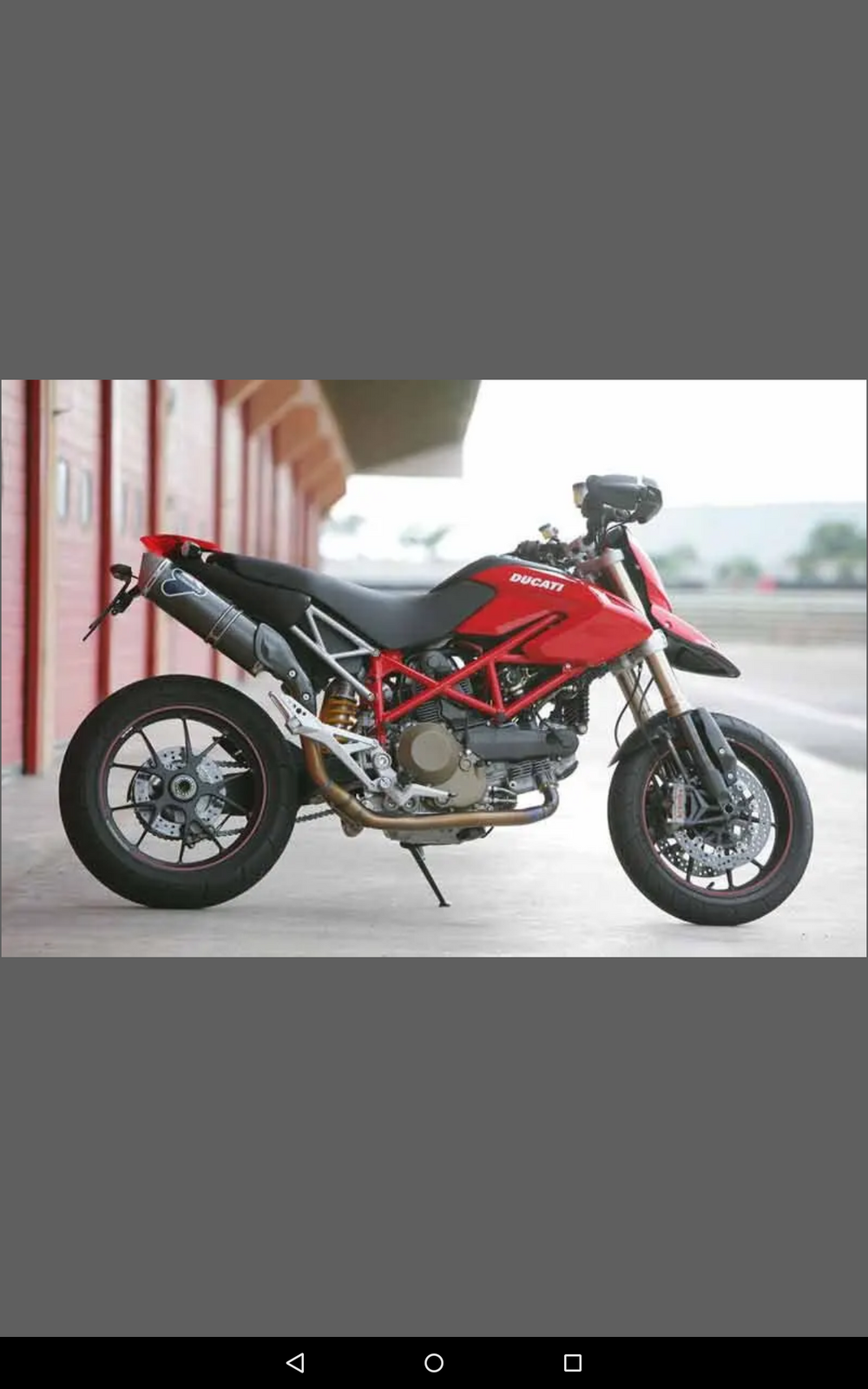

  10. Interweb images such as this one should help a bit of you can't get better info. Horizontal one certainly looks easy...

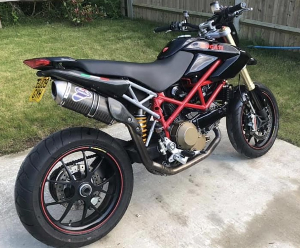

  16. Pictures of it are now due Felstmiester :upyeah:
  17. Yeah - otherwise yer just trying to impress us...
