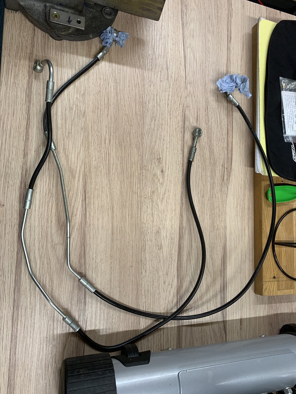

  3. Had a scratch around in the garage. Got some OEM pipes but I think they are all for the front end from the ABS pump. If you have a pic of the one you are replacing then I can compare. I can't remember how they all came off if I am honest so the rear one could be there.
  4. Is it one of these

  7. Hi Paul, been away racing so not looked at the forum for a few days. Those in the pic look like the ones I have but still not sure which is the rear pipe. Yes, abs has been disconnected on the race bikes. HEL lines from the master cylinders both front and rear. Direct connections. The abs pump has to stay in play to enable the ECU to function so just blank off the outlets where the hoses would normally connect. Final tweak is a bit of electrical tape over the light on the dash to stop it annoying me.
  8. I’m pretty sure one of them is 899 rear as I couldn’t use it when I converted to SSSA, the other I bought by mistake, don’t know which is which

  10. No idea on the revs thing Paul. Best off getting it plugged into a laptop and looked at. Let me know if you need a brake pipe and I will endeavour to work out which one it is. It'll be one of them as I removed them myself and put them in the box but that was back in 2015 so can't remember which is which.
