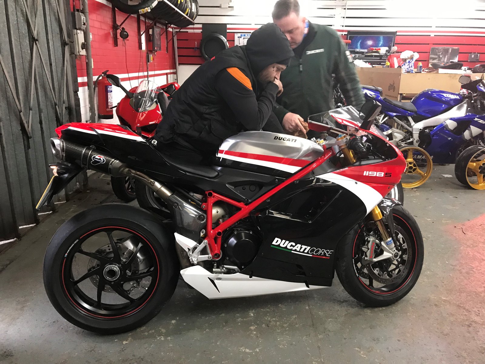

  19. Afternoon all, I have returned to Ducati and have bought an 1198 S Corse.
    And I must say whenever I look at it I have a massive grin on my face.
    • Like Like x 7
  20. They are sweet looking bikes, great choice :):upyeah:
