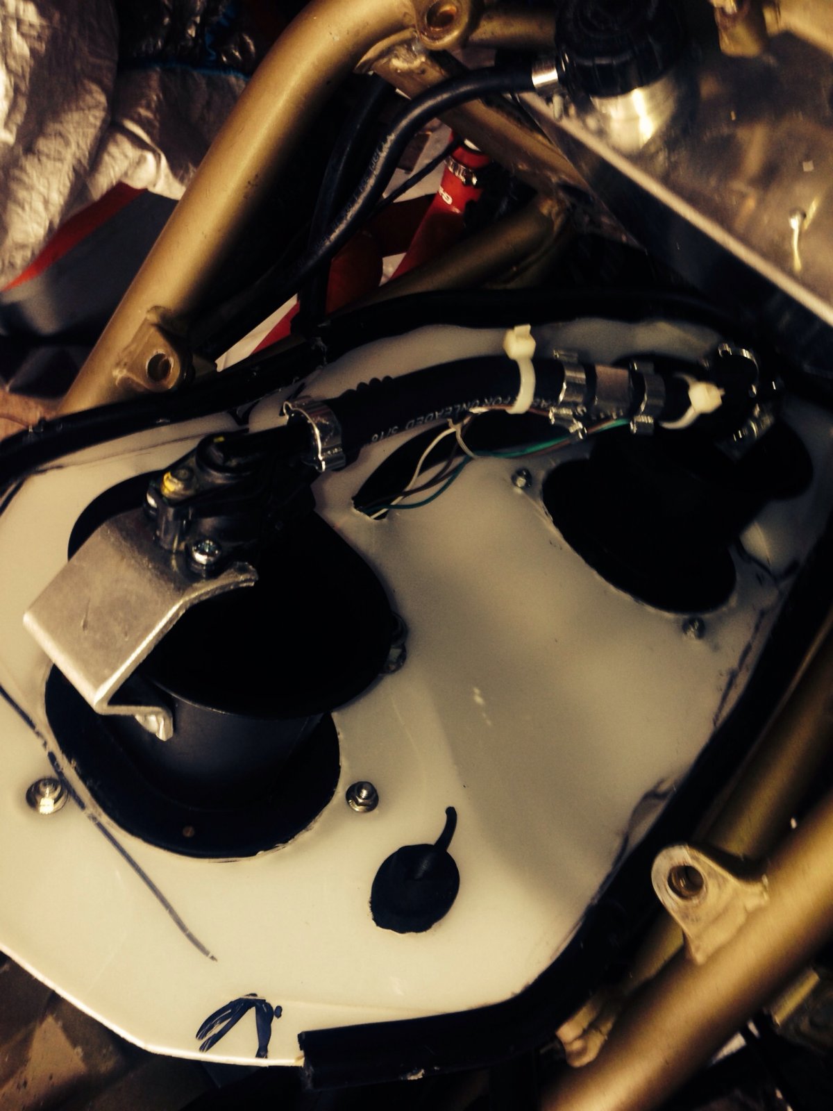

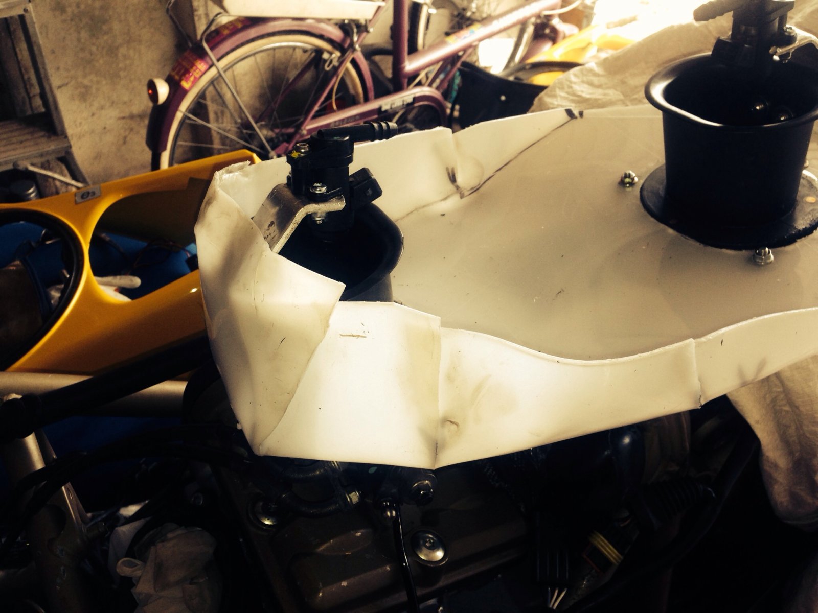

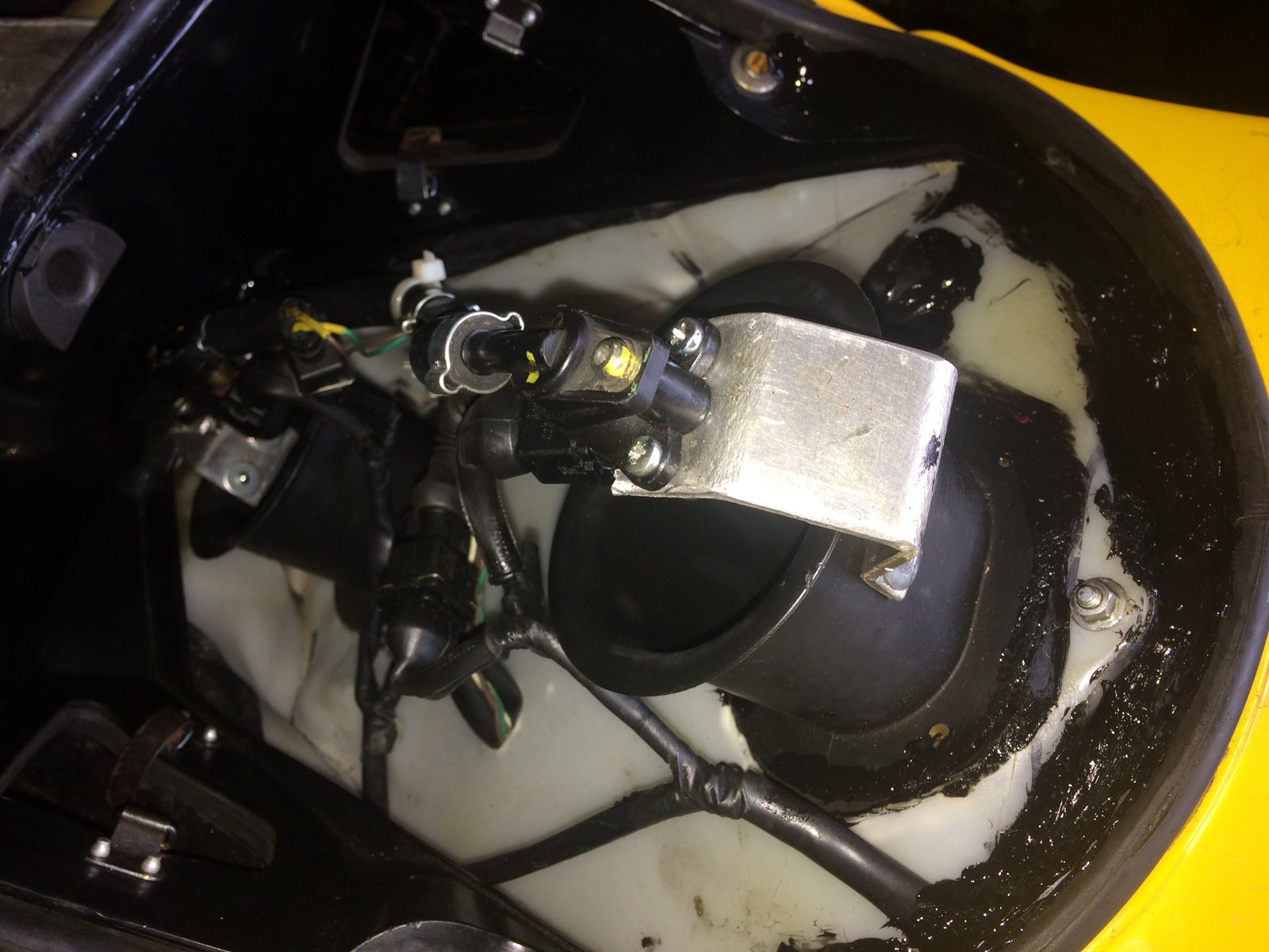

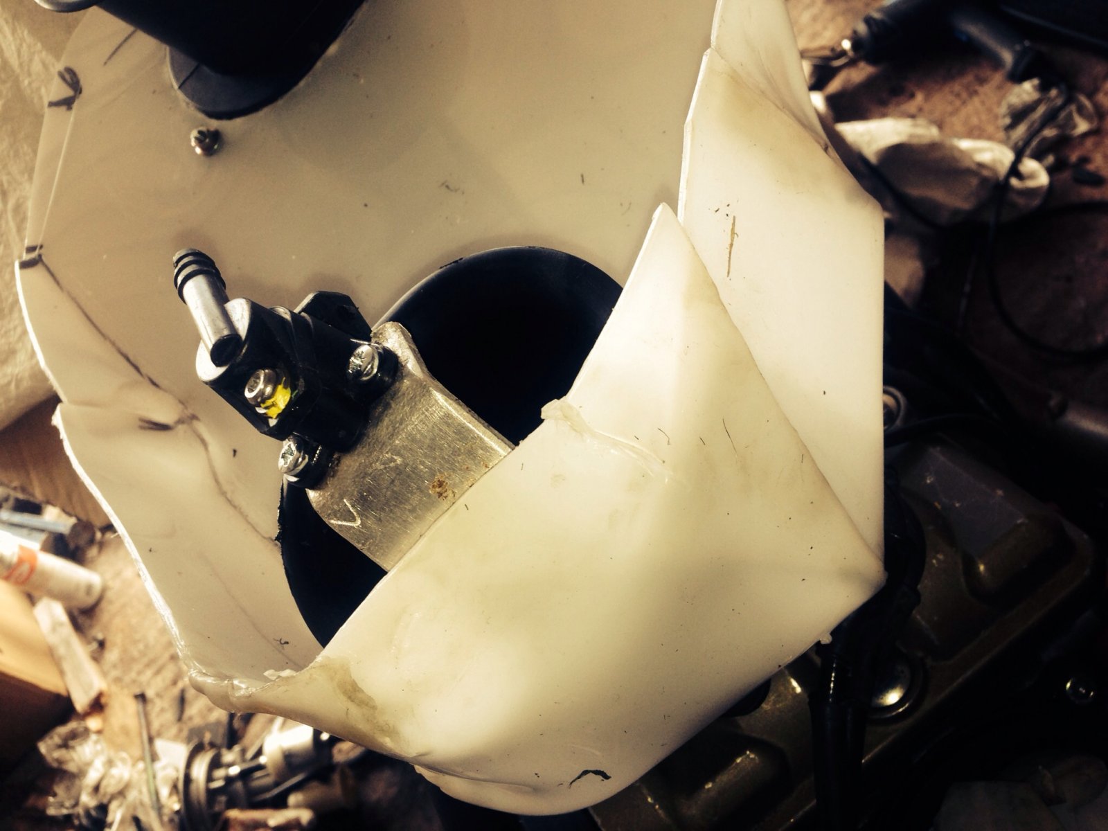

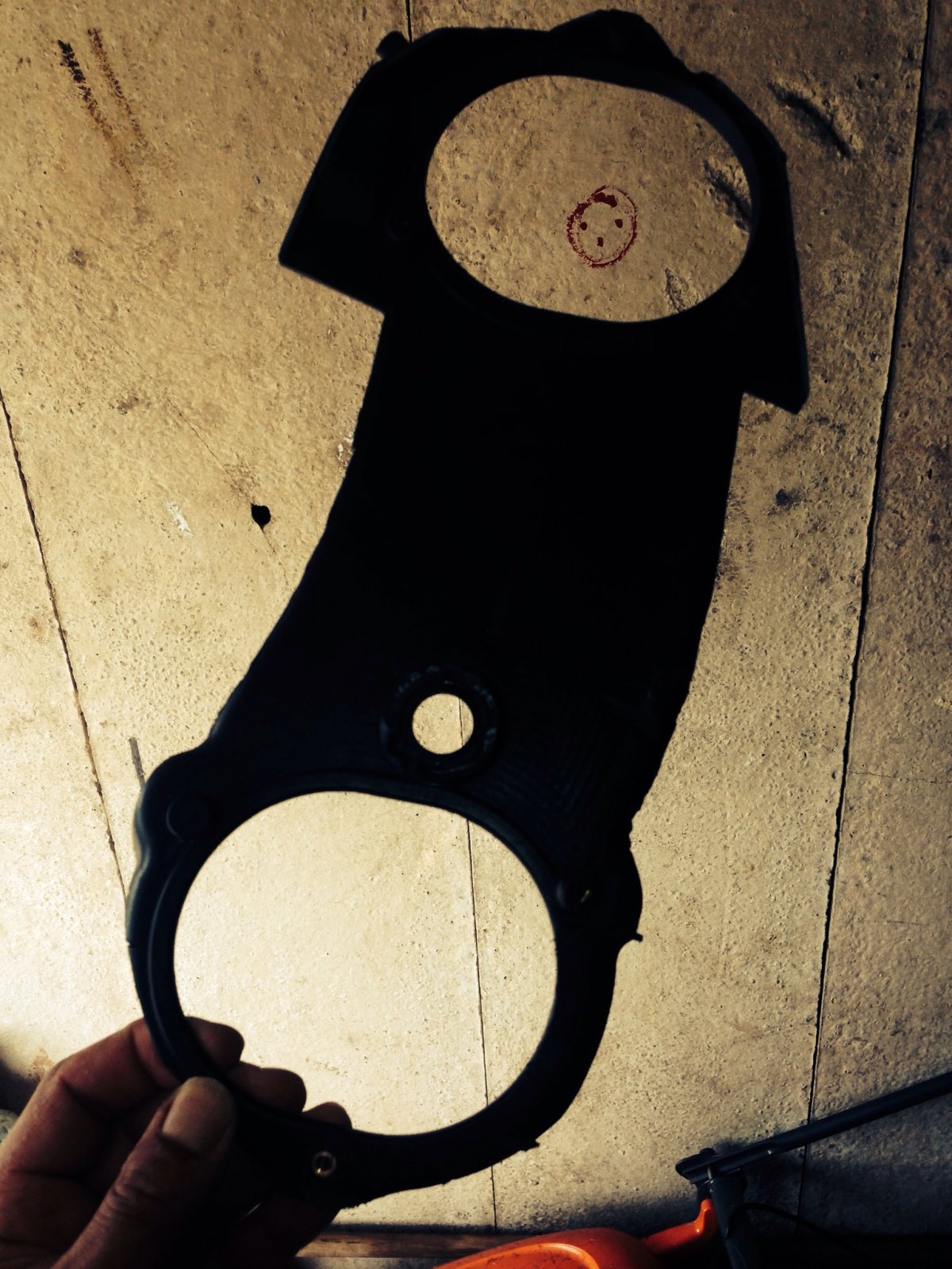

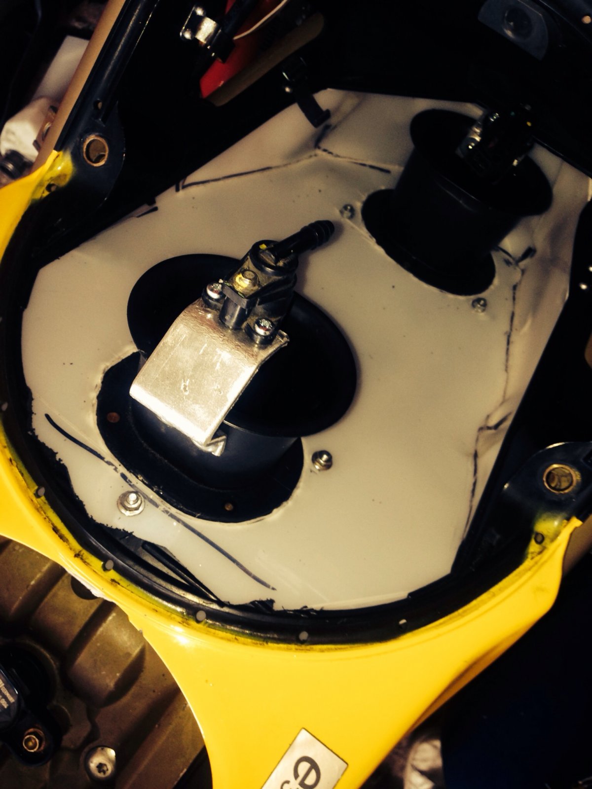

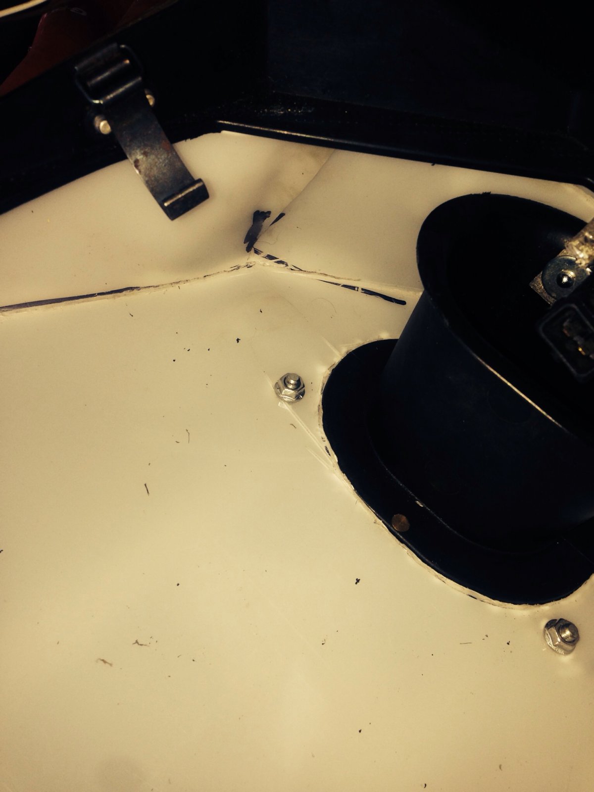

  1. image.jpg 1098 airbox bottom (tb template)

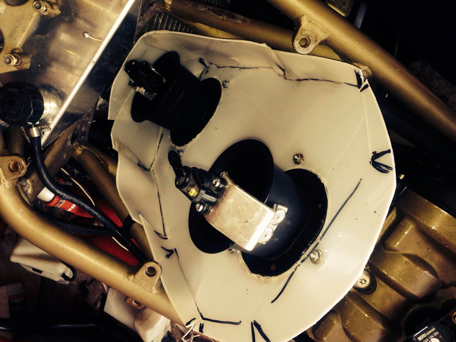

  2. image.jpg 998 airbox (bottom removed). Crap pic.!!

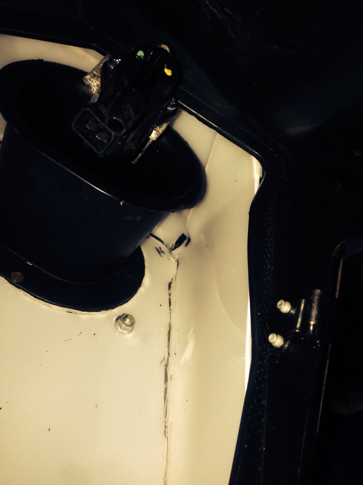

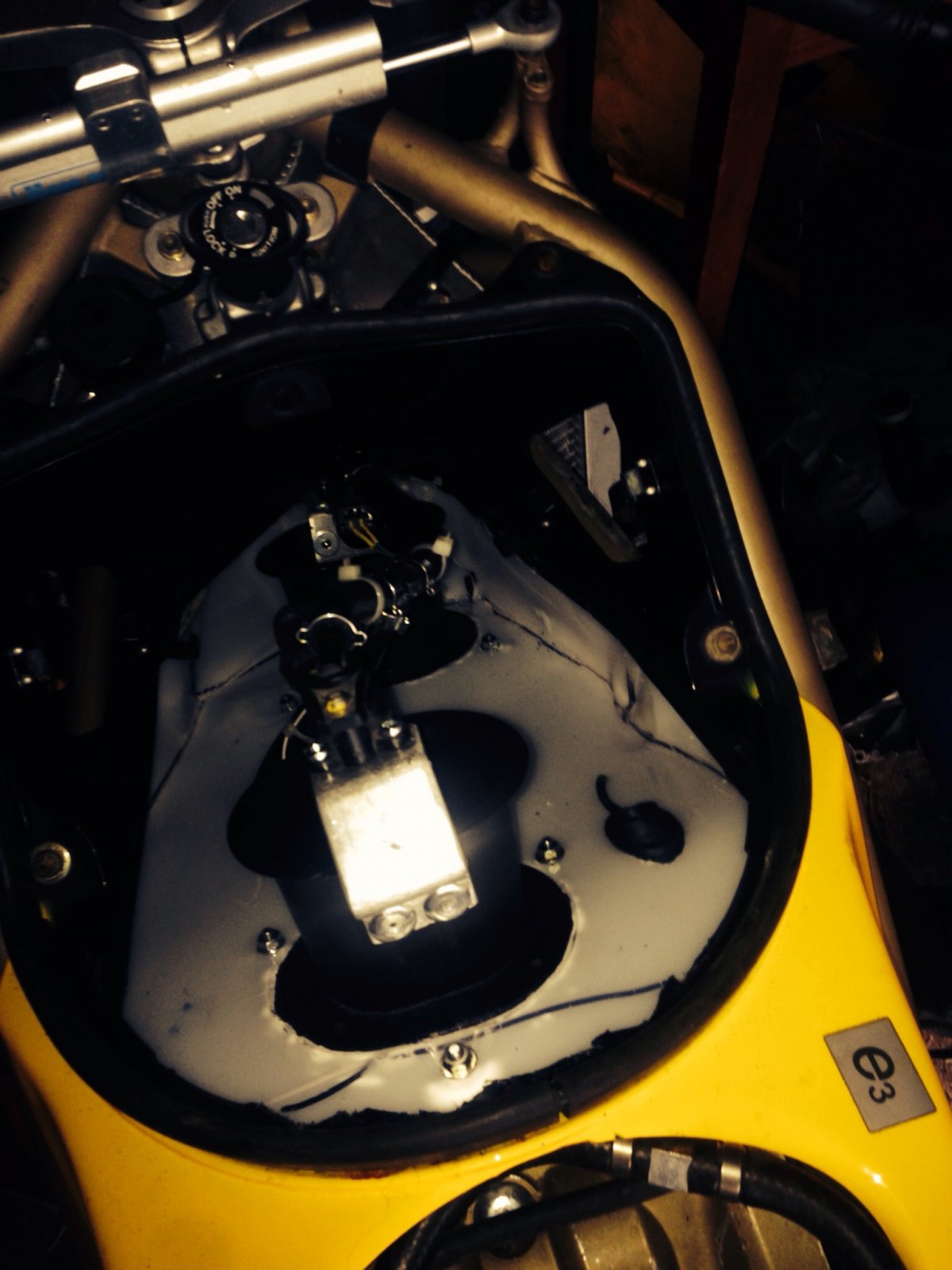

  4. image.jpg Airbox done! image.jpg image.jpg image.jpg image.jpg image.jpg image.jpg image.jpg image.jpg image.jpg

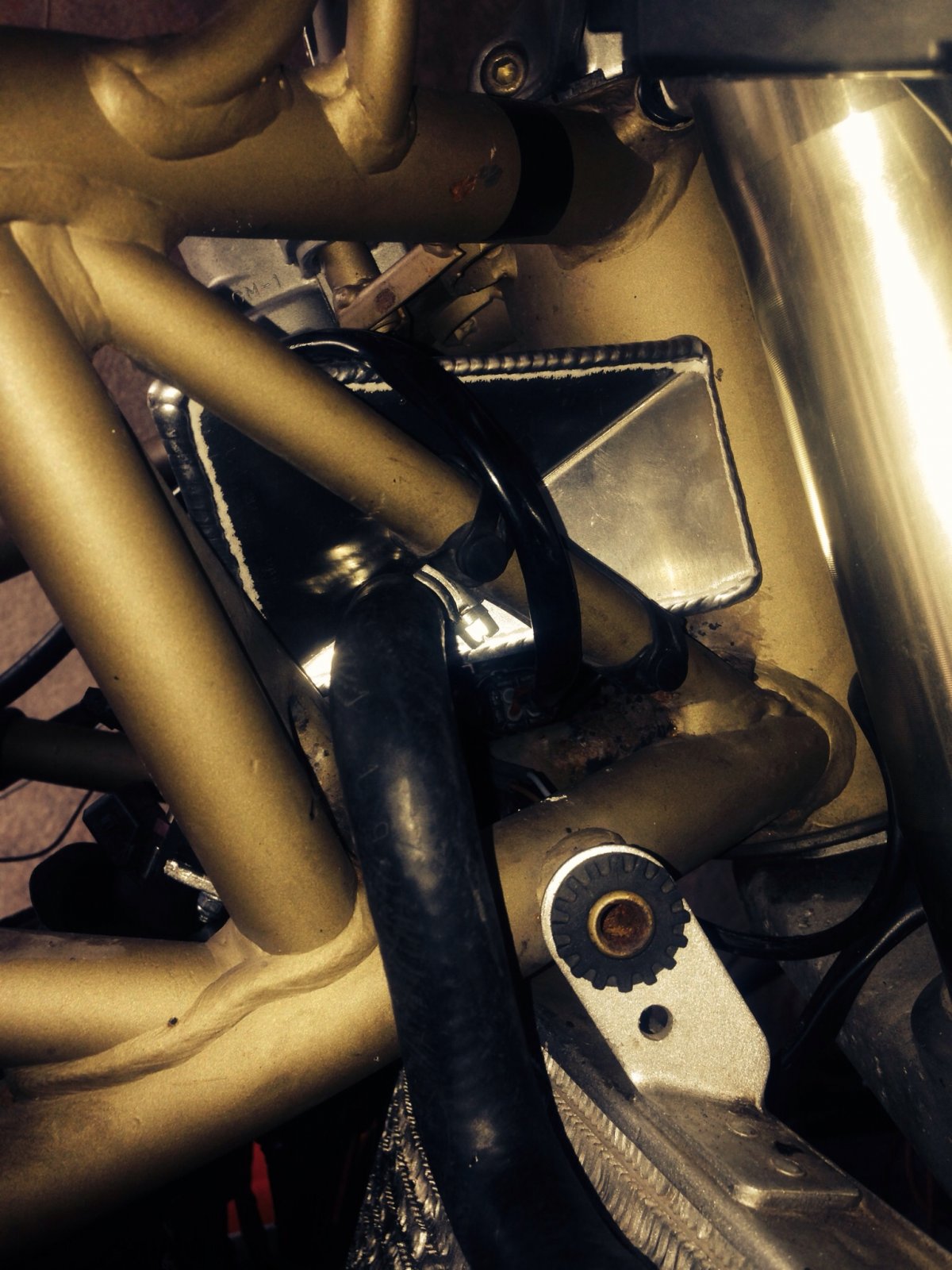

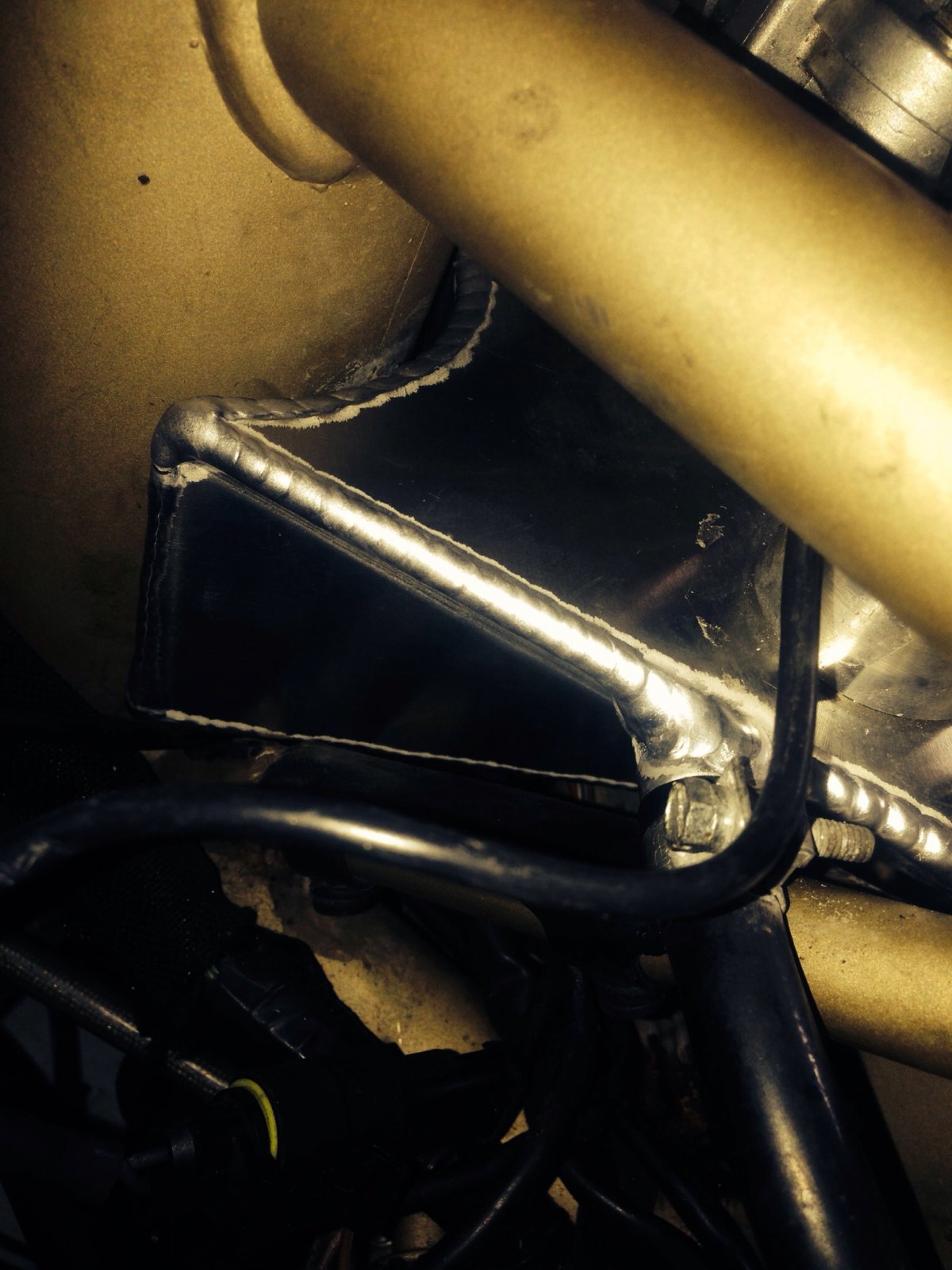

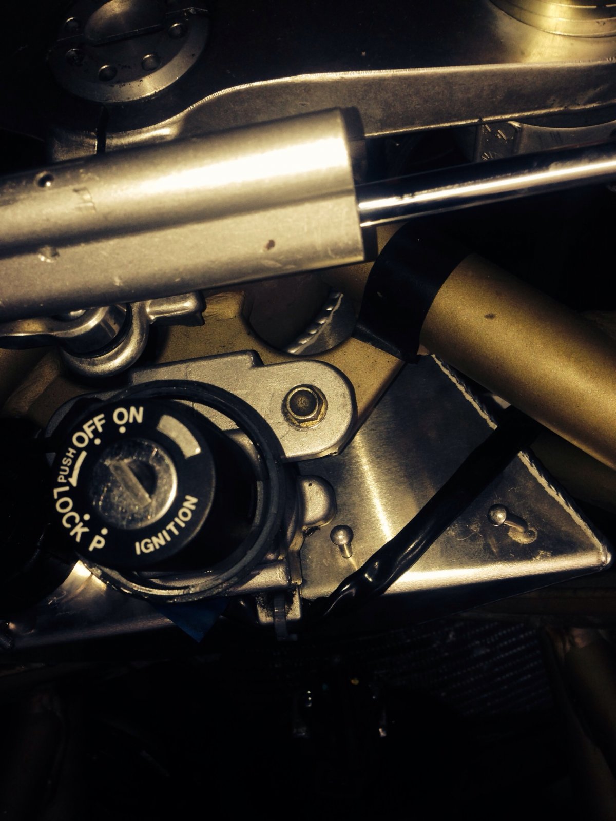

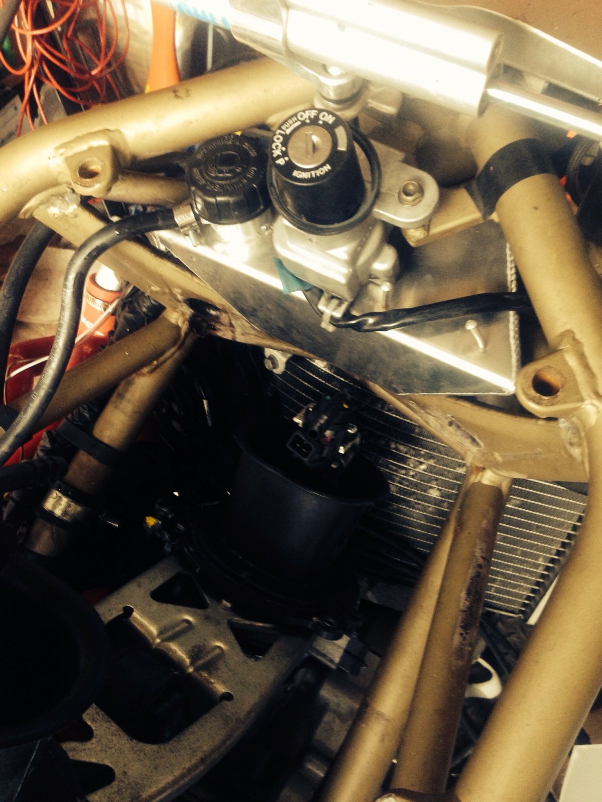

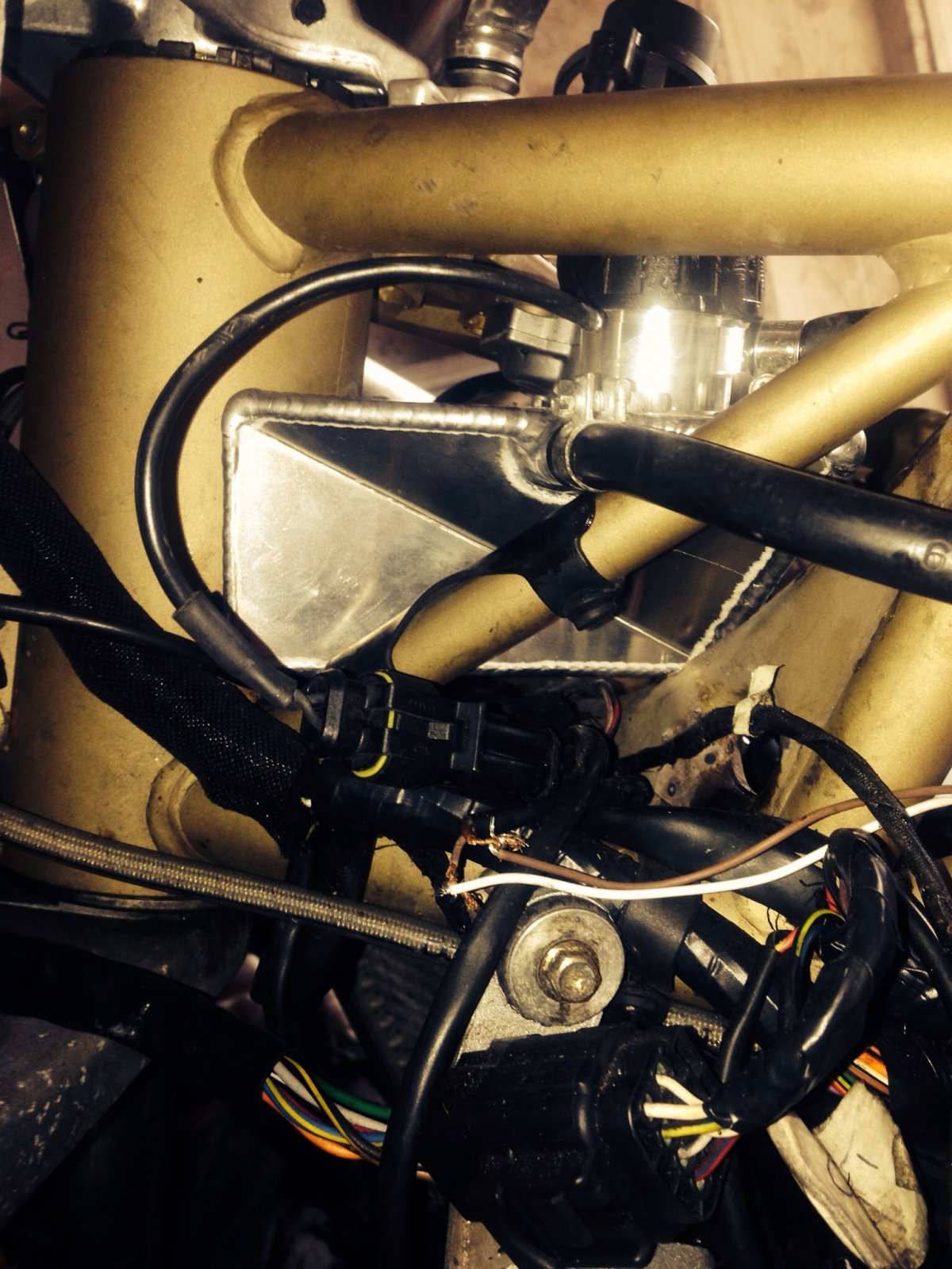

  5. Header supplied late and damaged by cnc_macchined(655). It took 3.5 weeks cost £163 and arrived damaged. Luckily my hybrid does not require the temp sensor mount. Good quality other than that. Also courier left it propped up, outside my communal front door.!! Yodel and 13ten shipped it. I would advise buying anything that uses eBay global shipping. Appalling service and gets re packed badly in the states. image.jpg image.jpg image.jpg image.jpg image.jpg image.jpg
    Nicely made. Shame the guy was a knob. No more leaking shite ducati ones needed it the future, on the plus side.

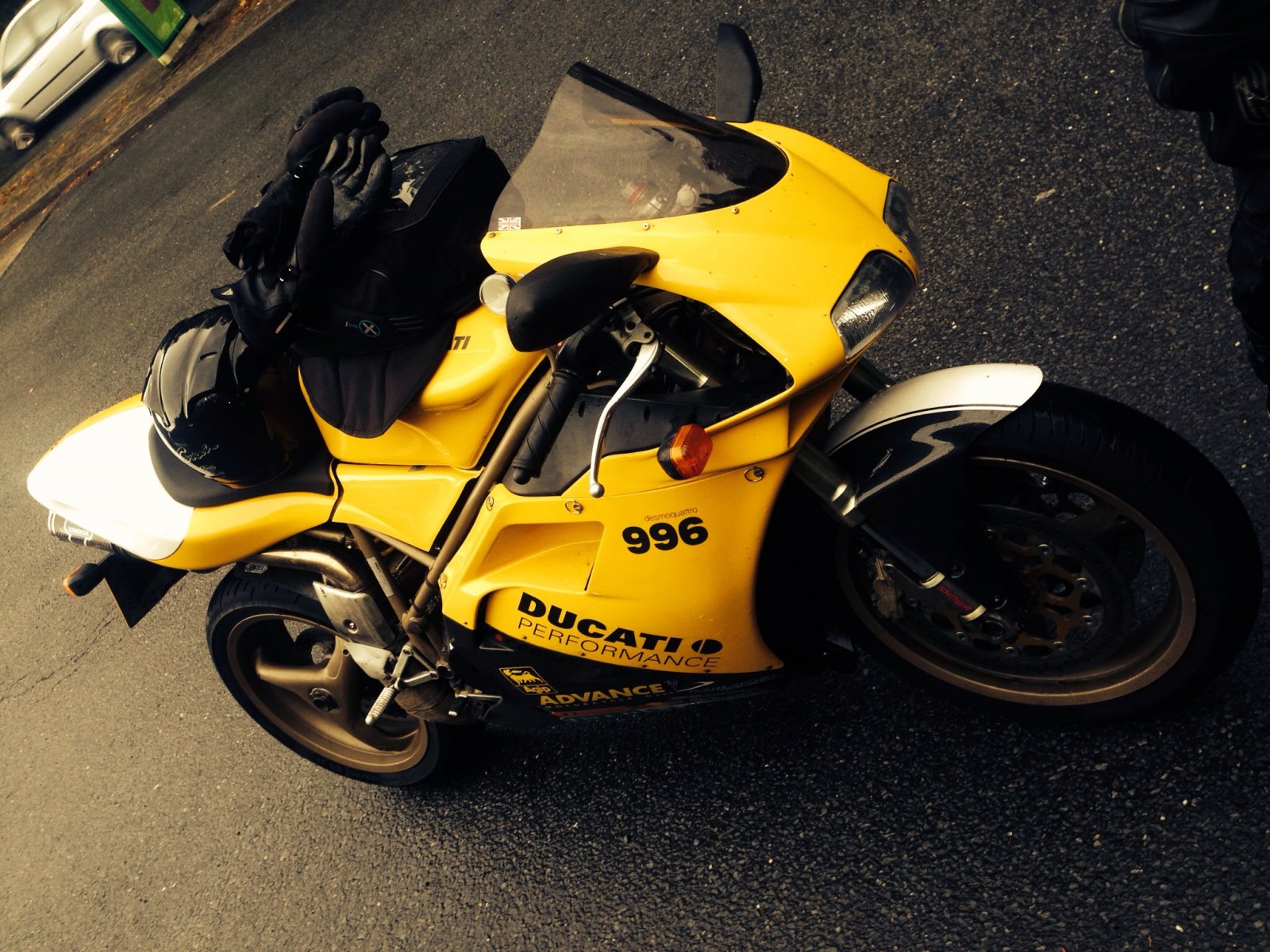

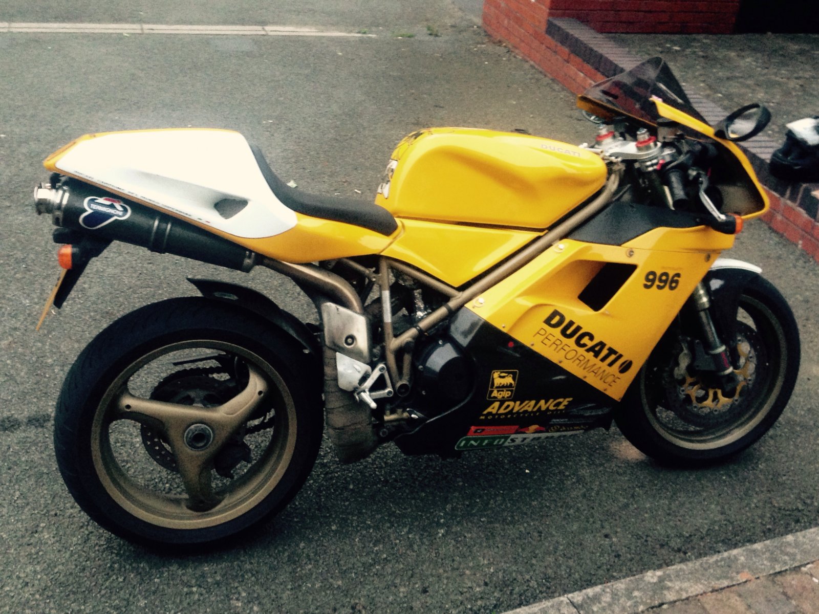

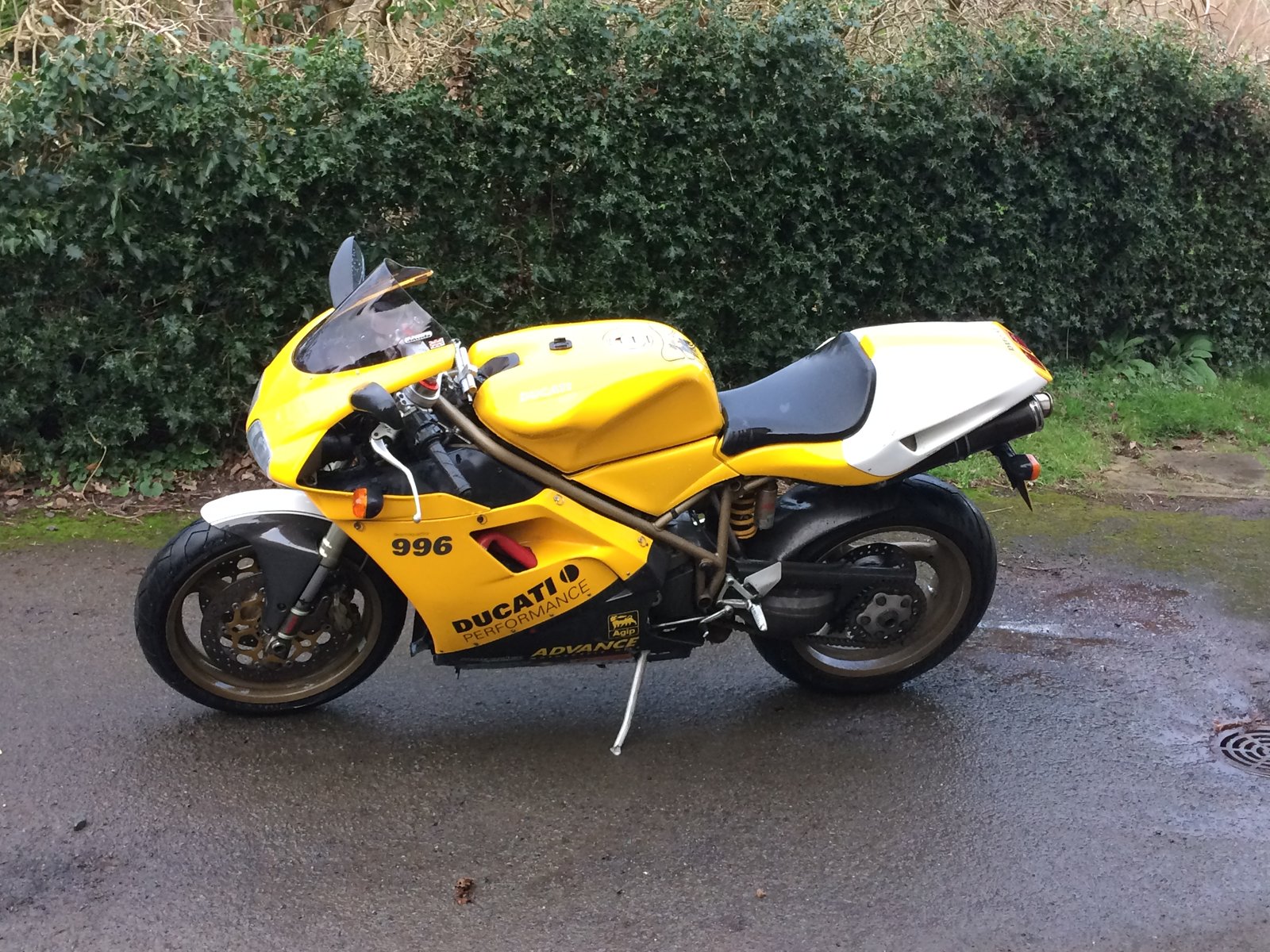

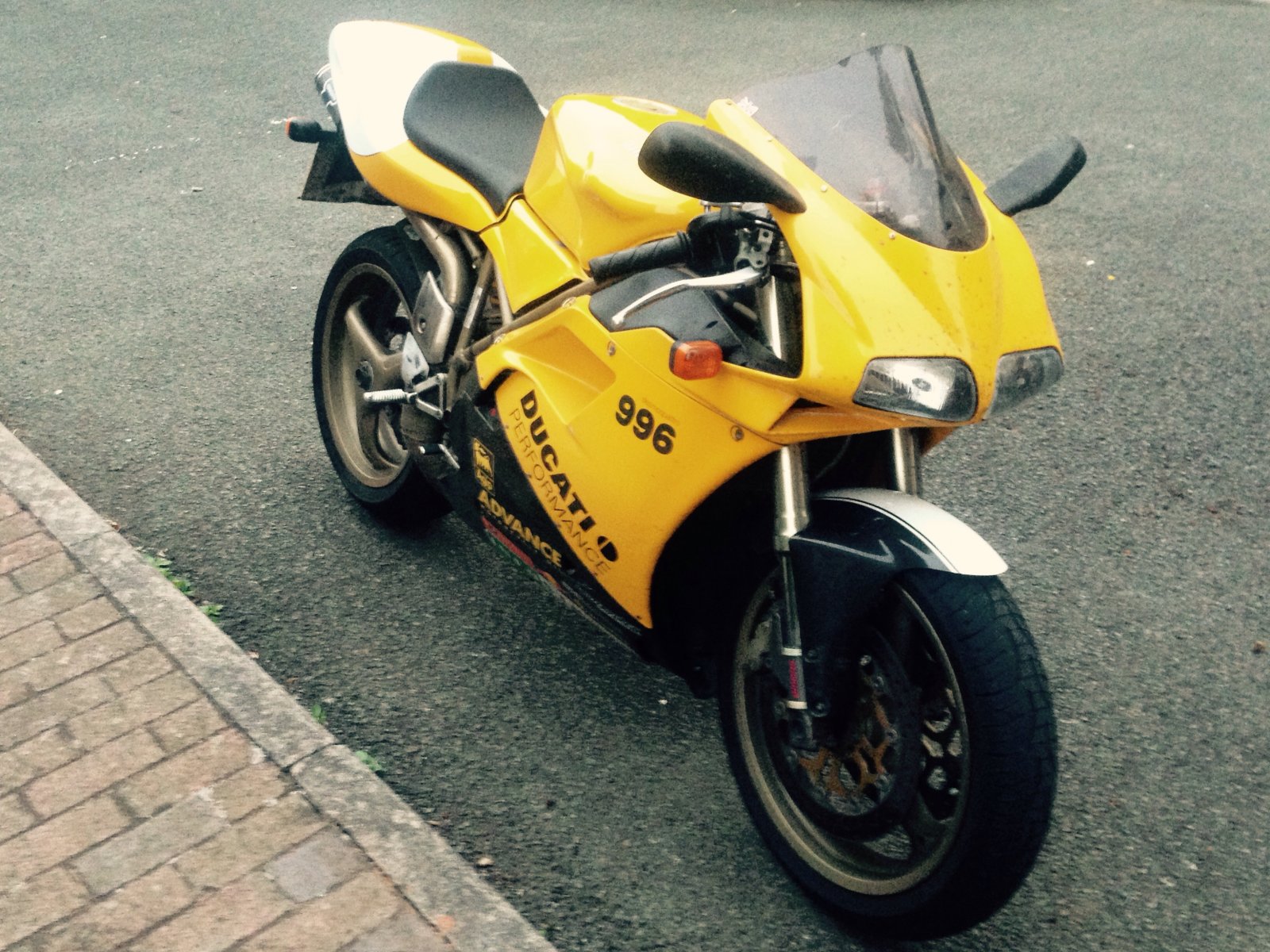

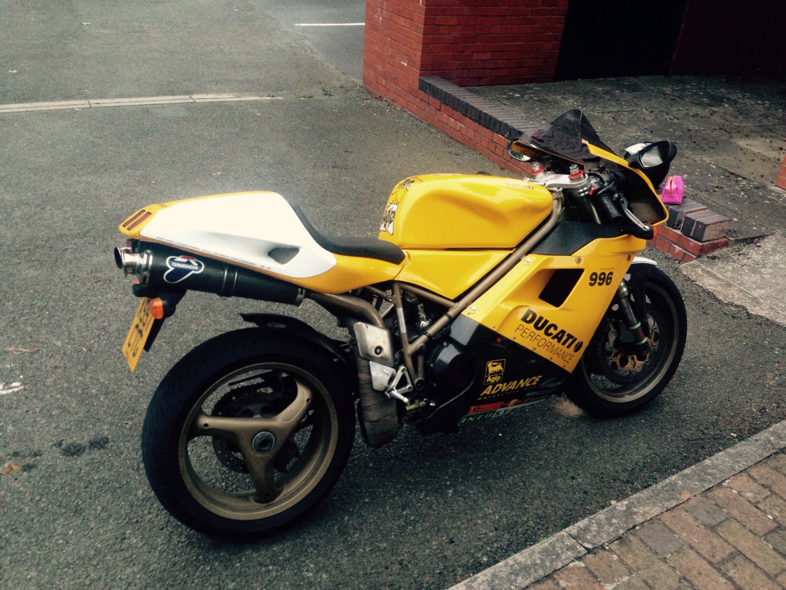

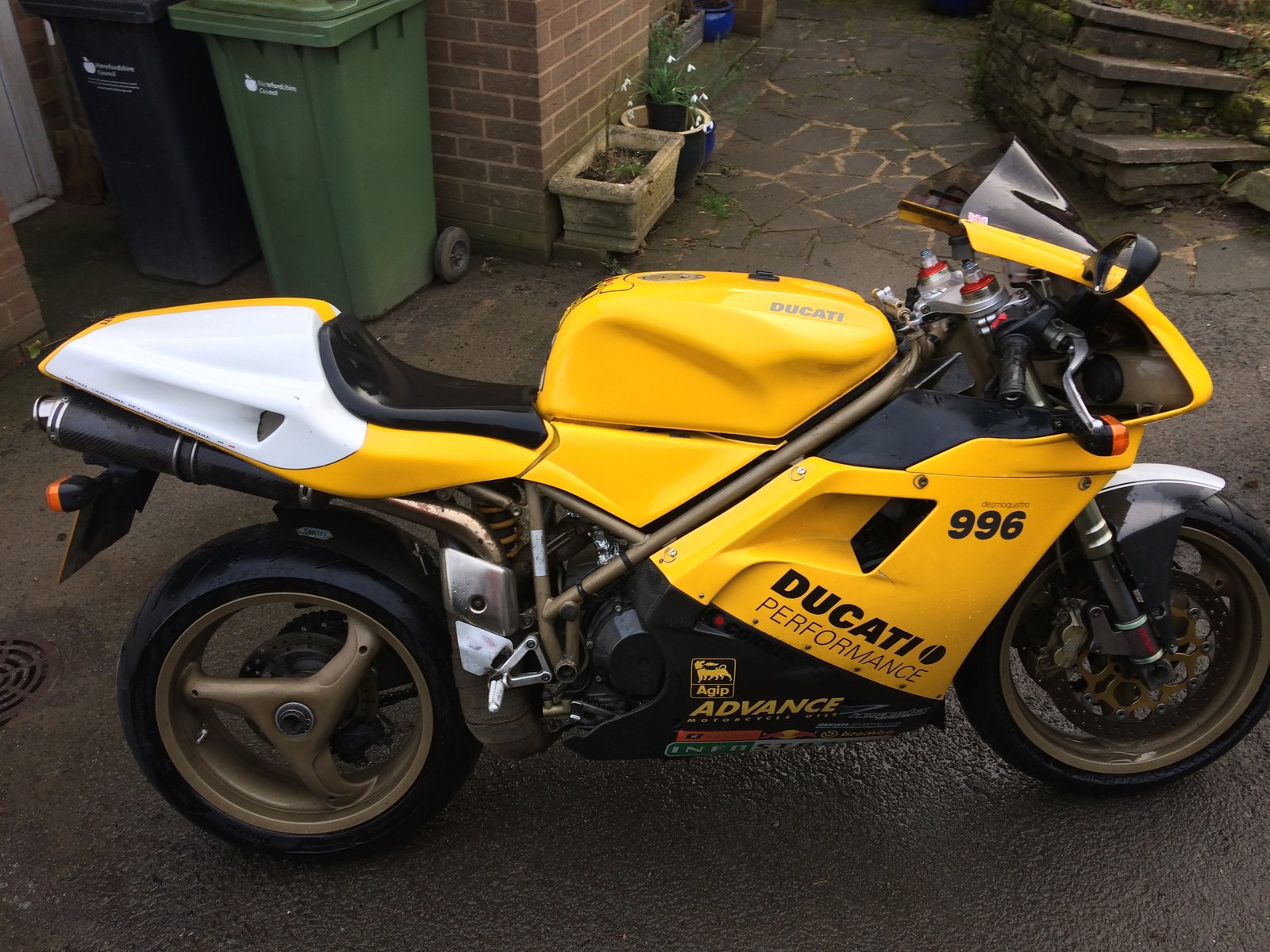

  6. image.jpg image.jpg image.jpg Done.!! Spending the weekend riding around Wales.

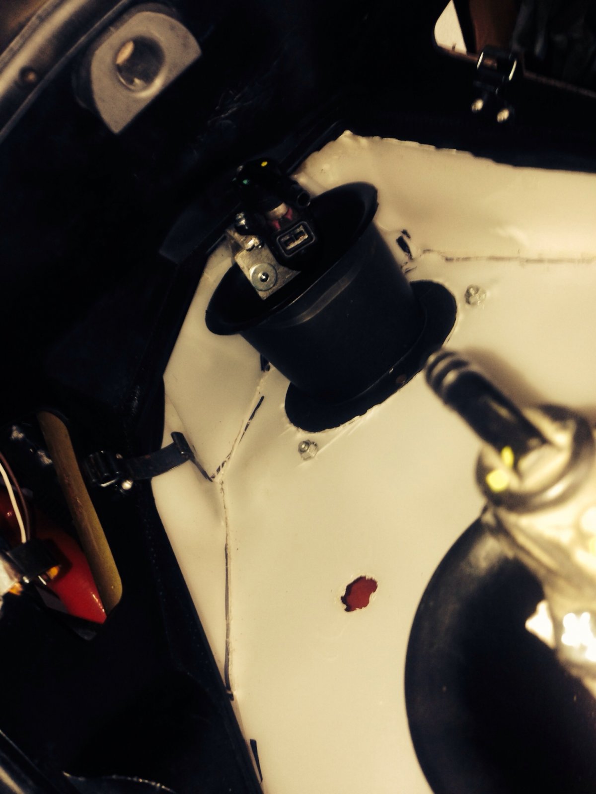

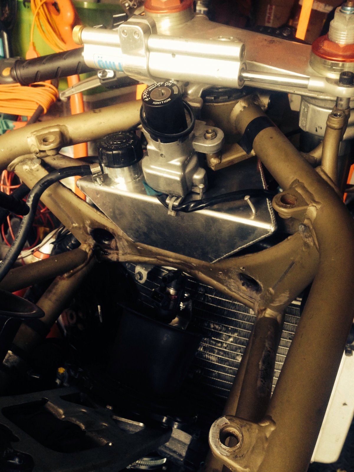

  8. Why has the ally header tank got half installed rivets hanging out of it?
  9. Barometer sensor pushes on them.

  11. Arrived damaged from America. I can only assume it got damaged by beats global shipping scheme which upon researching, the shipping corny re pack to get the weight down. Crap.!!
  12. Just a few more pics image.jpg image.jpg image.jpg image.jpg image.jpg image.jpg image.jpg image.jpg image.jpg

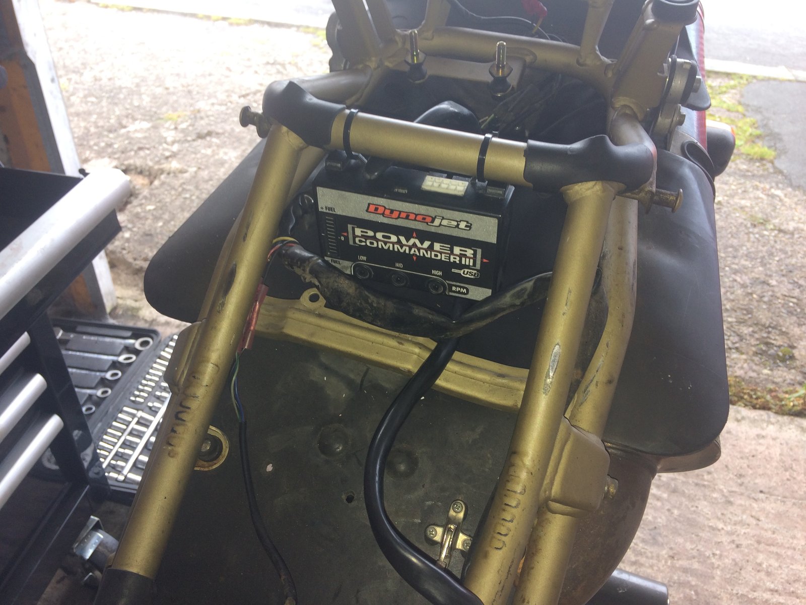

  13. 7B2A1367-F7BB-4333-AADD-09046EA2033C.jpeg A745DDD2-9803-4BC5-BF3B-0B2FA06449B9.jpeg B404C11A-FBE0-4511-98AE-6E242C779D76.jpeg 5720FA1E-170A-41CB-B661-C7B9B9E0F654.jpeg BA2F735B-47D1-42E7-8377-C89D063D6F61.jpeg B2D77753-6B94-458C-A30B-B2D942B00C91.jpeg 205E23F5-E7CB-4399-AA5E-B24FF463FD71.jpeg A year and a half gone and still going strong. Mosfet Reg/rectifier from zx10. Power commander and loose earth wire from ecu had me scratching my head for a while.

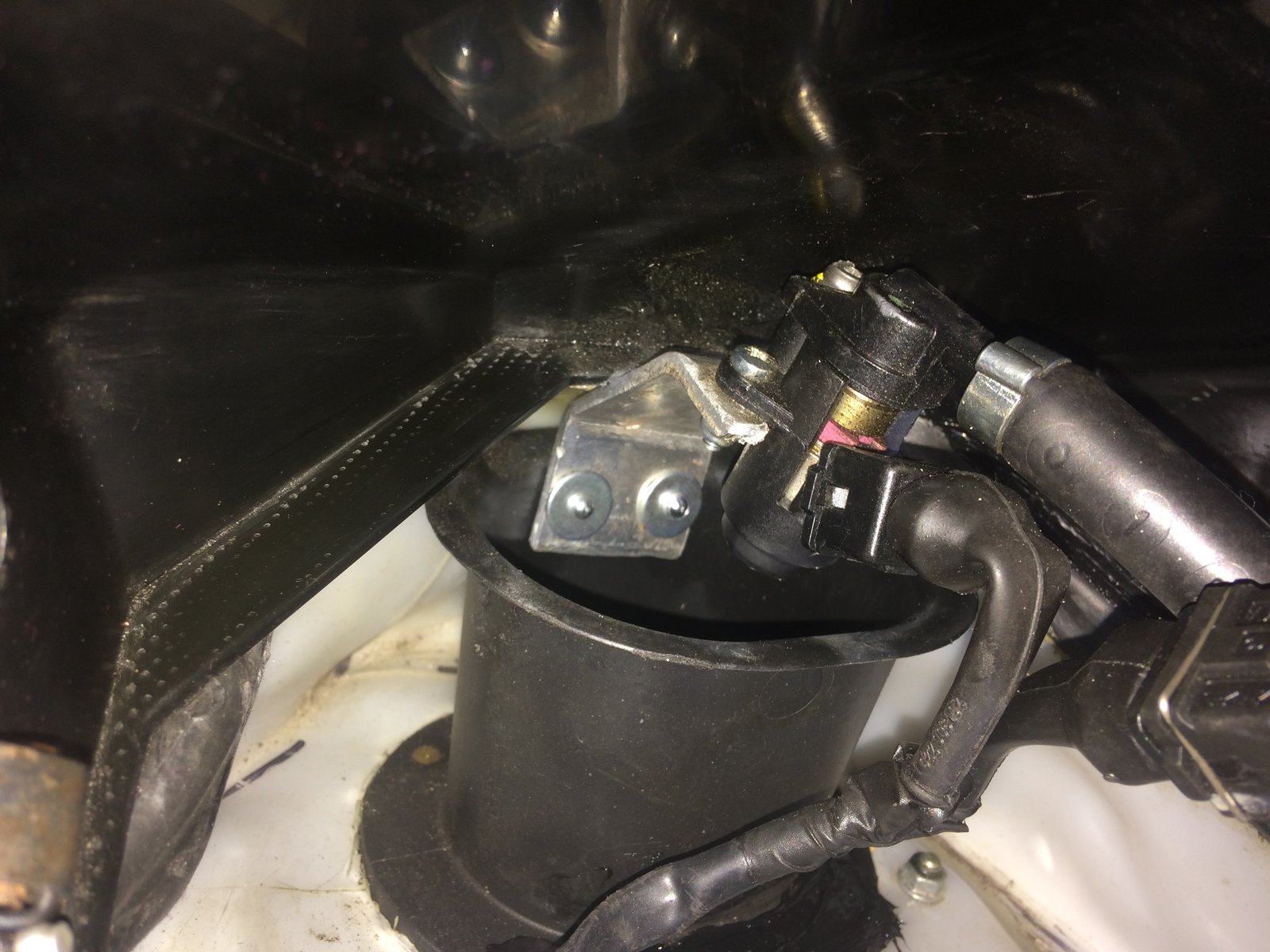

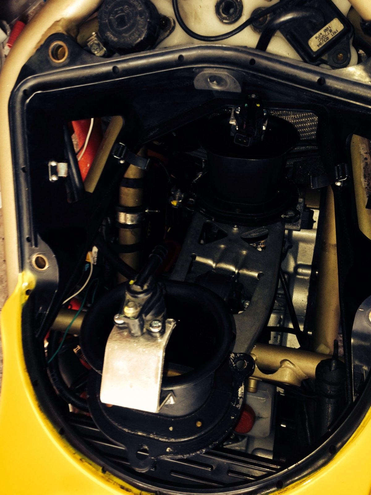

  15. 644B230B-EC1E-4CFA-AE78-079548EA9490.jpeg 6792505B-861D-446C-B507-6DB46C7AFF59.jpeg EB089181-24F1-46AC-8748-D07AA4B45087.jpeg BA613020-A4CD-4504-A15D-45F0E09F6006.jpeg 36D7F066-0066-4489-92E3-419DDFADE94F.jpeg Airbox and PC loom, PC in seat cowl, Injector mounts on velocity stacks and clocks.

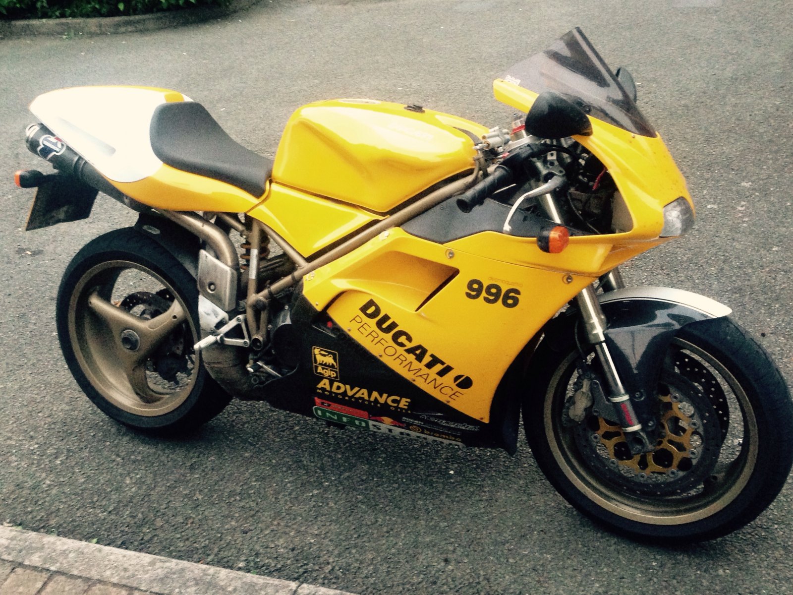

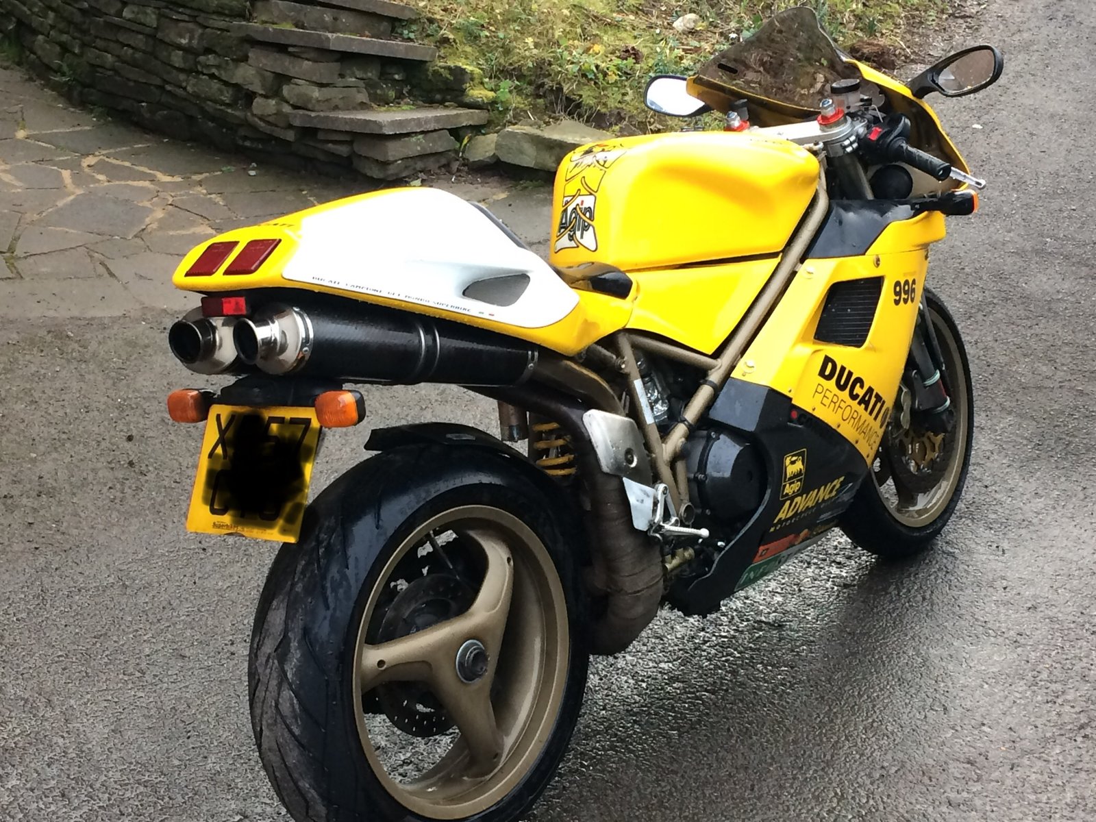

  16. Some nasty bastard has spray painted your number plate, ;) Otherwise looking good!
  17. Green and black! Very nice indeed.
  18. Looking good. Is the airbox base fixed to just the bellmouths? Orfixed thru the ellmouths to the throttle bodies. My conversion the bell mouths arn't fixed to anything, they are are loose and just sandwich between airbox and throttle bodies.
    My 996/1098
  19. Yellow??
  20. Airbox is bolted around the velocity stacks onto baseplate. Kept hole for crank breather. If you look, you can see the bolts securing it down(locktited on). I folded the plastic and melted it together with a heat gun(thermosoftning plastic 3mm). Then trimmed it and put a rubber seal on the top. It lines up with the 998 airbox with the bottom prised off to give a flat surface.
