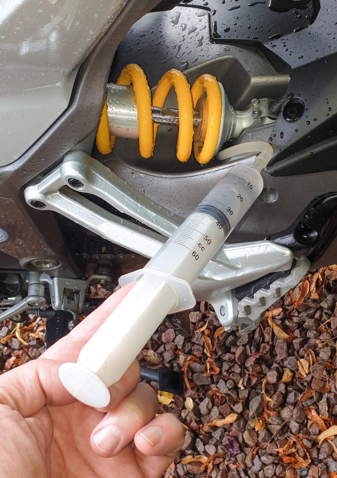

  2. Agree that's certainly the easiest way to unblock it, just a shame it gets blocked up again so quickly :(. I use a pet hair dryer to blast out the excess water and dry the area after washing, then spray with some ACF50, hopefully will help prevent corrosion :thinkingface:.

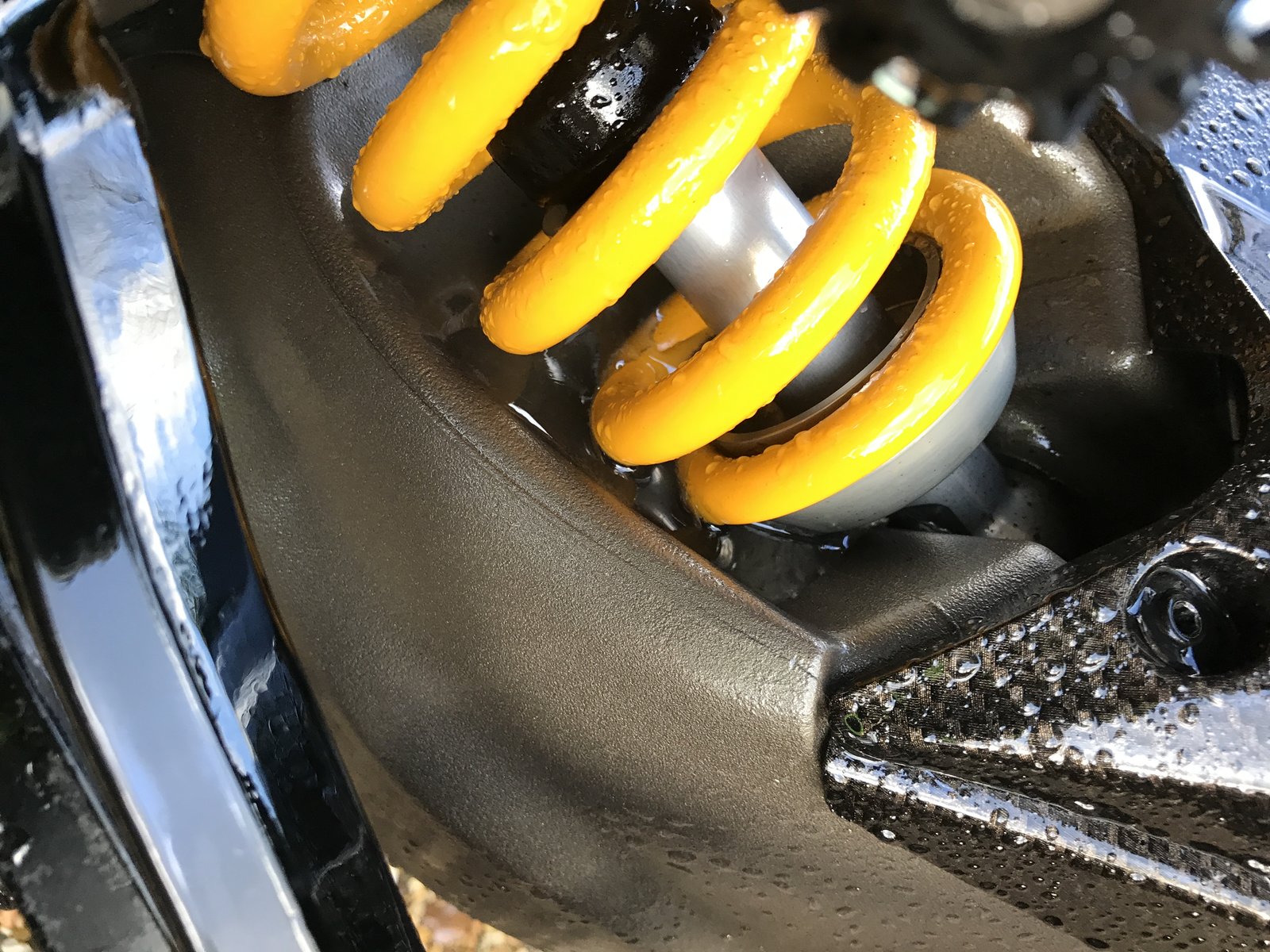

  11. I washed mine yesterday and thought the same, it just collects there with no escape, an old towel does the trick but I have to say that's a poor design.

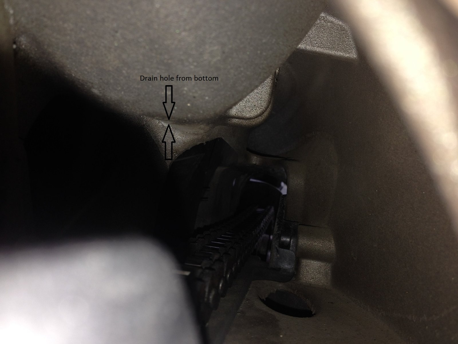

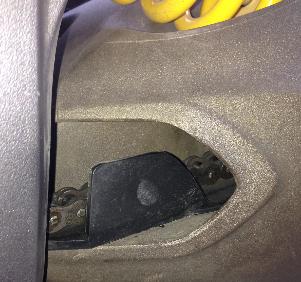

  12. There is a drain hole that gets clogged / blocked by chain lubricant it is above the top run of the chain and the Swing arm, link on here somewhere with pictures. A stiff brush can work or a bent wire coat hanger will open up the hole from underneath. access is via the cut out on the swing arm behind the frame.
    Yes the hole should be bigger so it doesn't block!
  13. Check the hole is there in the first place!

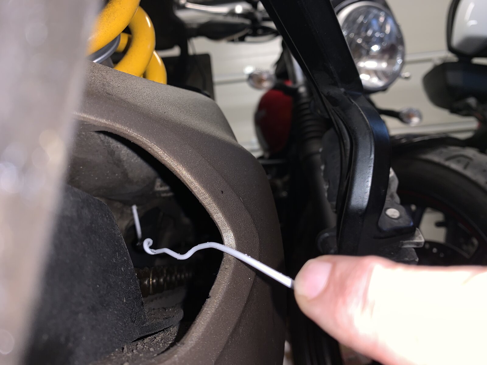

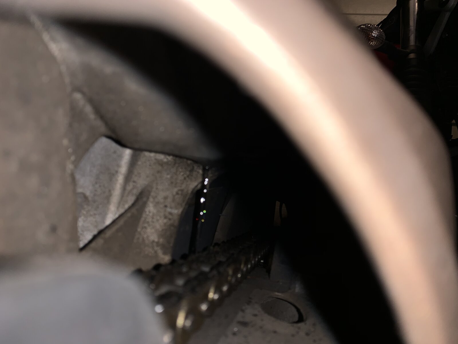

  14. Would never have found it without your diagram and still found it illusive. Nearly decided there wasn’t a hole there! It’s near the back of the part of the swing arm you’ve shown. I wire coat hanger did the trick! The first picture shows the water running through once I’d cleared it and the second photo shows me clearing it with the wire coat hanger
