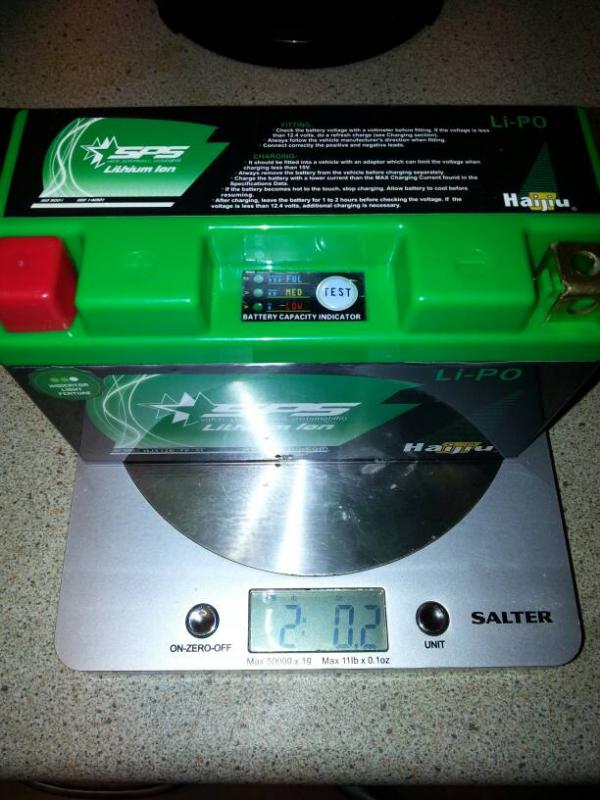

  1. I also have a lithium battery
    2 pound in weight.

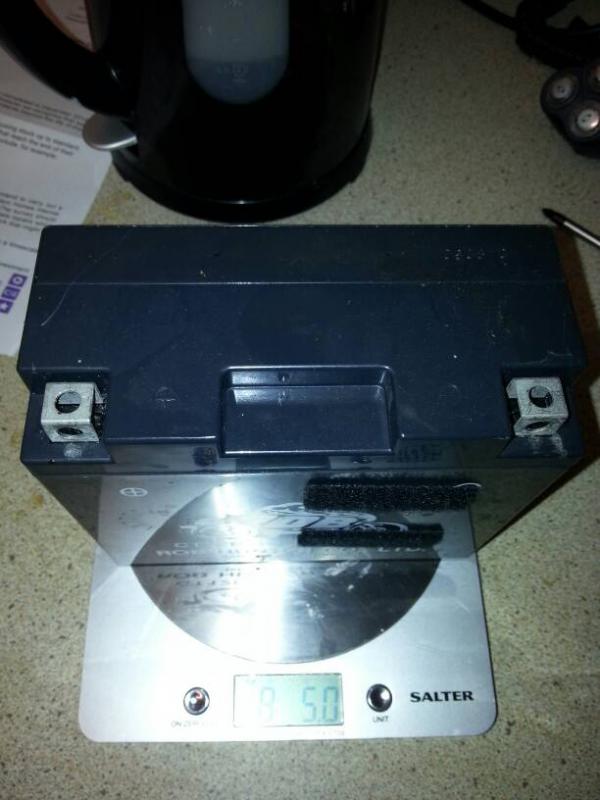

    a massive 6 pound odd lighter.
    I find it cranks it just fine.

  2. LiPo :)
